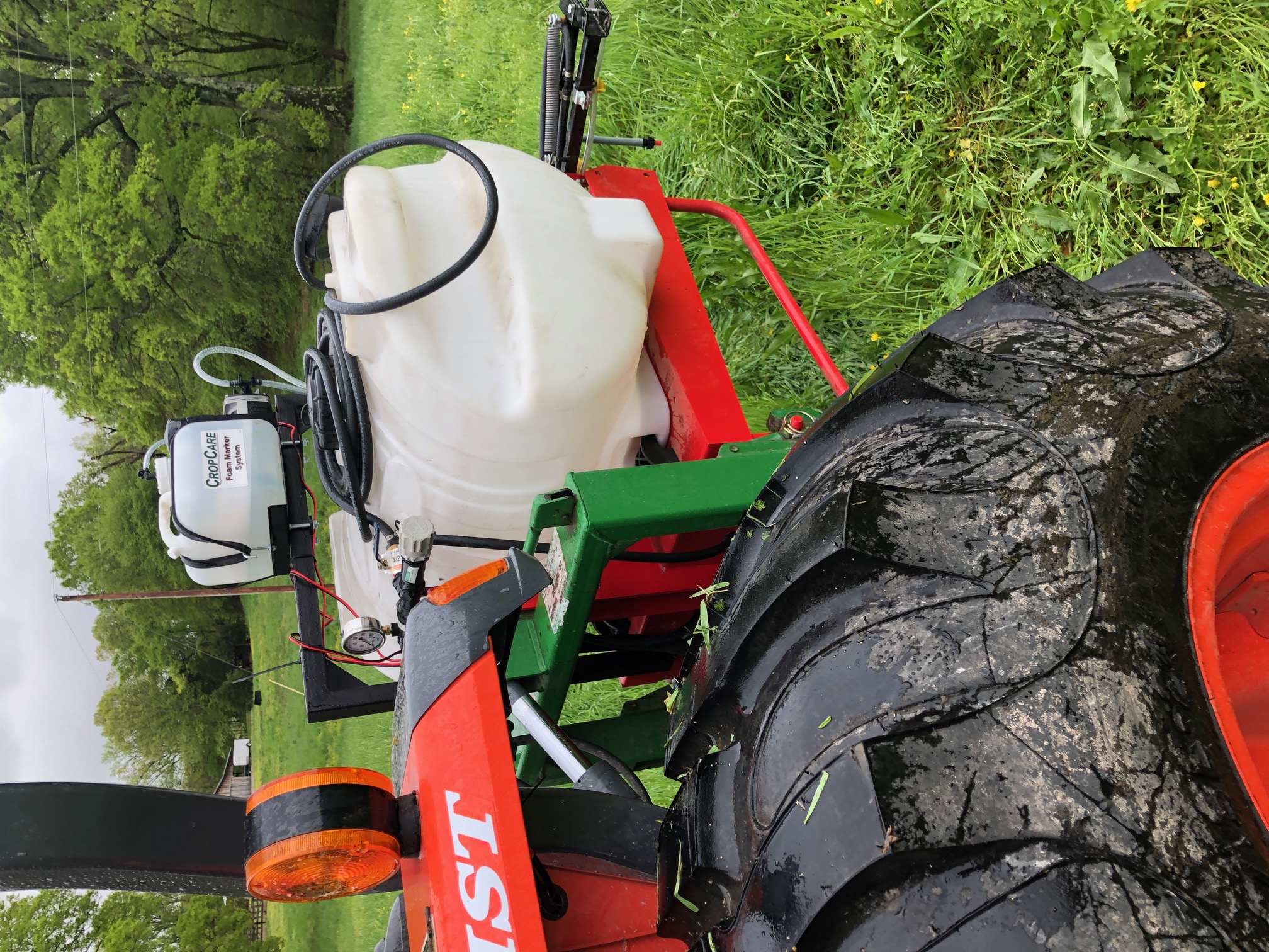

Foam won't hurt your horses. It's just a mild soap / water solution.
I mounted a Crop Care brand 2.5 gallon system to my spray rig (Fimco PTO 12 foot boom / 60 gallon). Sorry this is the only pic I had on my phone. I had a buddy weld up a bracket to mount it on top of the tank.
I have mine calibrated to put out 10 gallons per acre so full load covers 6 acres. I grew up running spray machines back before GPS so I am used to running off the foam markers. Works great spraying pastures.
