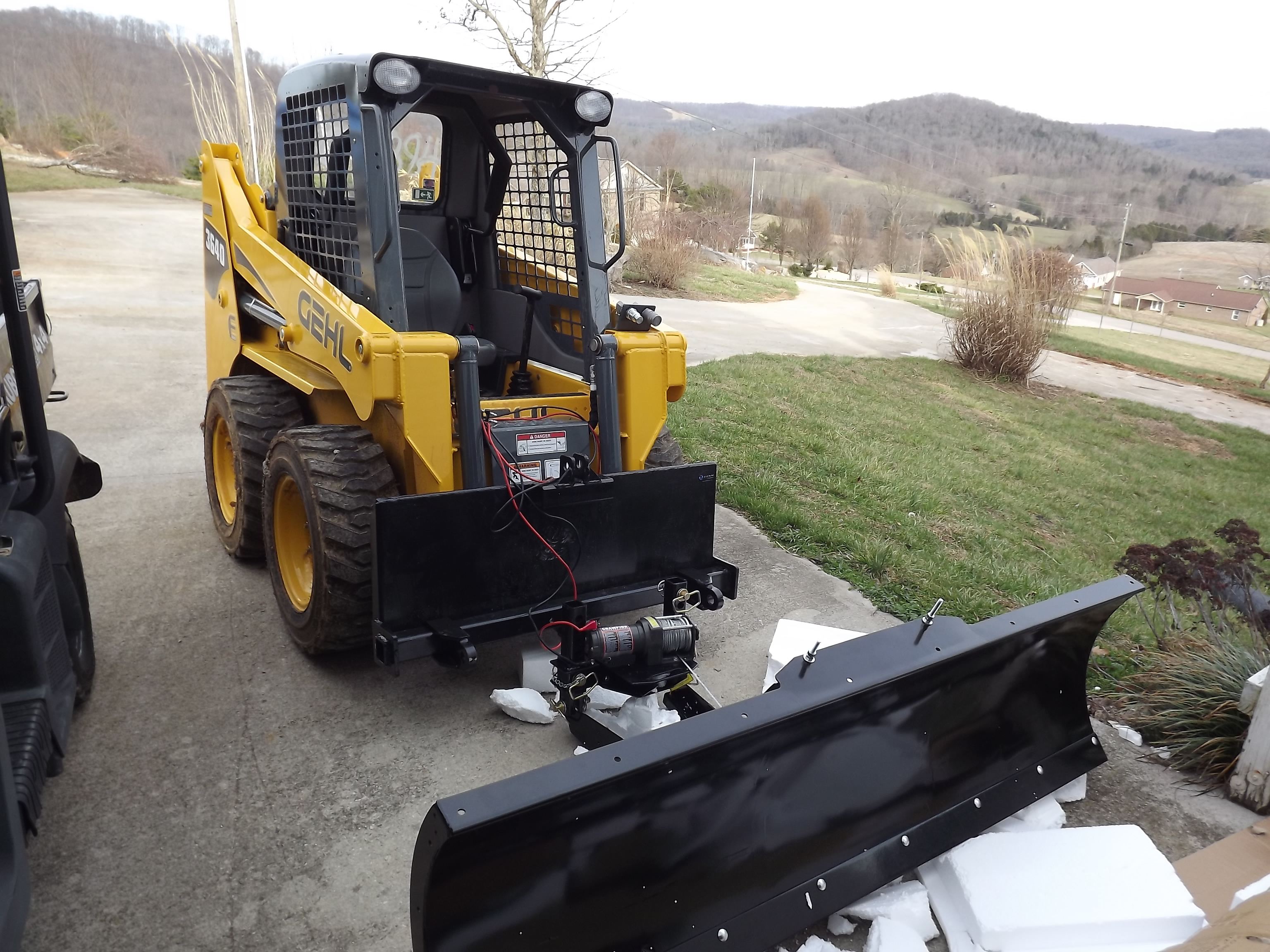

FedEx delivered 3 heavy boxes yesterday morning. Guess I'll need to open them in a few days when it warms up and assemble my plow with it's hitch and see how it fits my 2010 RTV1140CPX..
   / Anyone with actual hands on experience with DR Redi Plow Plus Model? #8
In putting the rubber scraper on the bottom of the blade, using some soapy water for a lube to get it slid in the groove will help. It uses HD screws to secure it after you get it in place.

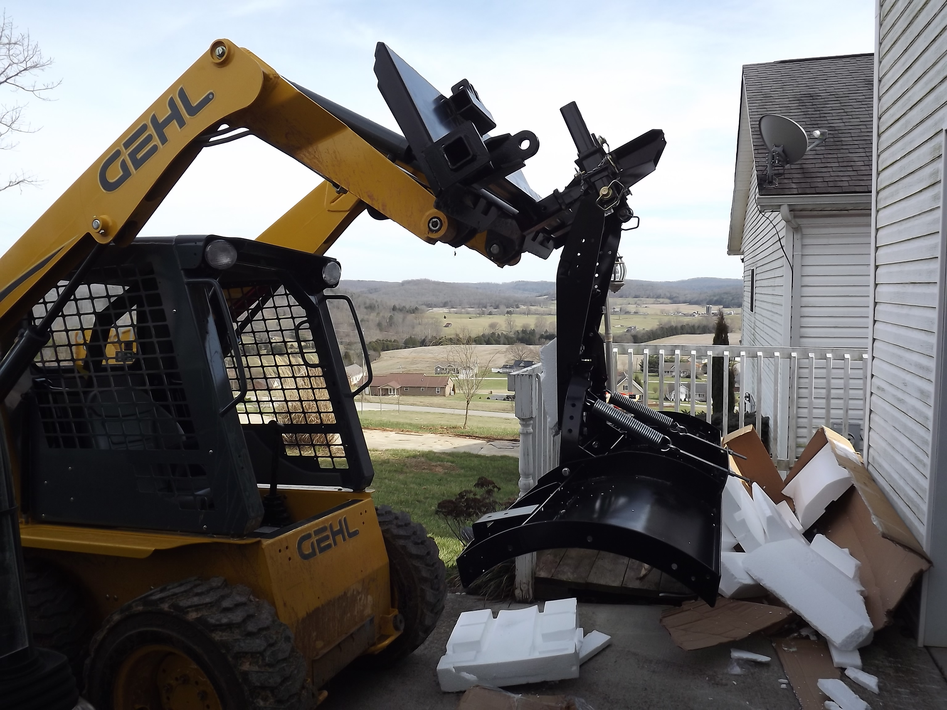

Assembled blade yesterday and attached wench I've had in a box for several years. The snow blade will work on my RTV1140CPX and Gehl 3640e Skid Steer.
