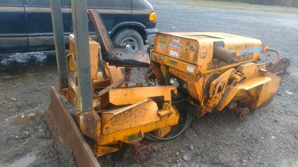

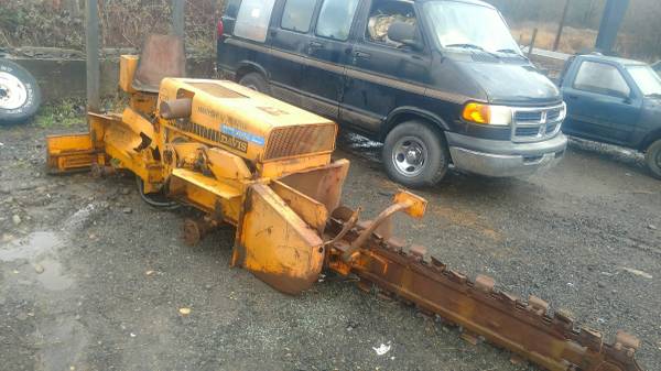

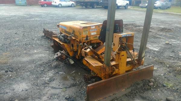

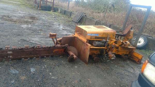

Well, this is the grand stupidity I jumped in on today. $300 off craigslist. Engine is seized and it has been sitting out as parts donor but there is a lot to take off of this machine. The plan is to tear into it, get a handle on what we have and don't have, take the trencher off and make a rig for my PT. Gonna be interesting if nothing else.

Neat find. How large is that trencher? Looks huge.
