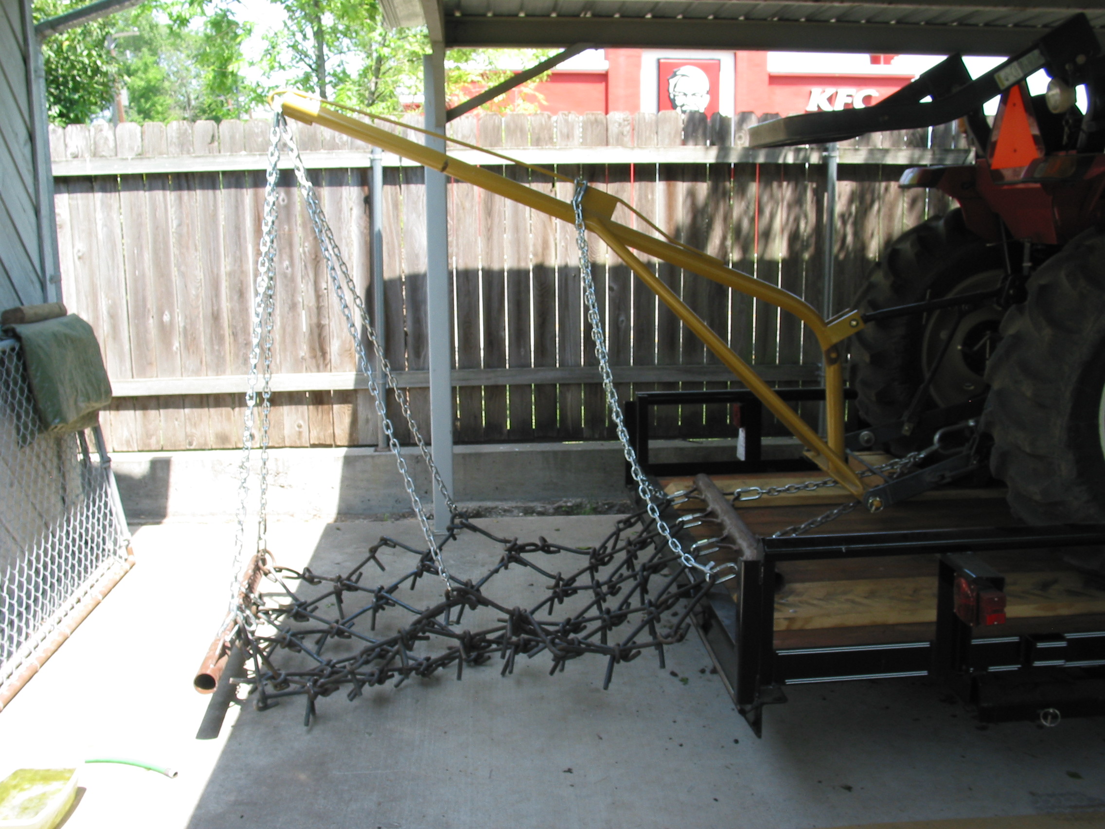

I've thought of using a boom pole to pick up a chain harrow to move it around. You would have to build a frame to hang the chain harrows from, and then suspend the chain harrow from the frame. After that, just rig up a way to suspend the harrow frame from the boom pole. I would think that a drag harrow could be rigged up in the same manner.

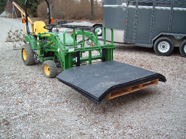

Here are two pictures of an 8' harrow I made a couple of years ago. Built it for about $250 and I Match compatible.
   / Anyone with a drag harrow lift? #4
Not a great picture, but sort of gives you an idea of what it looks like. Works just fine.

I use mine all the time to maintain a long caliche driveway. I leave the boom pole on the tractor most of the time. Just back over the harrow, hook the chains, raise it up and take off (less than 1 minute to hook up). To cut the chain lengths, I lowered the boom all the way, then measured and added about 1 ft on each chain to allow some slack when the harrow was on he ground. These heavy chain harrows will do surprising nice work.
