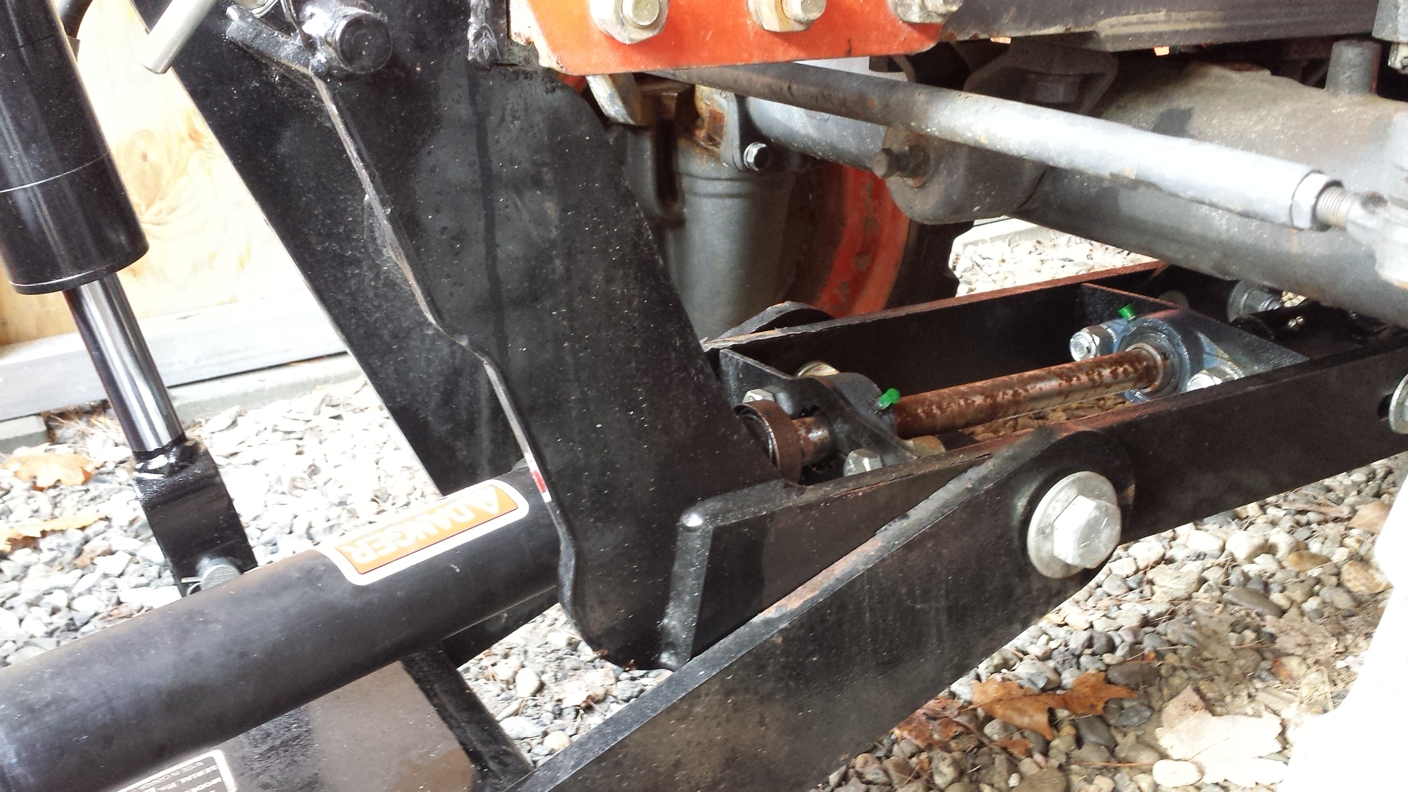

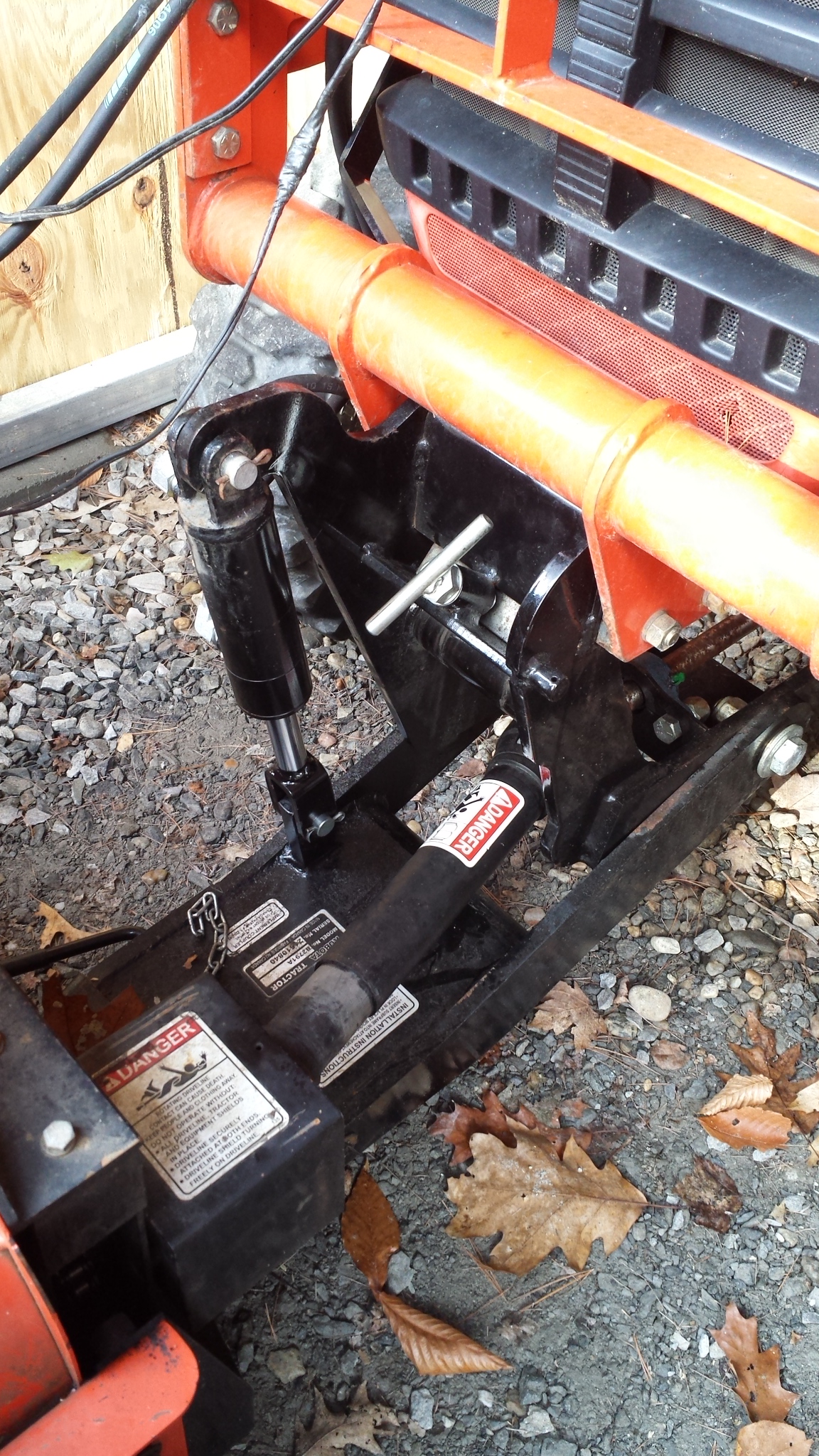

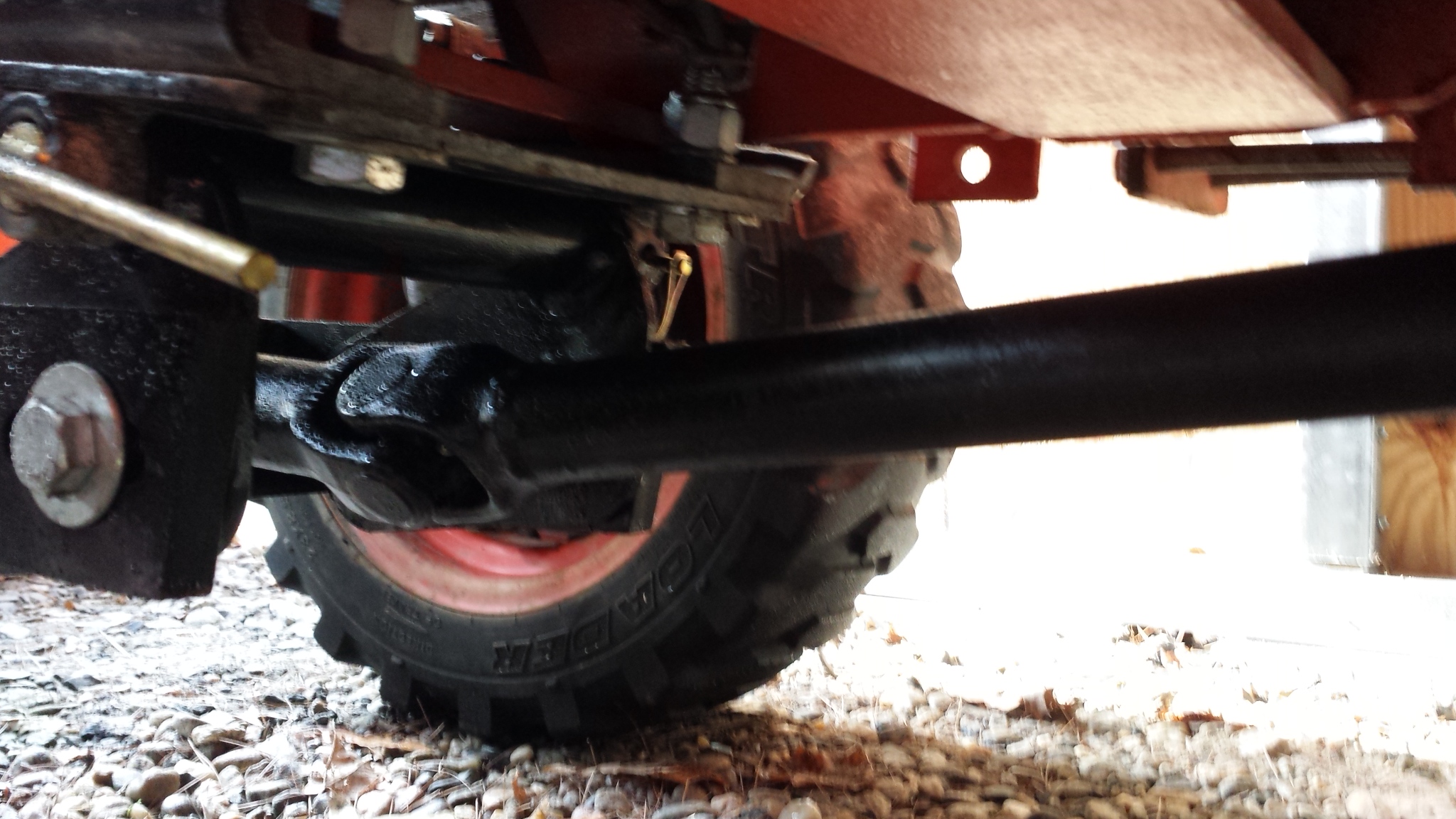

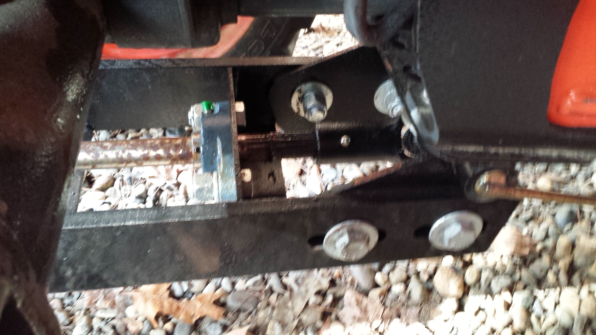

I am underway with a project and am in need of a mid PTO shaft. Even with a part number (70060-04541) for the driveshaft, two different dealers I called are unable to give me any specifics. So it's time to turn to the community.
Specifically, I'm trying to determine the overall length (end-end) as well as type of coupler at the implement end. I know Kubota B-series run a unique/proprietary 10-spline mid-PTO, but I need to know what kind of shaft this driveline mates to at the implement end. Many thanks!

I have a B2782 front mounted snowblower. The mid PTO shaft does not connect directly to the snowblower. It connects to the subframe which has a driveshaft mounted between two bearings. On the front of that shaft is the connecting piece that attaches to the snowblower. I do not know if you still need this information so I am posting what I have on my B2710 tractor. If you need more details (i.e. pictures) I can try to get some tomorrow and load them here.

I'm fabricating a sub fram to put a G2546B blower on my B7200. If you could post a view or two of your subframe, They might aid in the process.

Here are the photos of my snowblower subframe.
