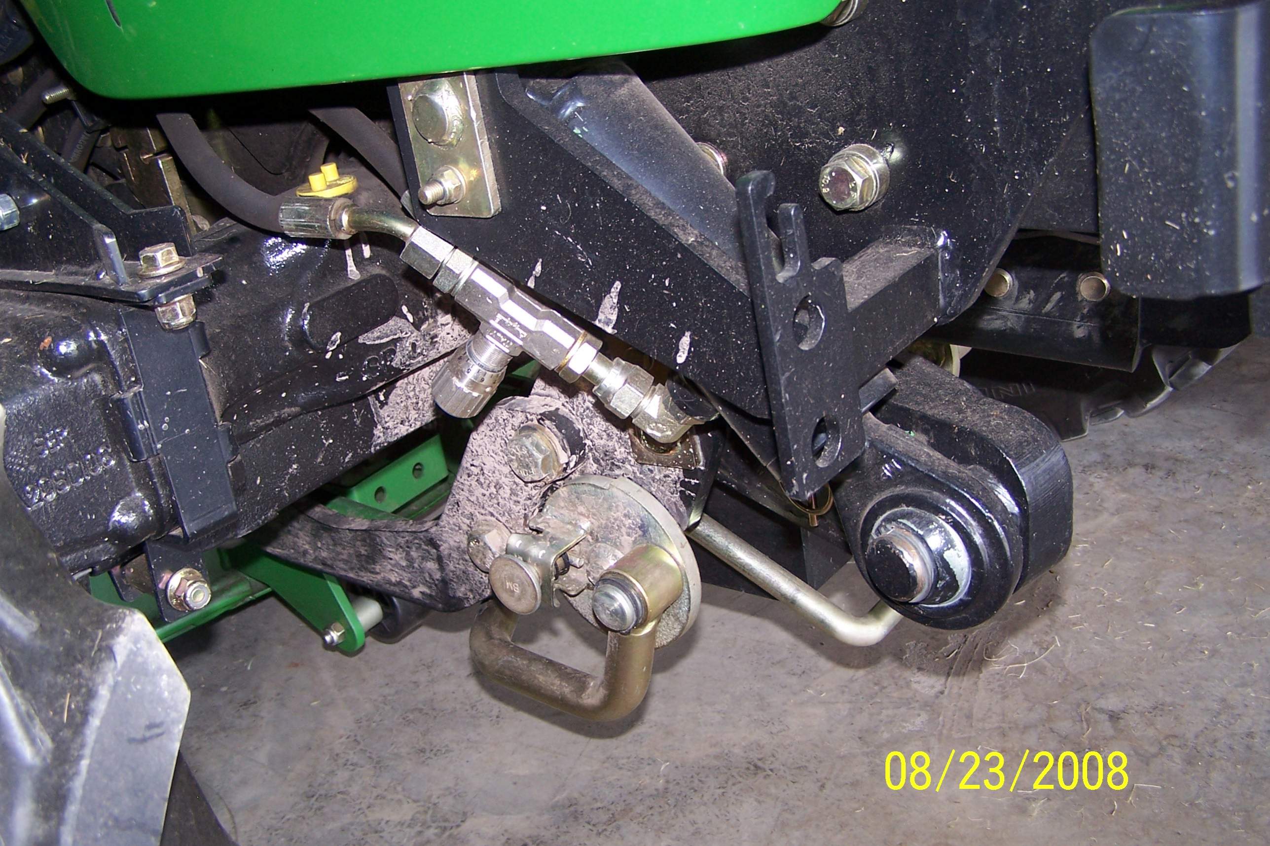

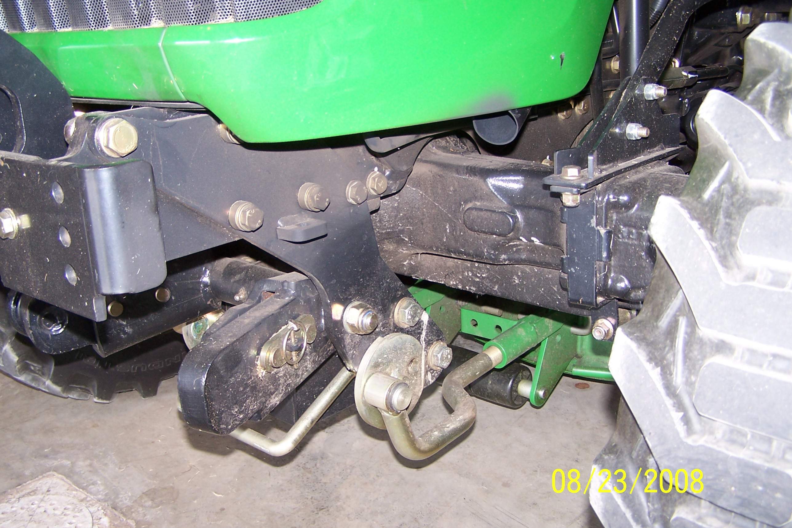

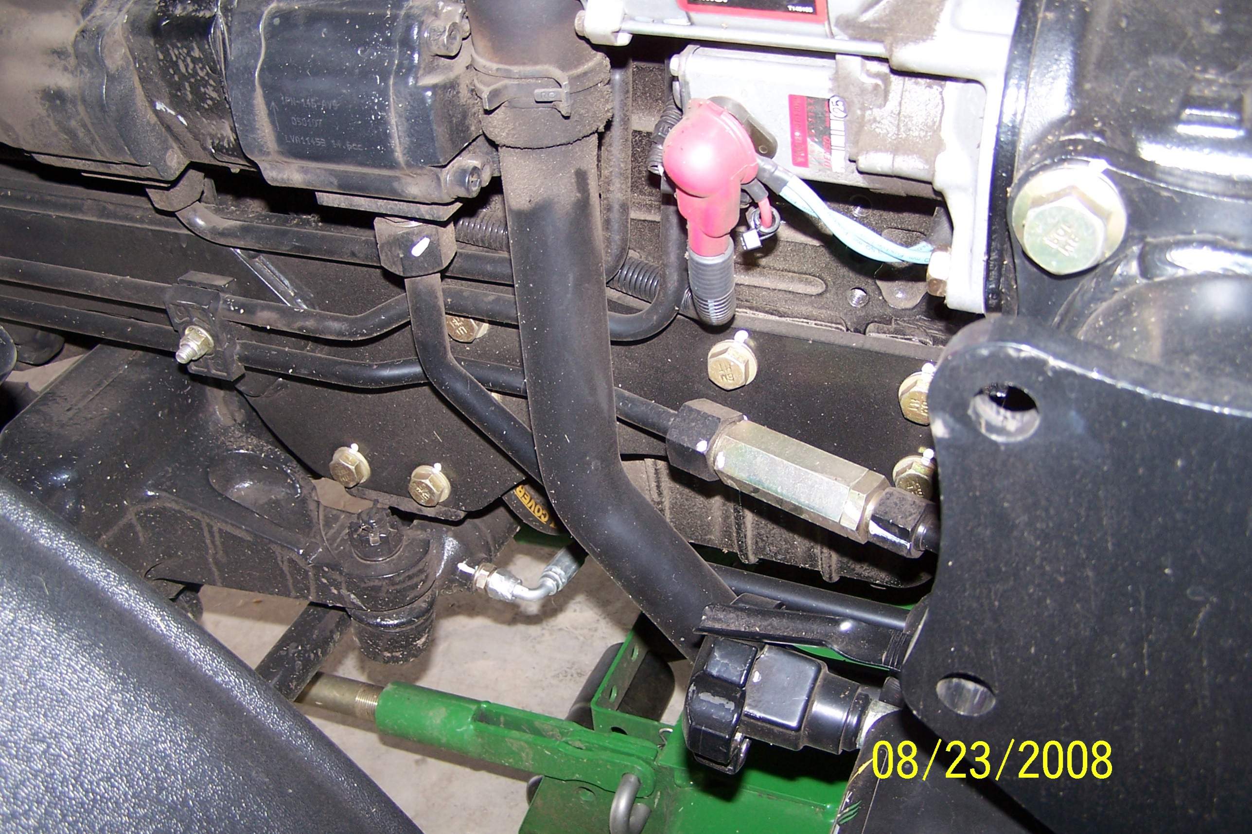

I have a 3720 and have been using an 84" RFM since last fall. Due to this I haven't used my 72" 7 iron MMM since early last fall. the dealer installed my front hitch/lift and front PTO for my 59" snowblower. I took the blower and arms off, etc. early last spring. I went to mount my MMM today (I wanted to bag and use the cyclone rake) and the first swearing event was realizing It seemed I had to remove the Front PTO shaft bearings. 4 about 25mm bolts in a hard to get spot that was probably tightened by a torque wrench. Anyway, I get that off, I do all the other pain in the butt stuff for the MMM and the front hanger seems like it's about 5" back from where it needs to be so I can put the hanger bracket in it? I don't have the front pto/hitch manual (Dealer never gave it to me). I looked at my MMM install/parts list and the hanger bracket does not look like what's on there now.
Does anyone have a 3020 series with a MMM and a snowblower? Am I just cracking up or is there a bracket or adapter I'm missing?

I have a 3720 cab tractor with 72" 7 Iron mmm and 59" front mount snow blower. I use it primarily for mowing 6 acres of lawn in summer and clearing snow from approx 2000 ft driveway in winter. I have never removed the front attach mechanism for the front hitch. For the summer, I remove only the hitch itself (3 or 4 pins if I recall) along with blower and drive shaft -- no wrenching involved.
I'll take a look at mine tomorrow (tractor is in barn) and see if I can be of any help. Will also check to see if I have the manual for hitch and drive shaft.

Actually, is there any chance you can take a picture of your front hanger bracket? If so that would be great.

I have the manuals for Front Hitch, Front PTO Kit, and Mid-Mount Mower which may be helpful. The english portion of the Front Hitch manual is only 11 pages -- could try to scan & email to you or make hardcopy and send to you. Let me know what you'd like.
Will also take a picture.

I think a picture would be great. That would let me know if I have a different hanger bracket or the same one you have.

My first try at posting pictures, thanks to Nuru for info.
Since my tractor has front fenders, I have 4 or 5 pictures at different angles because fenders prevented good shots.
