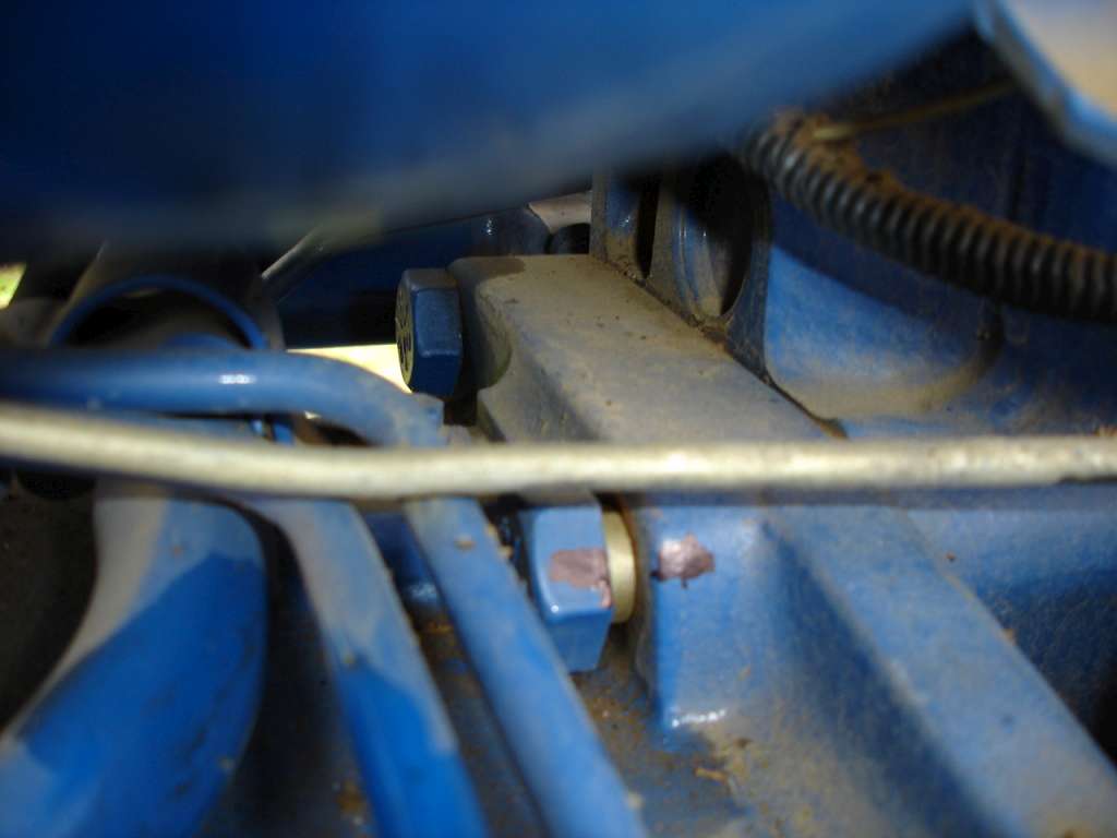

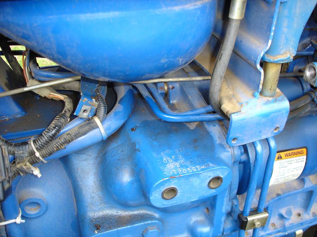

Can anyone with a 665 check the top of the clutch housing? Looks like a 3/4" bolt is backing out on me, but I can't get a wrench in there to know for sure if it's loose. Will require some line removal to get a wrench on it.
Thanks!
   / Anyone with 665? #2
i looked at one of my 675's today. Looks to be the same as your 665. Bolt that holds the transmission to the engine. Yep yours is loose. I would have to take my fuel tank to get to mine. My tank is plastic though.
   / Anyone with 665?
Thanks very much for looking at yours. I was pretty sure it's loose and yes, I think I'll have to remove the tank on mine to get to it. I don't think the factory's torque wrench was working the day they assembled this tractor. I've had to tighten several bolts on this tractor. I've had to tighten the weight bracket bolts, the allen bolts that hold the three-point lift arms bracket on the bottom of the tractor and the bolts holding the cover for the 4 wheel drive shaft.
