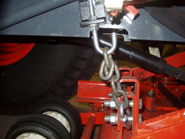

I noticed in your pictures that the tracks from the center two wheels on your 60" deck are visible. I posted last fall that I eliminated those tracks by removing the rear wheels and holding the rear of the mower up with chains and hooks on the frame of my B3030. I don't know if you could do that on your tractor. I like it a lot better than the way the mower is mounted stock. It was easy to do and by removing the center wheels the mower is even easier to mount and dismount. It even does a better, more level job of mowing, IMHO, because the mower is rolling on the larger wheels of the tractor rather the small wheels on the mower. My lawn is not perfectly smooth so I can now travel faster without having the mower bouncing up and down as much. The front wheels still contact the ground and carry most of the weight of the front and allow the front of the mower to follow the ground contour. I don't have any problems with scalping, either. The picture is of the right side hook and chain before I took the wheels off. Until I was sure I liked this setup I just raised the wheels to their highest position where they did not touch the ground.

Thanks for the deck suspension idea. Last summer my friend bought a new B7610 and at that time I was contemplating selling him my 60" deck just because I wanted a suspended deck instead of a ground contact deck. The 54" available with the B Series is a suspended type. Then, at the last minute, I found out that the 54" was not compatible with the bar turf tires I have. Kubota said it was only compatible with the standard turf tires. If I recall, the Turf Special has the 54" deck. I have kicked around the thought of making my 60" a suspended type deck, and now that you have done the work, I am going to make it my next weekend project. Thanks! What are the grey brackets you have the chains hooked to on the tractor?

The brackets are just some pieces of 1.5" X 1.5" X 3/16" angle iron. The holes in the frame that they are bolted to were already there. I trimmed off some of the part that the hook goes through. Here is the left side.
