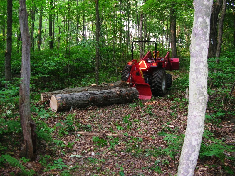

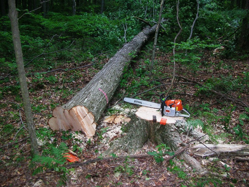

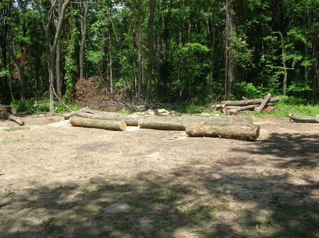

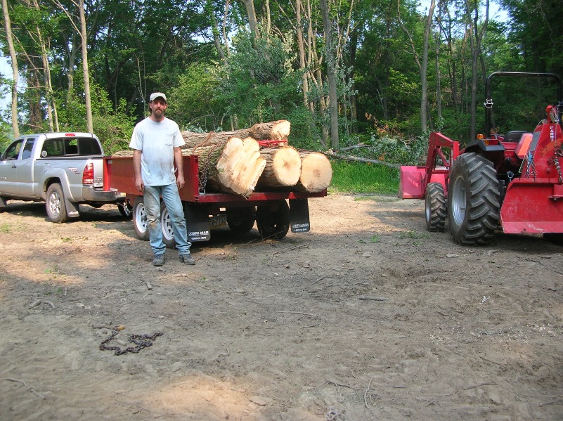

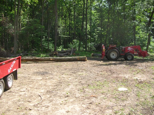

I'd think you're tractor would do just fine with a farmi. I've got the same one you're looking at 351P. I don't have any pictures of it in action. But with my tractor I can pull and drag out 40'+ logs having a base diameter of 25" or more. If you can't pull the size you've cut, just cut it a little smaller. I can't imagine cutting some of the trees I cut with out using the winch-200'+ cable really comes in handi.
Here's some photo's of logs I've skidded out.
