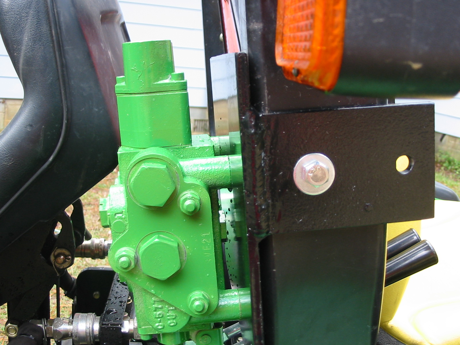

   / anyone use a cylinder for a top-link ? #7
Working on one. Since the pictures I have added all the fittings to the valve, and two days ago ordered a cylinder and more fittings from Surplus Center. (They are down online for a few days as they upgrade their website).
When I am done (soon after Christmas) I will post more pictures. Eventually I will add a tilt also.
