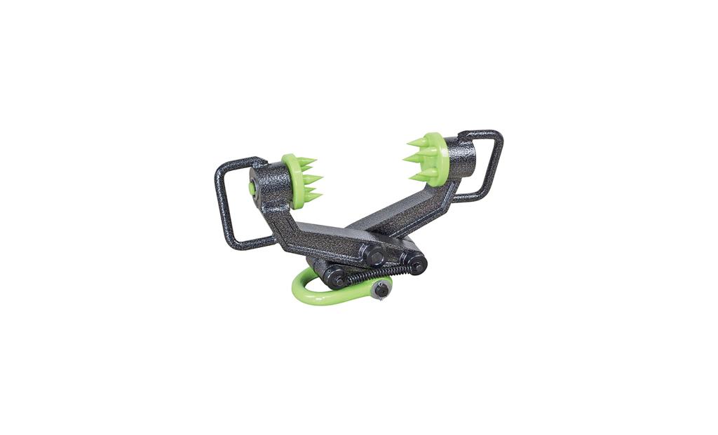

I got the Brush Grubber Xtreme Plus, Model# BG-20. Notice "Plus" and model# BG-20 From Northern last week, but haven't used it yet. It is the biggest one that Brushgrubber makes. Local store, not in stock, so ordered it online. It weighs 35 pounds!
This picture is confusing, the spring holds it closed, you have to pull it open to use it. The spring makes it stay where you put it.

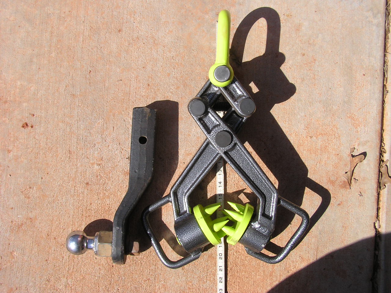

Here is a picture of mine. It is the largest one they sell. I used it some last summer to pull out some stumps and skid around some logs. It's a great tool. I will say that it is heavy and tough on the arms after awhile. I put my hitch next to it so you'll have some comparison in size.
