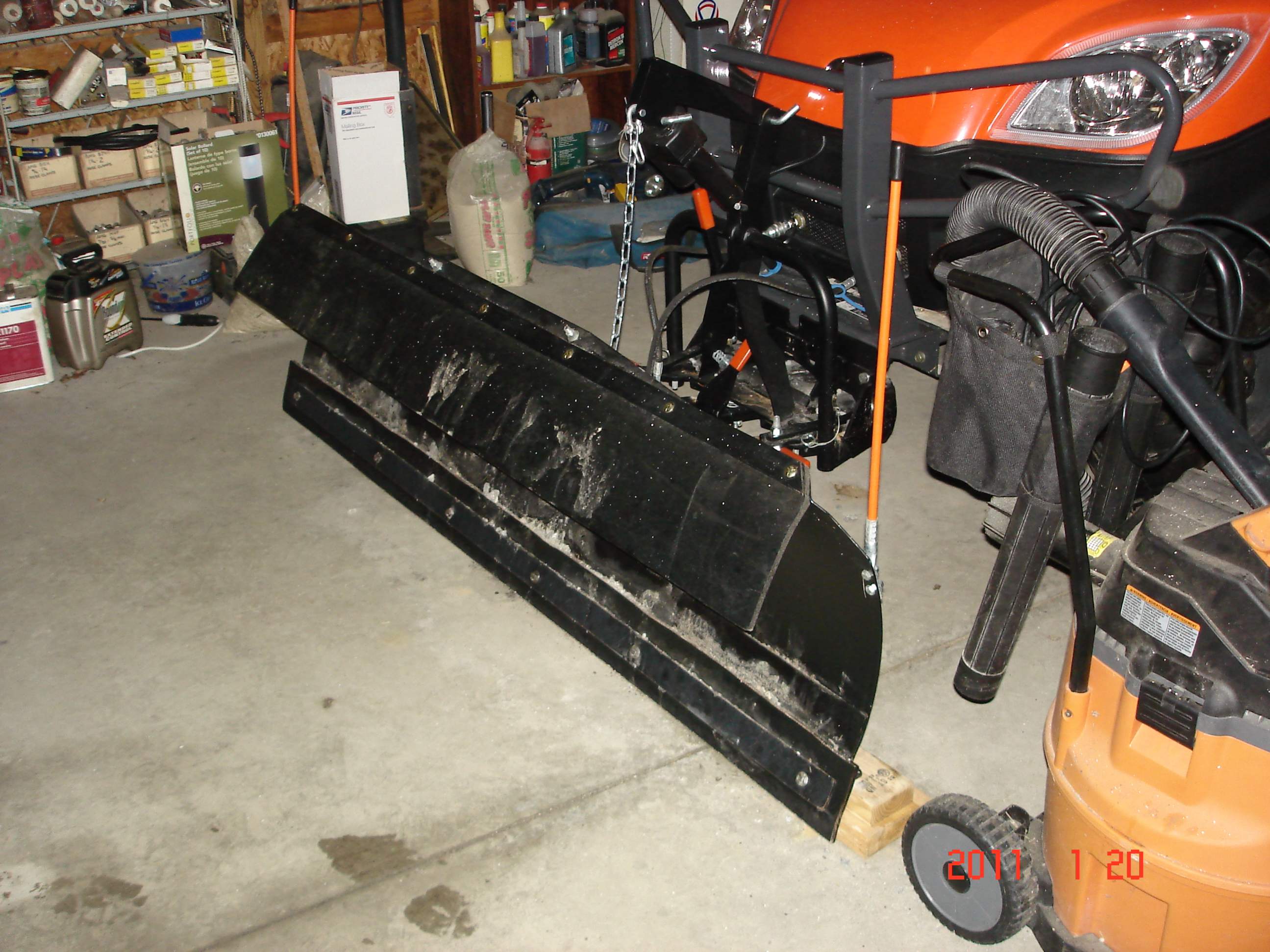

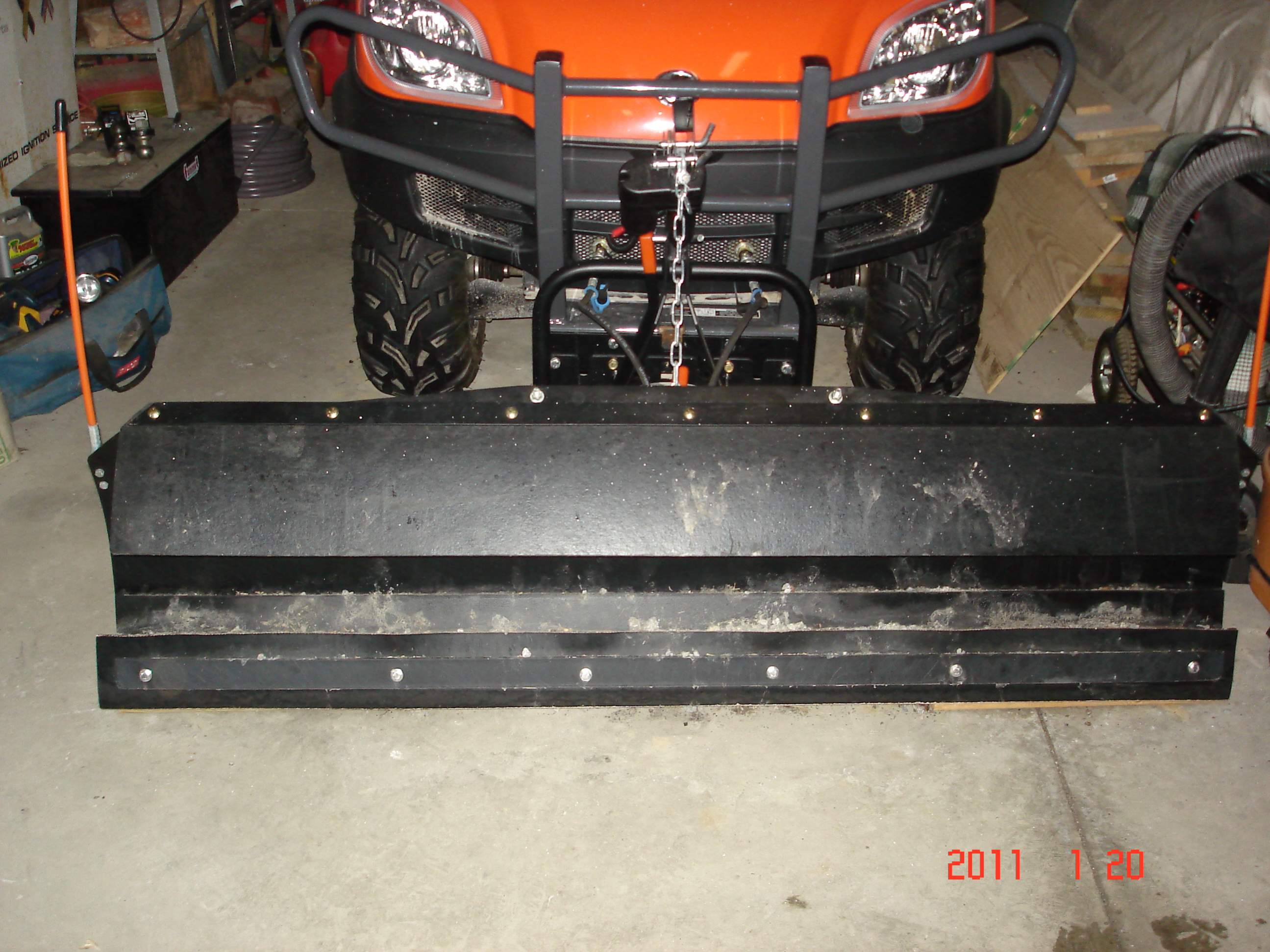

I have a RTV 1100 with a Boss plow. I put a strip of rubber horse stall mat on the cutting edge and it works great on both the gravel and the blacktop.
Much as timswi said. Doesn't disturb the gravel very much and doesn't leave a mark on the blacktop.

Here's what my setup looks like

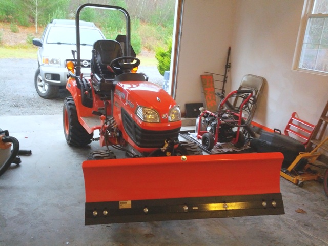

Put a poly edge on the blade:

That's a far more substantial poly blade than I've tried in the past...Where did you get it and how does it hold up on frozen gravel?
It's a Kubota blade and poly edge, new this winter season but have done quite a bit of plowing with it thus far. I have a 2600 ft mostly gravel drive and the poly seems to be holding up well. We also plow around several horse paddocks and a few trail pathways. The picture makes the blade look bigger than it is (60").
   / Anyone try one of those aluminum snow push front blades? #10
Where did you get the poly edge? Was it a Kubota parts item?
