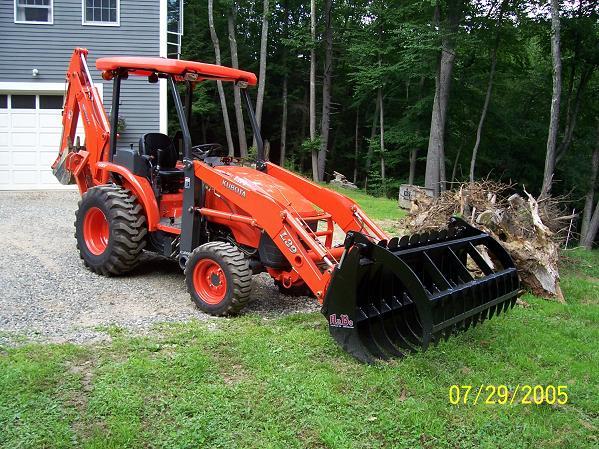

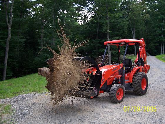

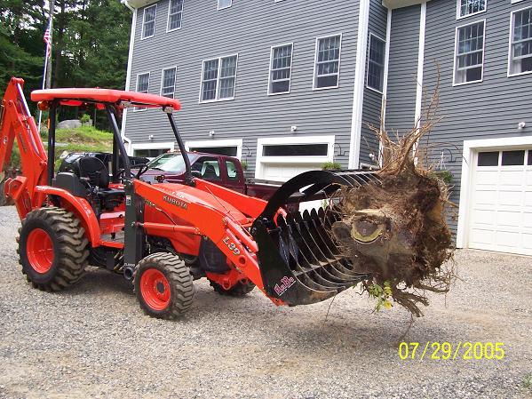

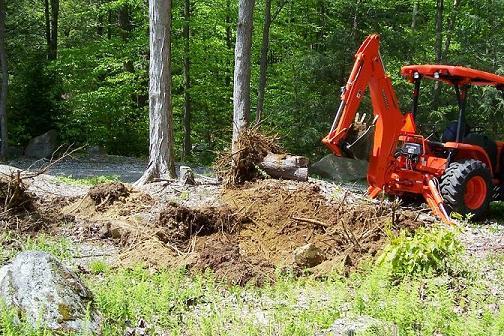

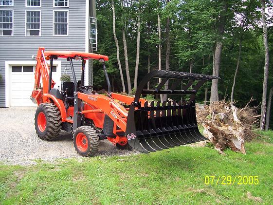

I am not sure if you are asking about removing the tree, roots & all in one shot, or dropping the trees and digging out the stumps.
I have removed 50-60 tree stumps, after felling the trees, while making a lawn around my house, from 4" to 36" with my L-39. If you have read any of the past posts on this topic, all seem to agree that the larger the stump, the more digging around the tree is needed to break the root ball free. I also found that during a dry spell, the digging & removal of the stump is more difficult (summer) than when the ground is wet (spring). The back hoe is strong enough to lift the front of the L-39 off the ground when you hook into something big.
I have limited experience in uprooting the whole tree, due to the rocky soil conditions I work in. However, I have a 6' ANBO grapple that I have used to rip & pull small brush & trees right out of the ground as needed, shaking and leaving most of the dirt behind.
Hope this can help you out.

Walt, Did you get your Anbo from a local dealer? I sure like the looks of those rakes but I have a smaller machine and would kind of like to see one of the smaller grapple rakes in person before buying one. Thanks.

Reg:
Seeing that you may live near me, P/M me if you would like to view mine.
I learned about ANBO grapples from this site, then when to their site to learn more. I called them, was sold on the product and ordered mine over the phone. They shipped it to my Kubota Dealer, who also installed the W.R. Long Aux. Loader valve/joystick kit. The cost in June 2005 was $3420.00 including shipping from Washington state. I believe they build to order vs. having products made for sale.
The only grapples I saw in person at area dealers were Bradco types. These are the bucket bottom, with the two top clamps. It appears that you must scoop the material into the bucket, then clamp down on it to hold it.
The ANBO is a clamshell design, which functions like your hand, allowing you to pick and place rocks, stumps etc. both vertical and scoop style. It is a more expensive design, but more versatile. The clamshell style also allows you to use as a root rake, collecting roots, limbs, stone, etc. and leaving the dirt behind.
When comparing grapples and their construction, look at the weight, tine spacing, reinforcement style, opening capacity, width, hydraulic set-up and type of steel used.
My loader is set-up with skid steer quick attach, so changing it is a one minute deal. If your loader bucket is pin-on, check to see if a grapple is compatible with your loader.
I have posted here before that this is my "back saver". I no longer need to leave the tractor seat to move the big bulky stuff that makes us all sore at the end of the day.

It takes anywhere from 30 Minutes to +2 hours to dig out a large stump with my L39.
Also It gets real hairy carrying a large rootball in the grapple. That is why I am making wheel weights and under frame weights to get the tractor up to 8000 Lbs.

You are correct in that the L-39 does have it's limitations. A full size excavator it is not. As I had the time needed, I bought my L-39 with the plan of practicing on my yard, before doing work for others. I should have mentioned that I did hire a contractor w/ a 40,000 lb excavator to move numerous "auto" size boulders and to contour the area after I removed the stumps.
Once the largest stumps were out of the ground, I picked at the dirt with the backhoe, knocking off as much as possible. Then I dragged them backwards to my disposal area, as I could not lift them. As with all loader work, being in 4WD is needed as your weight gets transfered to the front axle from the rear axle, when lifting the load. The front axle does the braking (via transmission) and steering as the rear end load is lightened.
