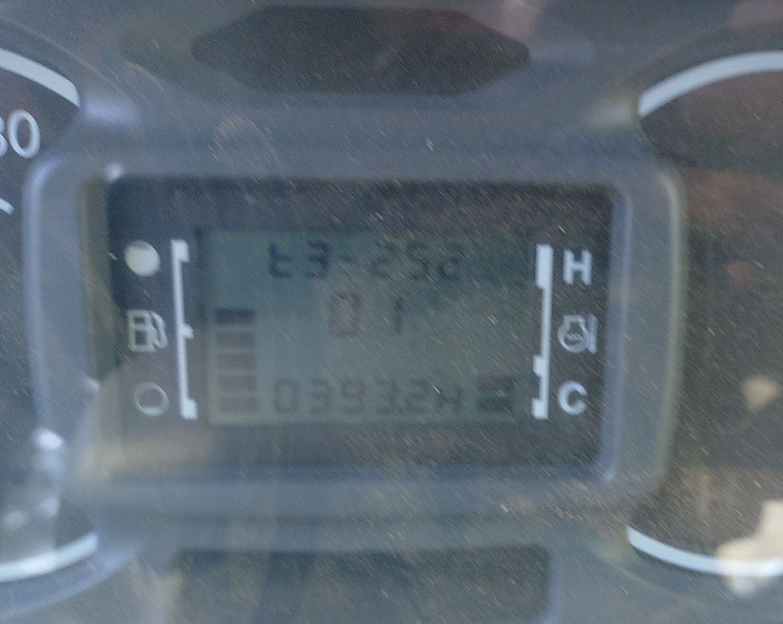

Popped up while I was out in the forest. No luck using google. The red error triangle was flashing also.

I certainly do not recognize the error. Since the red error triangle was blinking I'd get to the bottom of it before using it much. Does it act badly? What symptoms if any? Move OK , run OK? Does the slide shifter transmission and control act normal? Have normal power ? Turbo charger equipped I assume. If turbo problems you would see a loss of power. I assume that dealers have a decoding box to connect to your wiring harness that would explain the error.
I'd check chassis hydraulic oil reservoir fluid first and any other fluids you can. Also if the hydraulic fluid filter gets clogged or unhappy for some reason it will throw a code. With 393 hours on it I'd be surprised if it is serious but stranger things have happened.

Seems to run and move okay. Everything seem to be working. I sort of panicked a bit when it started flashing at me and just parked it. I sort of walked away in disgust after parking it.
I'l do the standard checks on it when I get home.

My 2010 GC2610 had a light or icon highlighted on the dash that had me puzzled. Nothing about it in the manual, si I called the dealer. The dealer didn't know so they called the factory rep. We were told it was for a plugged air filter, but my model didn't support that and he didn't know what would throw that code. I cleaned the air filter and the icon disappeared. Haven't seen it since.

Looks like its something to do with the HST oil sensor.
  • HST Oil Sensor Less Regulated Value.pdf
  • HST Oil Sensor More Regulated Value.pdf
  • T3-252 Error.pdf
