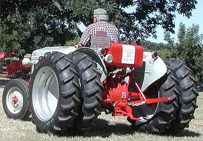

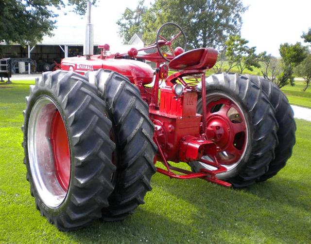

Even old tractors: 8n_dual.jpg Super-MTA-Duals.jpg
