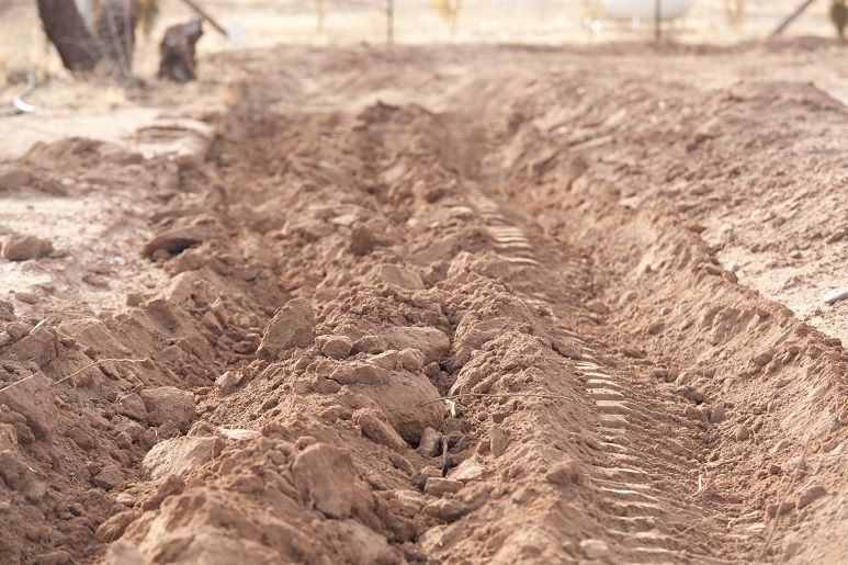

Backstory: So I used my box blade on my BX25 to dig a 5-foot wide shallow trench down the side of my yard to keep the monsoon rains from washing my yard out. Initially I was planning to just put some grass in it, but once I had it dug I thought "why not plant crops in there instead". Problem is that our ground out here is pretty hard packed and full of rocks, so I couldn't just plant stuff and expect any kind of decent results. I've been bugging my wife to let me get a plow but she keeps a tight leash on the discretionary funds these days. So then it hit me: Could I just stick my backhoe scoop down enough to get into the dirt and then drive forward using it like a plow?
Turns out that worked better than I thought. Plowed straight the first pass, then just tilted the bh to the left for another pass, and right for a third. This was the result:
It tore stuff up deeper than it looks in the pic (probably a good 8-10"). I'm sure there's some cautionary guidance against doing this but I figured I have enough power with the scoop to pull the tractor backwards, so at worst if I hit something big it should just stop me and not rip the scoop off. I did get stopped a couple of times, then re-adjusted the scoop, and continued on. Here's a closer pic of the ground after:
It did leave the path quite rugged so I ran it over a couple of times with a walk-behind tiller. It's still not quite right, I'd like to add a bunch of compost to it to get some organics in there but I might just do that after trying it out this year.

I'm no expert but I would be concerned that you could put a lot more force on the unit than it was designed to handle thus putting your dipper and cylinders at risk. I think the weight of the tractor and forward momentum would exceed the break out force that the hoe is rated for which could cause damage. I'm curious to know what some of the experts here think?

From the pictures - it look like you have soft easy soil without too many rocks. Its not the scoop or boom arm I am worried about for you. Its the seals in the ram I that could be ruined since there is no shick protection in those seals. Its easy to replace - but can be time consuming.

rbarker.....I couldn't agree more. This all sounds like a good Idea, but one bad pass where you snag a large rock, or hit something too hard its going to ruin your backhoe. $$$$$$$$$$ at stake if you ask me. I would think it would be much more safe to use the backhoe like its designed to be used and just take your time 6 to 7 feet at a time. I don't believe the Cylinders or dipperstick can handle that much force and if not right away....eventually its going to cause problems. I would also be concerned about snagging a water line, gas line or anything else unexpectedly and causing a lot of damage if you are not absolutely positive where all lines are located. I HAVE seen that happen several times using a backhoe as a plow. Just thought I'd throw my 2 cents in. :smurf::2cents:

No worries about unexpected utilities around here, this area was wide open desert until two years ago. The only thing to worry about here is the septic lines, and those are pretty easy to spot.
I figured it's probably not a good idea but luckily I don't know what it's not supposed to do and I have insurance so I gave it a shot. This may be the only time I ever do that but it's kinda cool to know what's possible.
