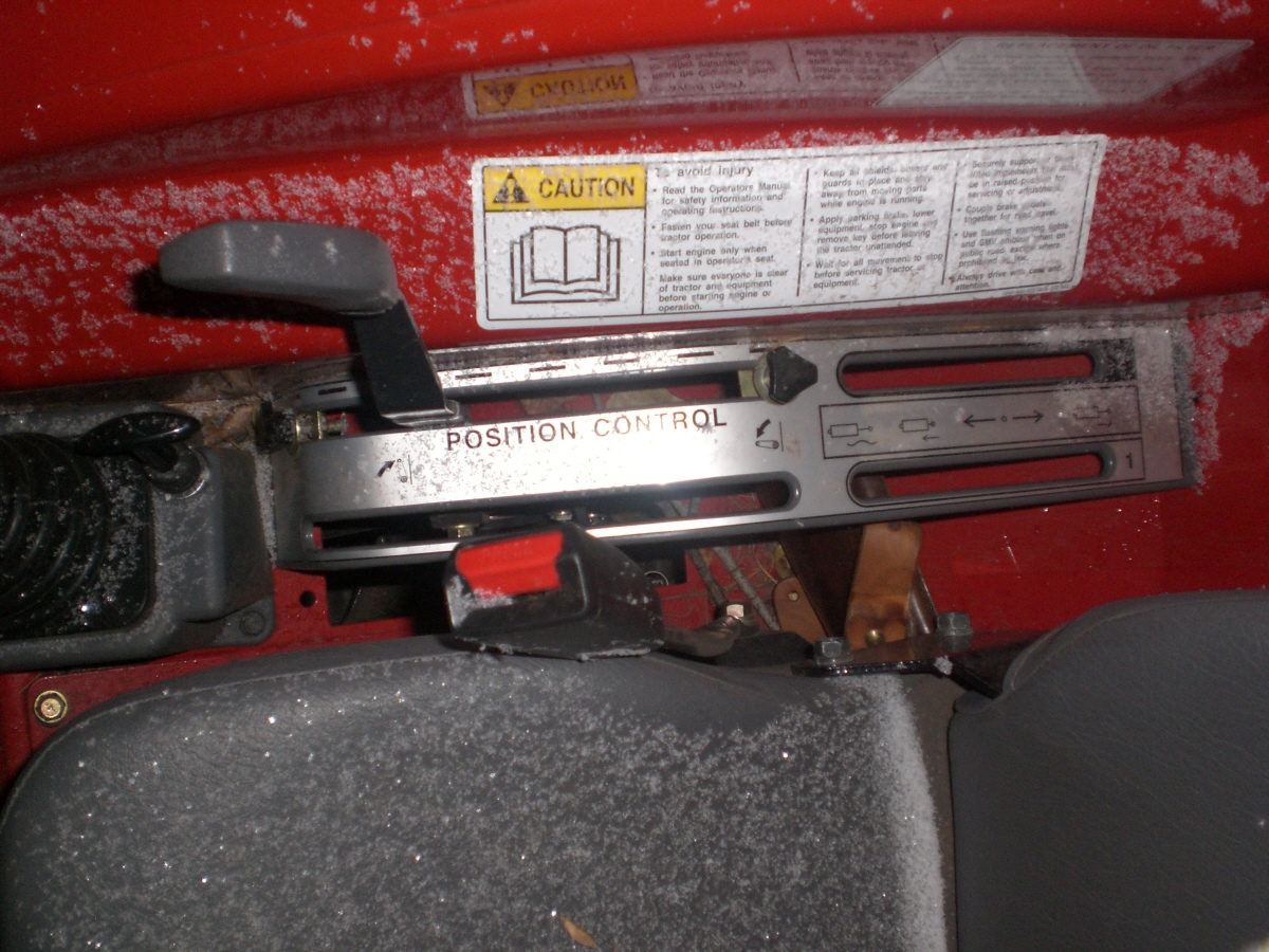

My first issue is I have no operators manual (I am ordering one as soon as possible). In the meantime, I can't understand why my "position control" slot to the right of the operators seat does not move my 3 pt hitch up/down. It only seems to limit the height that it raises/lowers. I also have 2 remotes which is great, but it seems that one of the rear remotes is what makes the 3pt go up and down. Seems kinda screwy.

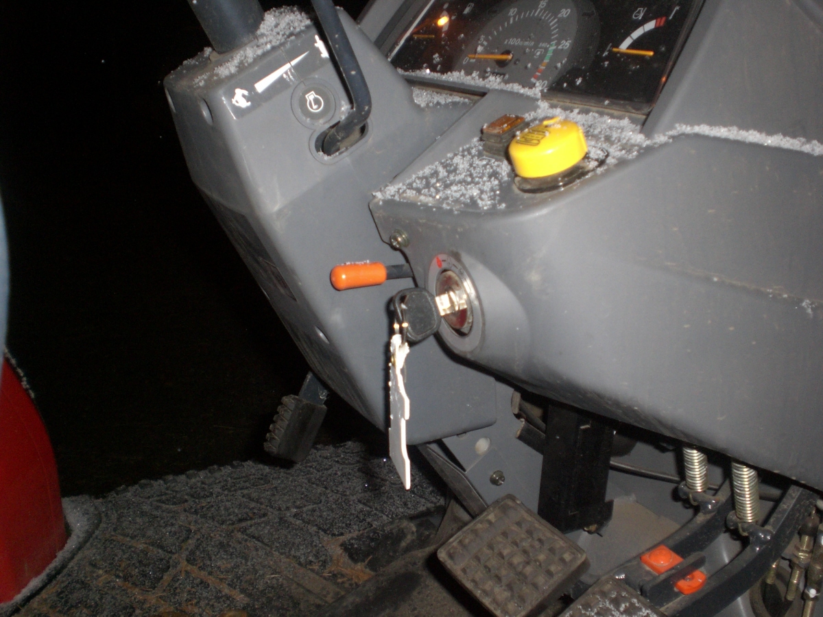

Another peculiarity I see is there's a small lever to the right of the steering column down low. It swings outward but doesn't seem to do anything. Any idea what it does? It almost seems like a tilt steering lever, but that's to the left of the column.

The small lever to the right of the steering wheel column is the parking brake lock/release. Push in the brakes and lock in the lever to activate the parking brake.

Here are some photos of the areas...it started to snow a bit outside.

OK, in the top photo, the two levers to the right of the seat and furthest back are your auxillary hyraulics, left and right. There is a valve that those remotes run into; you can view it from behind the tractor, where you can move a switch to have them operate double or single acting cylinders.
The position control lever moves the 3-point up and down. The little finger knobs are adjustment, you move them to set the limits of your up and down travel by essentially limitting the amount the lever can move, follow?
There is a round hand knob, below the front edge of the seat; this controls the rate at which the 3-point will drop; if it's set from a previously heavy implement, it may not go down all the way when nothing is on it, even if you stand on the arms.
The lever to the right on the column is indeed the brake pedal lock as previously mentioned.

Thanks, but I know what the knobs & levers do (other than the brake unlock at the steering column), that's not the problem.
The problem is that the levers don't seem to do what they're supposed to do. One of the remote levers makes the 3pt go up/down. The 3 pt position control lever only seems to adjust the maximum height or depth of the 3 pt-not make it raise or lower. It's almost as if the plumbing is plumbed incorrectly.

OK, so when you move your position control lever, it raises/lowers the 3 pt as it should.
Thanks on the brake lock lever, now it makes sense.
