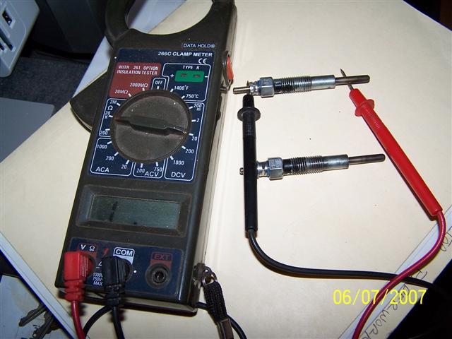

I replaced the battery in my 04 2615HST in January this year. It started cranking very slow in cold weather. I bought the replacement at Advance Auto. Same case size as original but more CCA.
When the new battery started showing the same symptoms of the original a couple months later I checked further and found 2 of 3 glow plugs had failed. I replaced all three in April this year.
Only one plug was working. The #2 plug had a dead short and #3 had an open circuit, no resistance with an ohmmeter at all.
I'm sure the shorted one did not help the battery since it was draining 12V to ground every time the key was turned on.

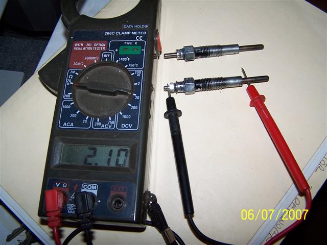

George this is interesting. Can you tell me how you check the glow plugs? Do you put the tester inline with the plug? My tractor doesn't do this but I'd like to know how this is tested. Thanks!
   / Anyone needed a new battery yet??? #6
Tim,
My 2615 has 3 glow plugs. The plugs have a thin steel bar that is under the nut on each one that connects them all together. They are fed 12V from a single feed wire that comes from the timer circuit when the key is turned on. To check them you must unhook the 12V feed wire and remove the bar that connects them all together, then resistance can be checked on each from the connection point to engine ground. Or you can pull each one individually and measure resistance from the top connection point to the part of the plug that screws into the engine. See below. Plug 1 has resistance and is good. Plug 2 has no resistance and is an open circuit. The third one I had (not pictured) was shorted and showed 0 (zero) on the resistance scale.

I think that reading on the second one is infinite resistance (not too sure of your ohn meter). With infinite resistance the device will pull no current. Check the manual for your meter and see what it says for open circuit or inifinte resistance. Or just pull the leads off of the glow plug and see if it shows the same display. The glow plug is bad either way.
