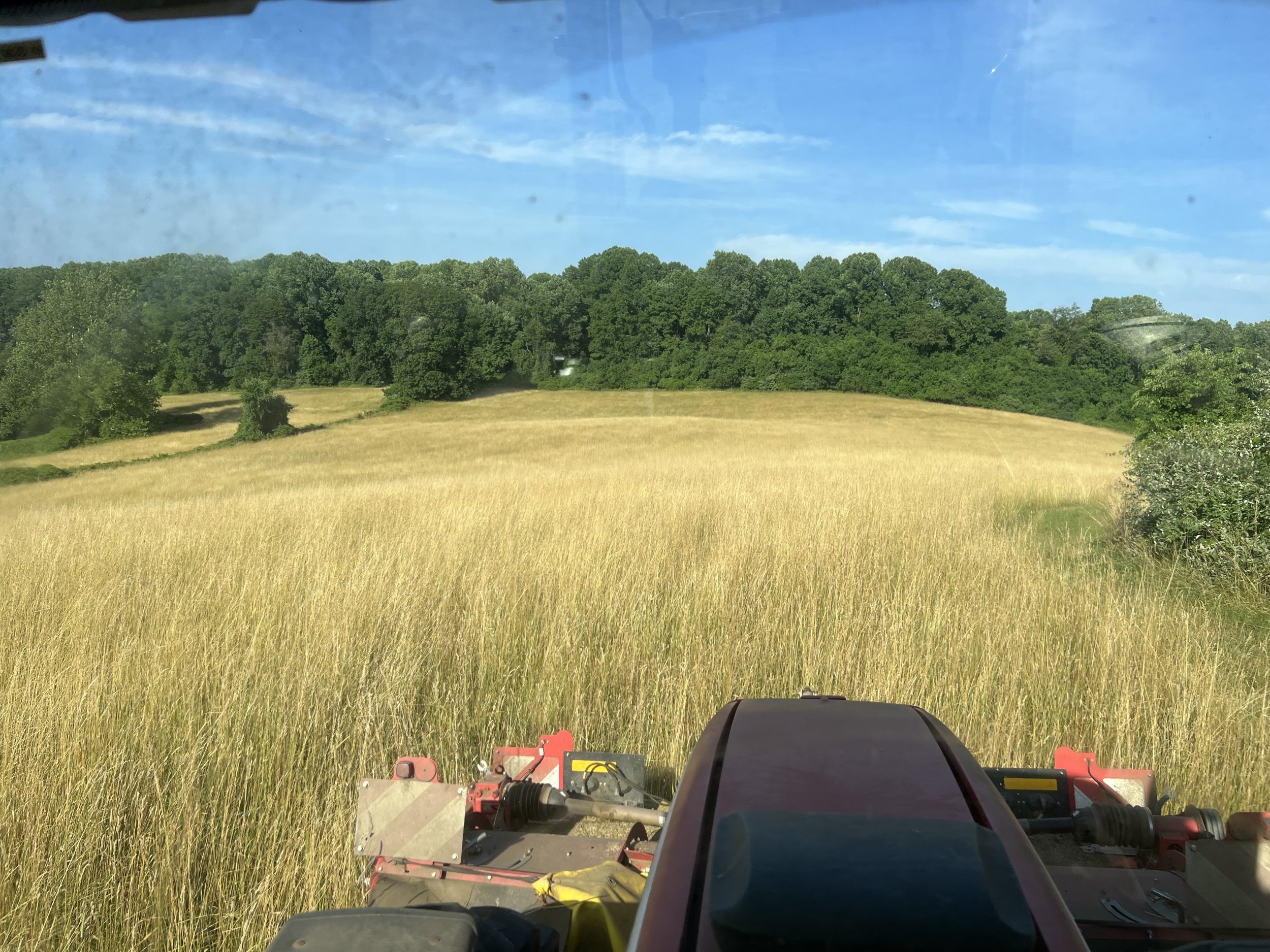

CW would be from days of sicklebar mowers.
There was discussion recently regarding rotary mowing direction, and people seems to think CCW gives better cut. I can’t tell any difference and go the direction that seems safer for the hillside I’m on.

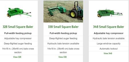

This is a little off-topic but someone in this "hay group" likely knows the answer . . .
I was looking for baler parts on the JD site. Happened to land on the small square baler overview page and noticed that one of the headline features of the JD 348 baler is "Automatic Lockout". I can't find any explanation or reference to this on the linked pages. Does anyone know what the "Automatic Lockout" feature is??
Thanks in advance!

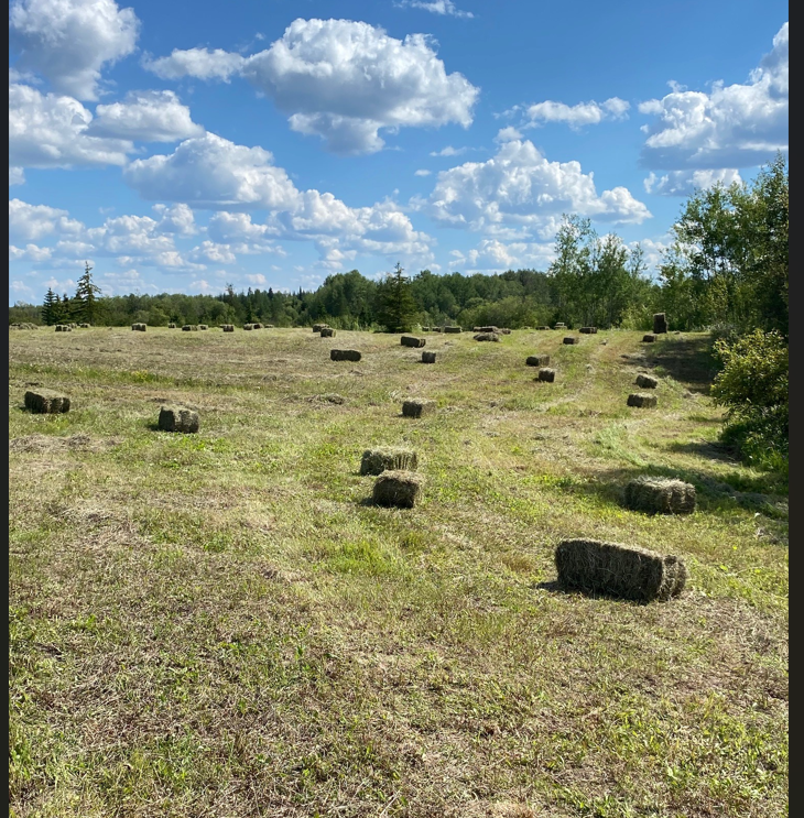

This is a section of the field I worked and seeded early last year, it is very healthy, notice how long the hay is and how close the bales are from each other. I am very happy with the results, it pays to put fertilizer!
Nice tonnage per acre! (y)
Still has some color in it.
I don’t know how you guys do the rainy/cool weather.
I complain about rain/clouds. Nothing compared to my friends from Canada.

Do you just cut and bale small areas at a time? Then pick them up as quickly as possible? Is that because of rain?
/ Anyone mow hay yet? #134
I am not home so not sure what are the exact condition are right now my dad is doing it, but we make sure there is no rain in the forecast we usually get a few solid stretch of a week of hot weather and no rain so we wait for that window some years is easier then other and we wait for a heavy dew within that window which is a good indication that it won't rain. But ya rain extend the process and add a few cycle of raking.
/ Anyone mow hay yet? #135
It depends but yes, you don't want to bite more then you can chew... and yes if it rains on it then you have to rake it many times to dry it off and there is a risk to ruin it, then if you cut and bale more then you can pick up and if it rain on it you ruin all these bales, separating the field minimize that risk. The issue is you have to rake it once around 9 to 10 am you can't do it too early because the humidity from the night need to be evaporated then once the row has been rotated you give it enough time for the humidity of the hay that was in contact with the ground to evaporate as well, then you can bale. So realistically it is 2-3pm by the time you start baling, you can leave them there after but it can't rain on it... any humidity in your bale cause the hay to heat up and rot causing lungs issues to both animals and humans.
