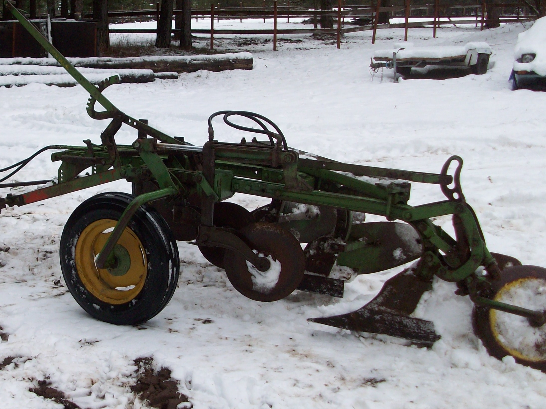

I tried finding a reasonably priced used 3 point 3 bottom plow for the fields on our 10 acres. Well a deal came up on a John Deere pull type hydraulic controlled depth/transport wheeled 3 bottom and I purchased it. The problem is on the size of fields most of the time will be spent getting turned around at the end of each furrow, here's the plow jd plow new 019.JPG The other option other than using it as is, or moddifying it would be to trade or sell and find a 3 point version,but time is running short.. what do you think??

I converted an older rope trip JD 2 bottom many years ago, basically used the lift axle brackets for the 3pt lift arm bar, cut off the frame forward, moved the front frame piece and drilled holes to keep the structure of the frame, and welded a bracket for the top link. Welds must be Good no chicken poop, and the lift arm bar needs to be set correctly for side to side position so they pull right but it can and has been done.
   / Anyone modified a pull type, 3 bottom plow to 3 point? #3
I did an AC 2 bottom and have used it for 7 years.---cut the front beams down short as possible and remove axles levers (mine didnt have any,--someone stole them) ---then I added the 3-pt. adapter parts and got my plow! thanks; sonny 580

Your old plow looks to be in decent condition and some of the tractor clubs are having "plowing days" to teach the collectors how their tractors were used back in the day. So it might be very tradeable.
If that option doesn't work then I'd find a plow like I wanted and measure it up and pay close attention to how it was built and go home and cut out the parts I needed and add to them to build what I wanted. That is easily done with old equipment, convert old into new.
Like js said, no chicken poop welding as there will be lots of pressure on it.

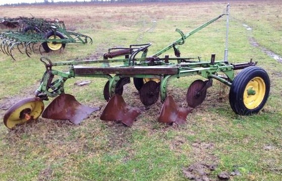

Looks to good to alter.
Have worked bigger trailing machines on a lot less than 10 acreas.

I looked at my bottom plow yesterday after reading your post and it was simple constructed. Cutting out the portion you need to save and converting it to 3 point would not be that hard to do, just do it strong n solid.
I think that's my problem, kind of hate to cut up , the only JD piece of equipment I own jd plow.jpg
