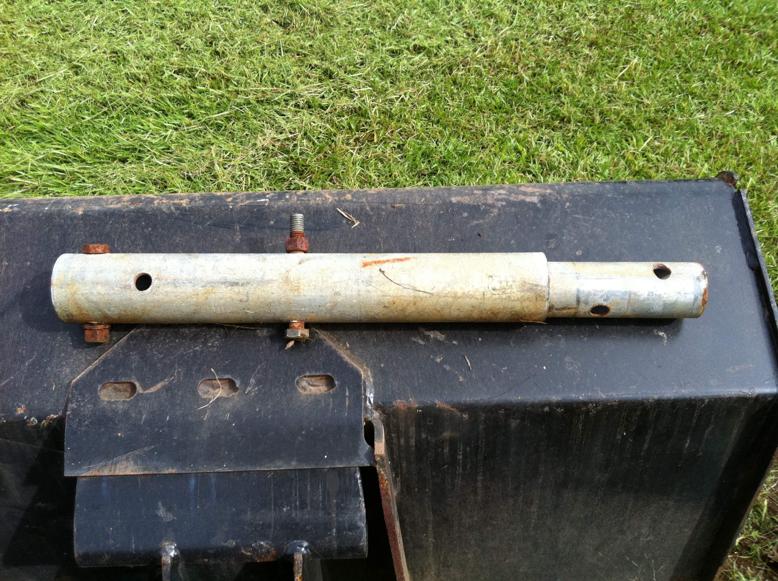

I have a World Agritech Corp phd with a 9" x 24" long auger. I really would like to extend it another foot or so.
The shaft coming out of the gearbox is 2" OD and has 2 90 degree holes through it that 1/2" bolts fit through the collar of the auger & through the shaft.
It doesn't look like a very big project to make an extension. I was thinking of using 2" OD X 18" steel tubing with a piece of 2-1/4" OD (.120 wall) X 4" for the collar & then welding them up.
I guess the question I have is the 2" tubing heavy enough or should I be looking for solid steel rod?
Any suggestions would be appreciated.

I did that. Needed to auger minimum 60" with the 12 inch. I made a sleeve/pipe extension with the bolt holes. As I recall (almost 5 years ago), I used a pipe within a pipe. If I can find it, I'll post a pic if you like.
Here are some action pics.
Only had to do 9 holes, took our time.

Thanks Sodamo - that is pretty much what I am intending to do. I just have to find some small lengths of steel tubing. btw that looks like the same phd I have.

If I recall, I went to HD and bought my lengths of pipe, they cut them to length I wanted. Then I just used a small drill press for the bolt holes.

Keep in mind the geometry of the PHD, PTO shaft, and the longer auger. I made the pipe within a pipe extension as stated above and found it best to remove a couple shovel fulls of dirt to set the auger into initially. Keep the rpms low any time you have to raise auger up and out. Too long of an extension and you will not be able to raise it out.
   / Anyone make a phd auger extension before #9
Excellent point on the length. Alternative, albeit time consuming is to connect/disconnect the extension in the hole. Had to do that on a couple where my tractor was on an incline.

Ok, here's mine.
