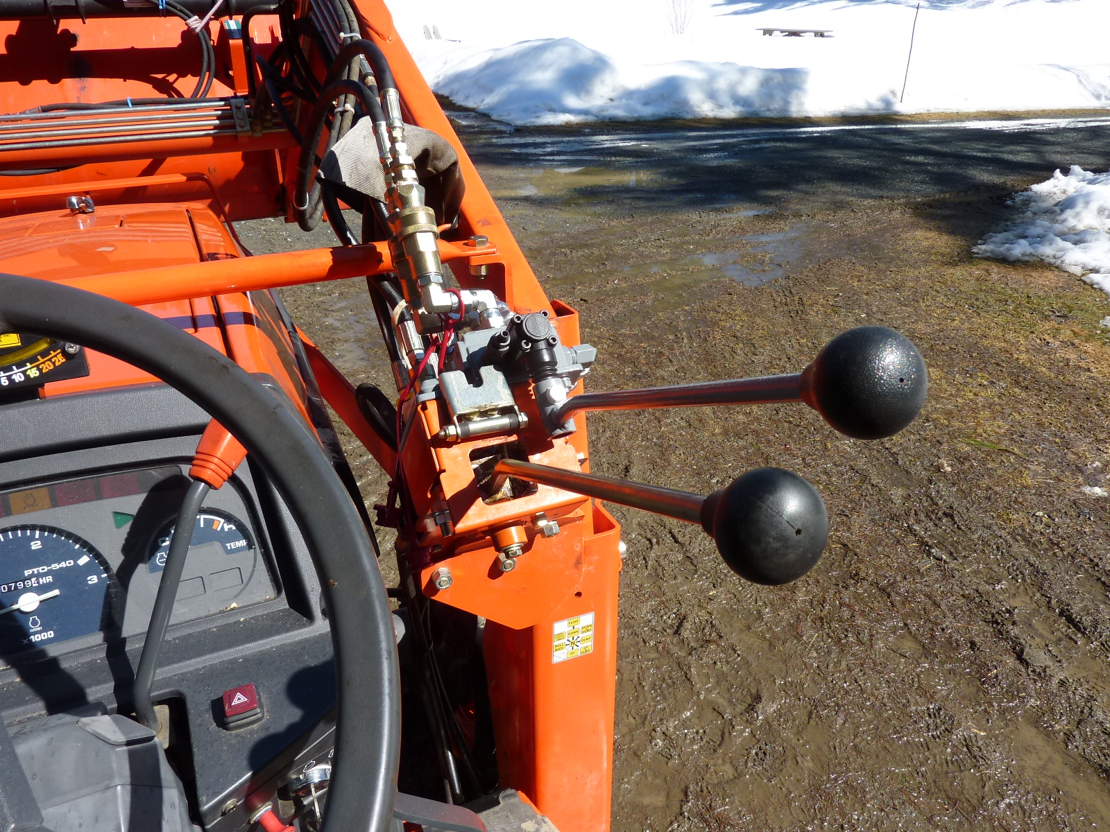

I am not sure if this is what you mean but I added a valve and second joy stick to control my grapple
I am sure others have done it with an electric diverter valve and a switch on the loader control lever.
And yes you can add rear remotes. You would do it like my grapple valve except put the QD's in the rear and probably put the valve(s) and control lever(s) somewhere near the seat.

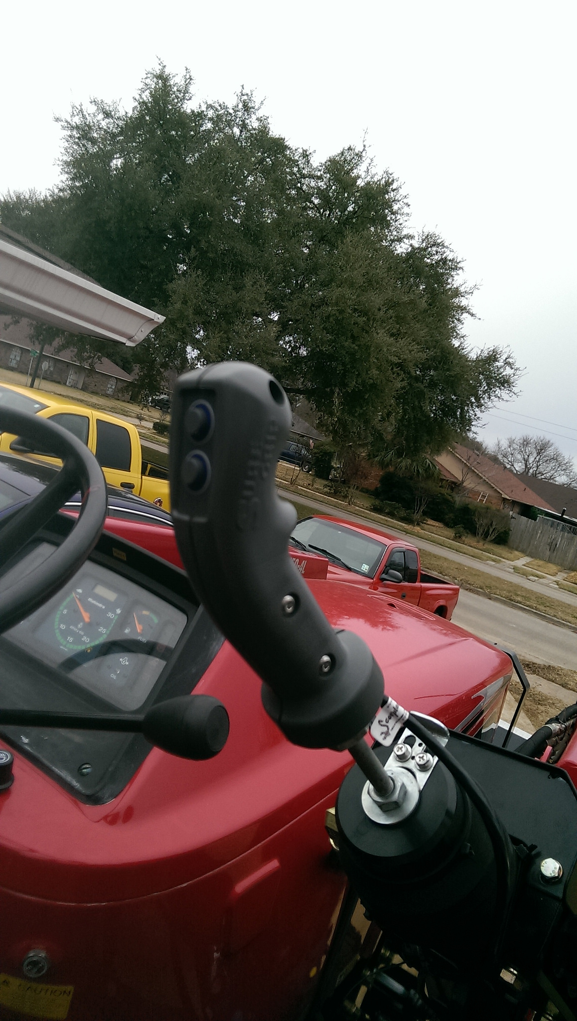

I purchased one for $800, it's a lot of money but that warranty can go a long way. Check out Everything Attachments. They can help get the correct hydraulic flow for your tractor. Mine was built for my tractor and only about 1hr to bolt and hook everything up. It's been great!!!

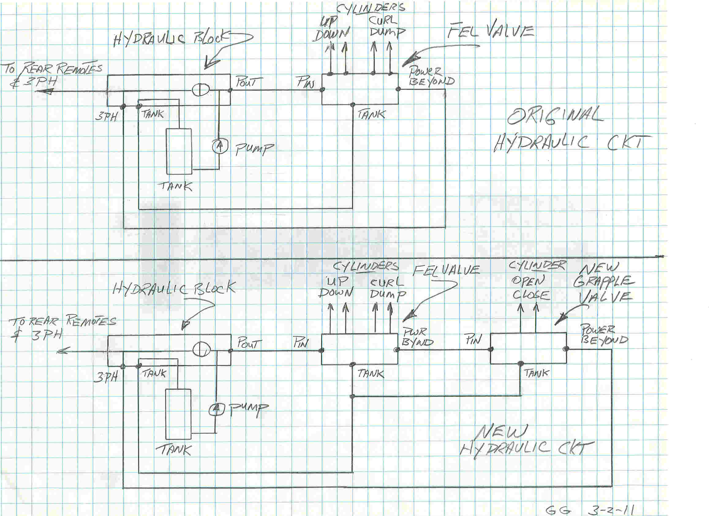

gg
Just for comparison the way I did mine was $250. Bought a valve, some fittings, and some hoses. Here is a plumbing diagram if anyone is interested.

If the tractor has a "power beyond" plug or kit, one can use that, (one of John Deere's) better keep secrets, it will give one a place to directly couple in the hydraulics and a return location, and then one can use the correct set of valves (open or closed depending on the hydraulics) and if one wanted to one could had a dozen valves,
see how they suggest to set up a back hoe with the remote valves, most likely using a power beyond block or it is built in to the tractor,
the tractor does not know what type of valve is hooked up, to it back hoe or a grapple or a loader,
