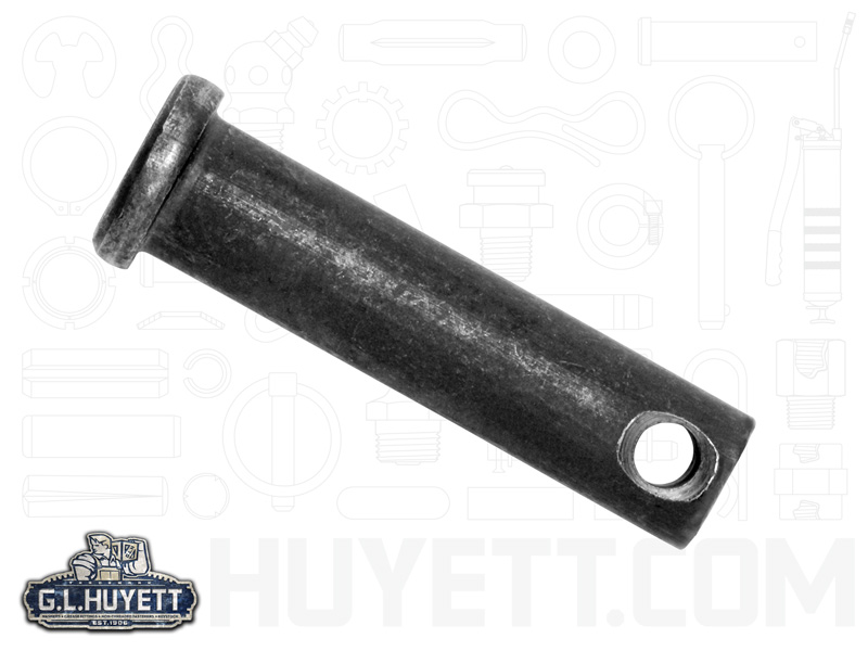

I order steel piece parts online from Huyett.com
They are also a good source for grade 70 chain & hooks. Much of it US made.
Sure enough, they have a clevis pin that size. 1.5"diam. X 6" long. $25.
It's mild steel - not sure what you want for temper.
Maybe weld or fasten a loop to one end or the other.

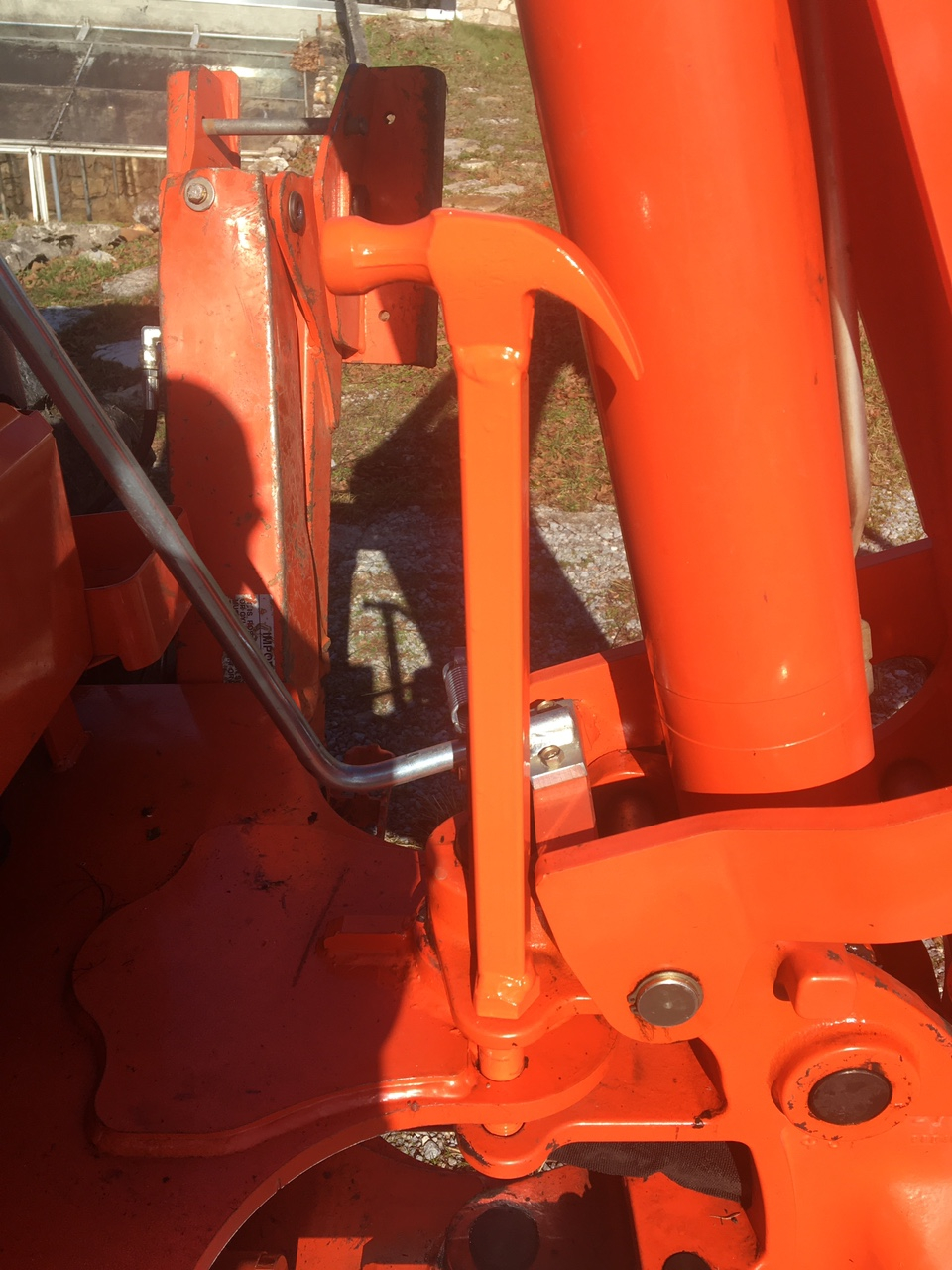

The swing pin was missing on my Kubota M59 backhoe too. Factory had a rod handle to grip from the seat to move from lock to store position.
Made one from the scrap pile. Think it was a 1” x 6” bolt, 1” square tubing and old hammer head. Hammer is sometimes handy tapping sticky pins.
Tried to order OEM pin from Messicks about $40. After about week they called and told me it would be delayed weeks because of shipping from Japan. Funny since I thought the backhoes were made in Georgia. Canceled order and went with plan DIY.
