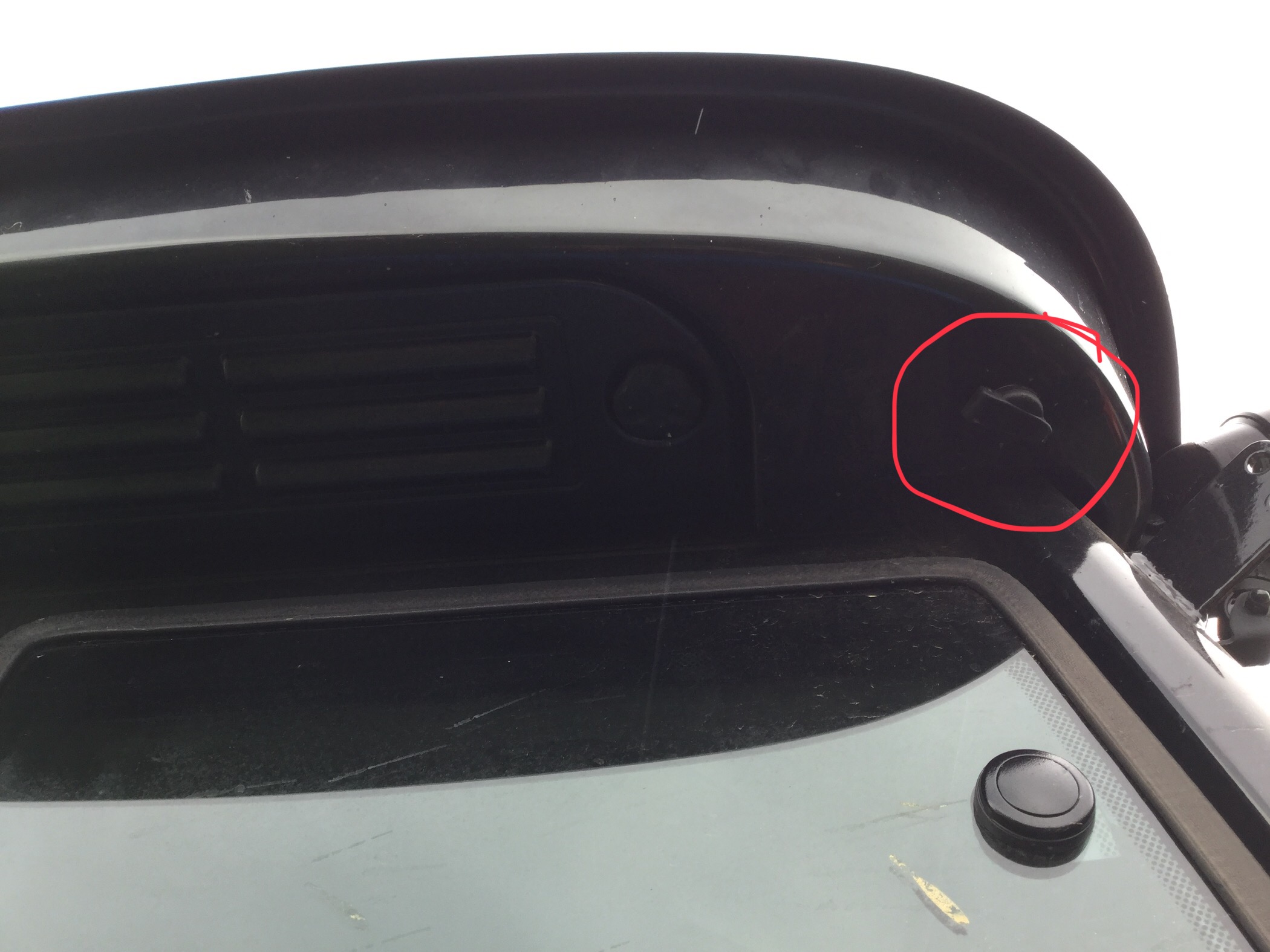

Wondering what this is. There is 1 on each side of the cab. It has a flip down cover and then looks like a cigarette lighter plug in but smaller. Any clues what they are for .

I believe that is where a rotating amber warning light is plugged in. The mounting bracket is there also.

Those are for beacons that you can get for your cab. There should be a switch in the cab somewhere. I have the same thing on mine.

Yes it's for a beacon light. Many tractor brands have the same plug. You can search online for a BMW motorcyle 12v plug and you can find a male end to fit that receptacle. I use the one on my New Holland to activate a solenoid on my sprayer so I can turn it on and off with the flip of a switch inside the cab.
