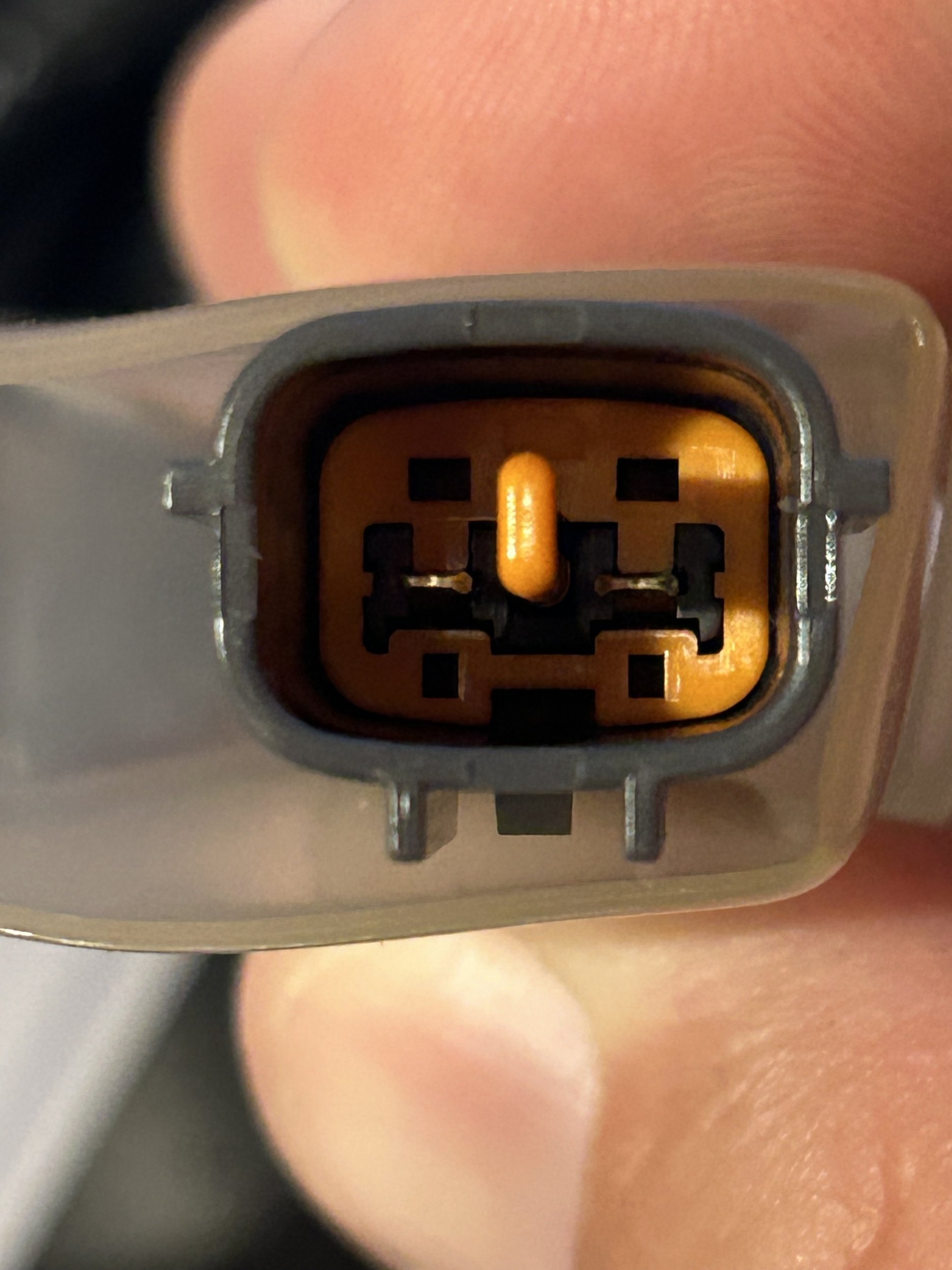

Hello everyone, I have a 3rd function valve for my BX23S kit is BX2412. I have this connector I need to build another one...Can't seem to find it anywhere online...

Might be Weatherpack. Try searching on that term.
   / Anyone know what this connector is?
Thanks dstig1, I did search the Weatherpack site before posting. Did not see this one at all...

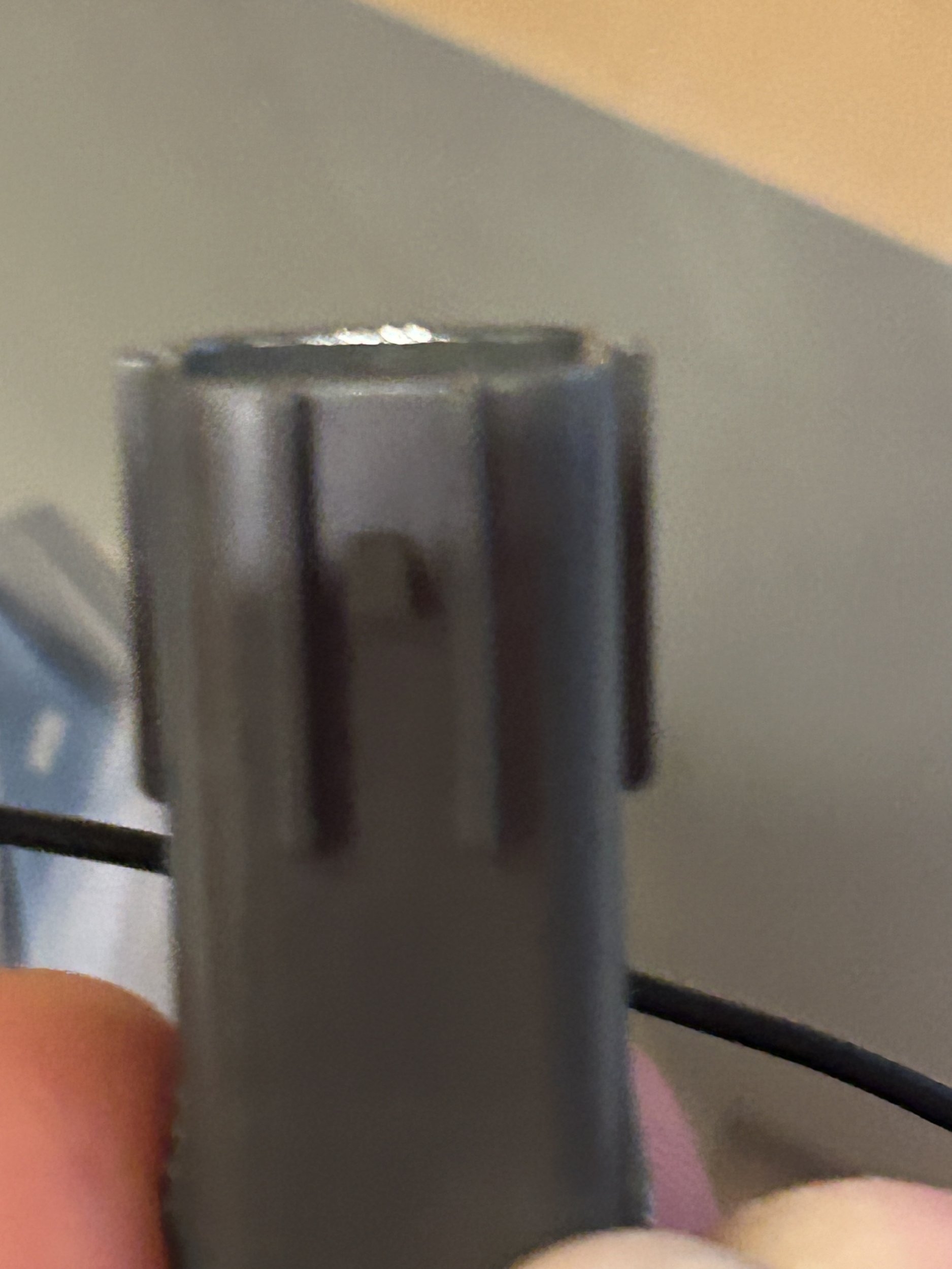

It's weird, this one is 2 flat blades with the vertical plastic nose in between. I might have to try to take it apart and see if there are any markings on the inside...
   / Anyone know what this connector is? #4
You can dig through here, nothing I recognize though. Absolutely no markings on either shell?

Good reference site. I tried looking there but to your point nothing similar...
No markings on the casing which is weird.
I managed to find the female end part number, but no male end...
It's part number 1C010-65830

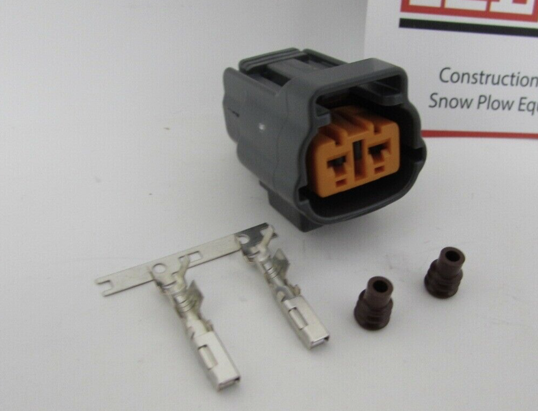

GENUINE KUBOTA DIESEL CONNECTOR COUPLER D1005 D1105 D1305 D1703 D905
And the female end disassembled looks like this...

NMWP connector ? Use Google to do a search using your photo.

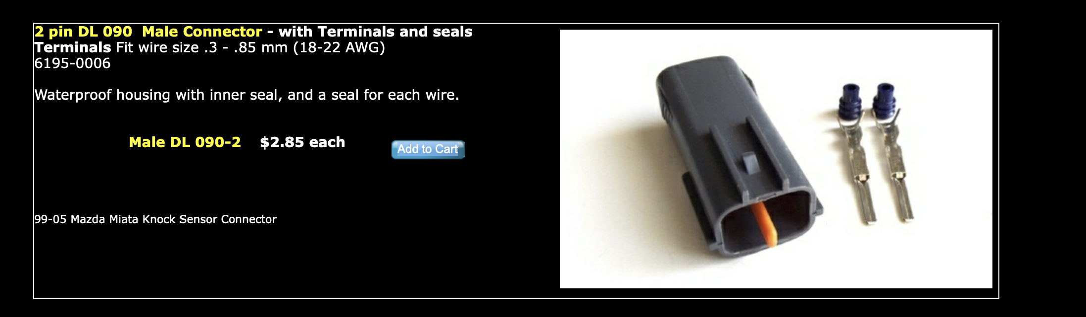

Never knew I could search using images!!! Thanks Mattpg!!
Looks like the male version is CE2171M
You are welcome. I’m pleased it helped you out.
