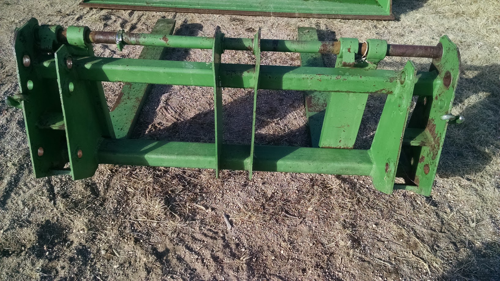

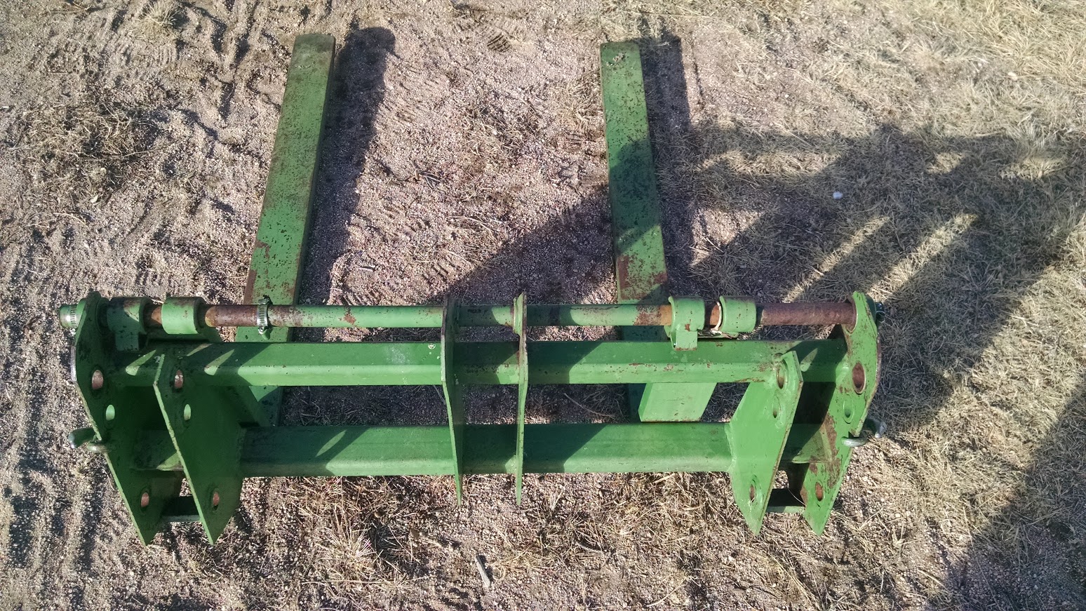

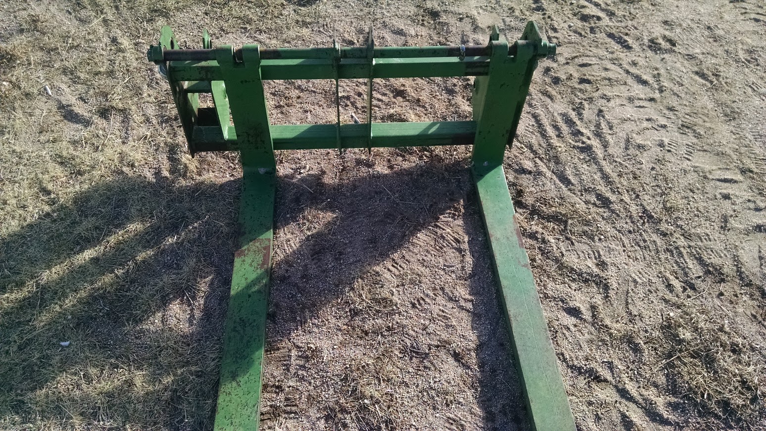

My father-in-law had purchased these and they dont fit his JD, but searching google, I cant figure out what they might fit.
The attachment point is about 36" on center.
Any thoughts? I figured because they were green it was for a JD but I have no idea.

Because they are JD green I'd say they fit a JD. Probably a model that uses a different loader than your FIL. Does your FIL have the JD quick attach system. If so those forks could be modified to fit.

My FIL's machine does have the quick attach system. He passed away last year and I've been tasked with selling his stuff so its not too important to try and get these to fit his machine - I'd just like to be able get these a good home but thats tougher without knowing what they are for. Seems all the new forks these days have the upper safety grid to prevent stuff from falling back, so I'd think this is fairly old.

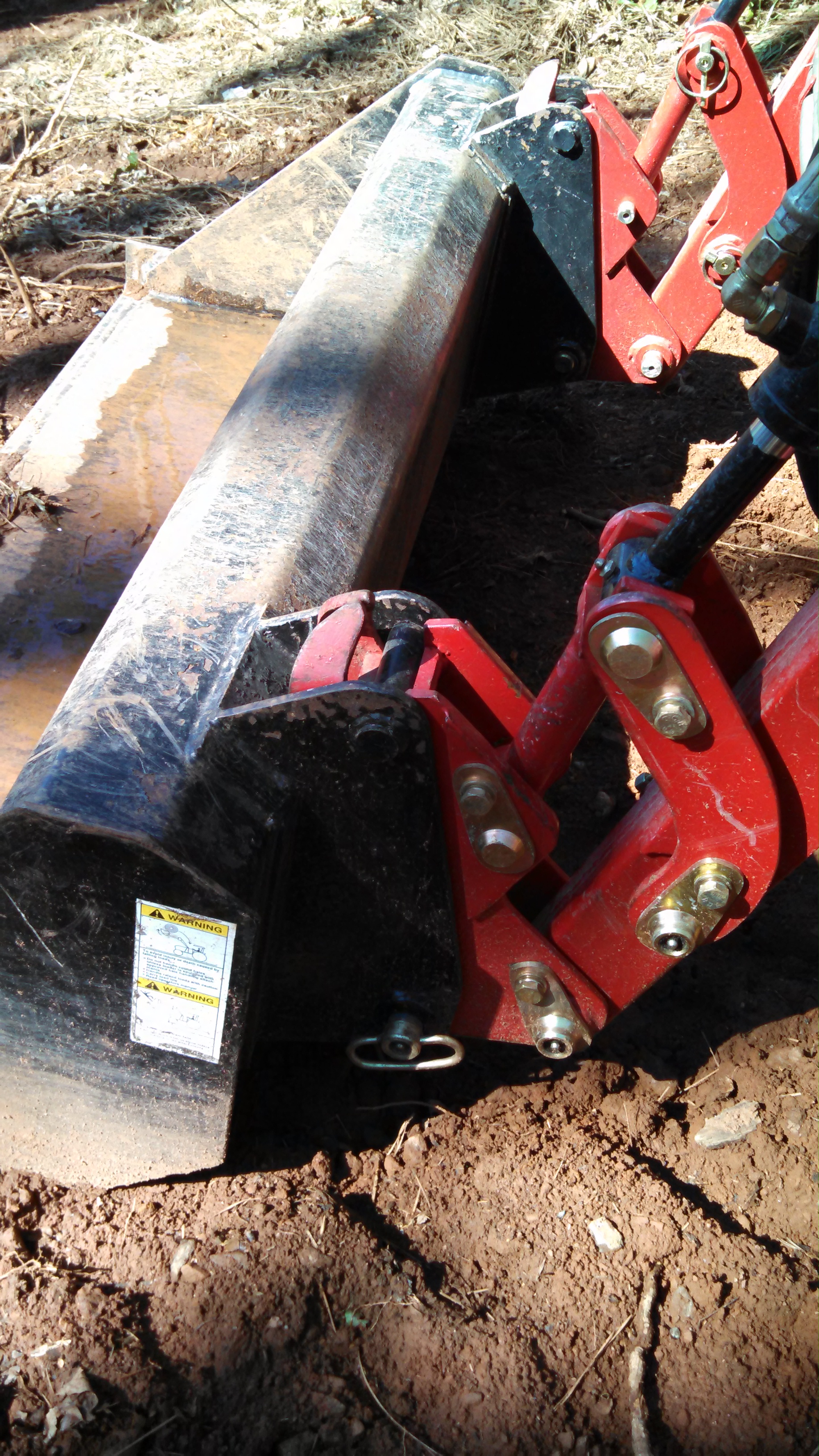

If you could provide some more exact measurements. I might be interested in buying them. (not sure how we could ship to GA though) I have a vtek loader on my yanmar which is similar to many smaller JD tractors. My loader may be the "pin and hook" style previously mentioned. I'll attach a pic. My dimensions are 38" center to center and the pin "pockets" are 3-1/8" wide on the inside, and top pin to bottom pin is 10-1/8" center to center. Of course there is a little play in those of about 1/8" +/-. Either way, I hope this helps and I am in the market for some forks that will fit my loader.bucket3.jpg

These will be for older loaders when buckets, etc where pinned on. EX 148, 158 Loader.

From the size of the frame and pin placements, it is more than likely for a smaller John Deere series loader, such as the 145, 146, 148 & 158. Do you know what the vertical measurement is from pin to pins on each side? Also, the diameter of each pin slot?
