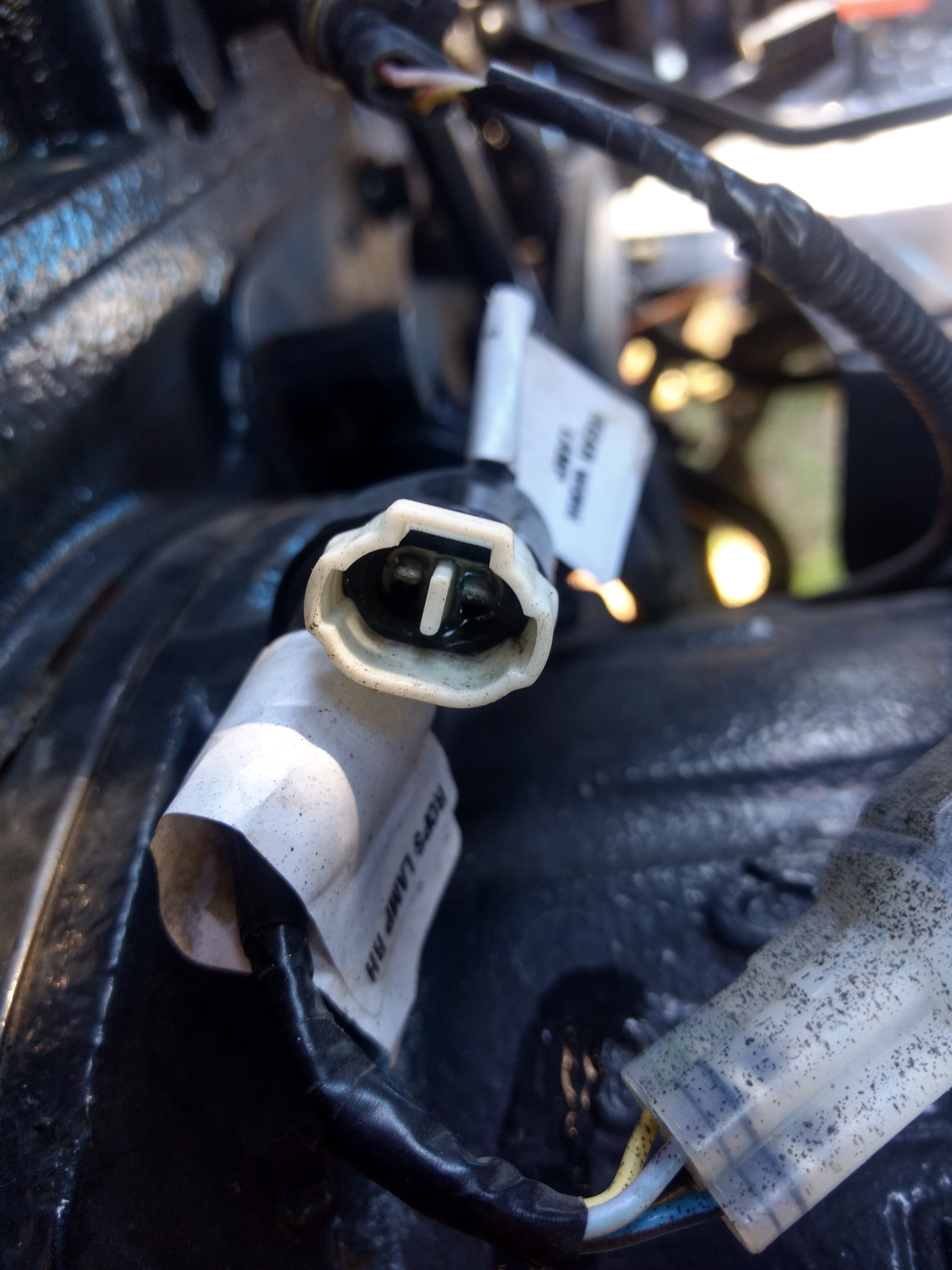

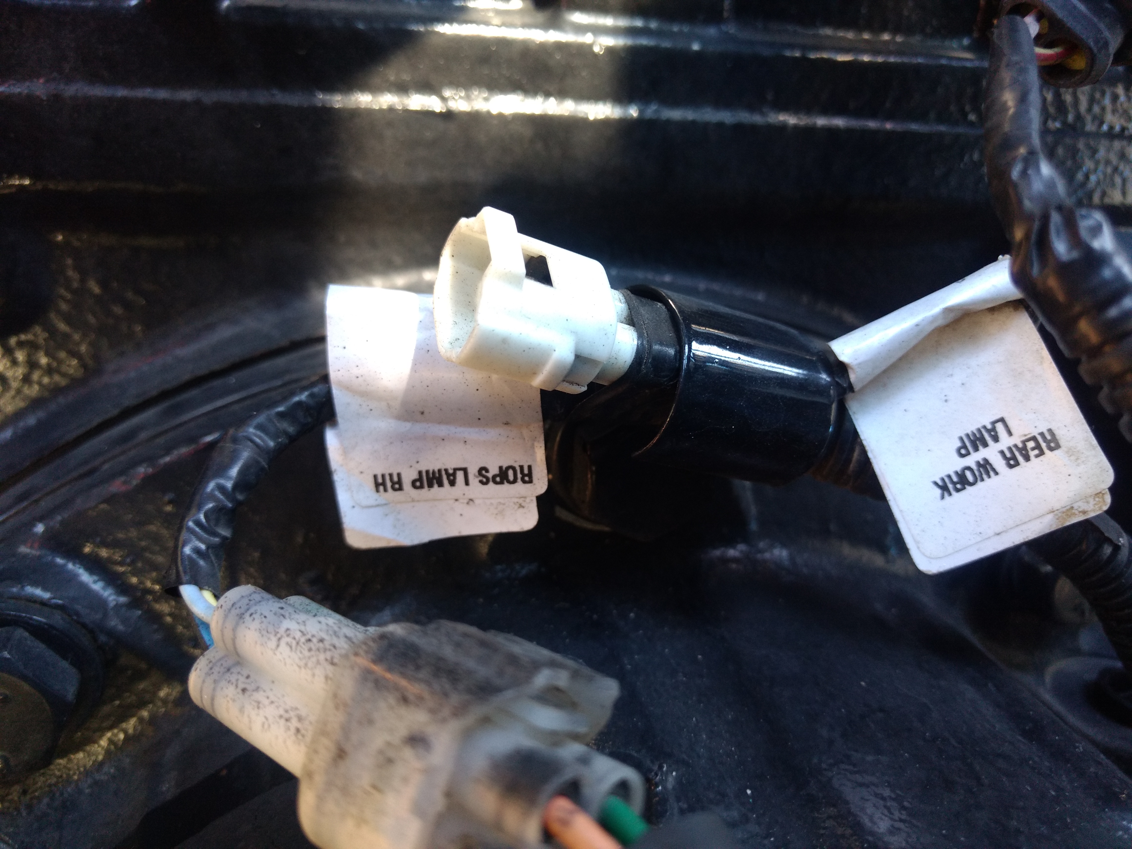

Installing work lights on my Workmaster 60. I found a plug for it but went to three car parts stores and they said they don't have anything to fit it. Anyone know what plug it is, a link from online would be helpful to order it.

Would you be interested in buying a matching pair and cut that one out?
Brett
   / Anyone know what plug I need for this?
I could, but I wanted to just use the factory harness how it is. If possible....
   / Anyone know what plug I need for this? #4
I'd cut and splice, myself. Connector is just one more place for corrosion / bad connection. Unless there is some reason you may want to unplug your work lights in the future.
   / Anyone know what plug I need for this? #5
I think I'd try an auto electric/electrical store.
   / Anyone know what plug I need for this? #6
If you search Del City auto electrics, or wiring products.com, and waytek have several types of connectors.Or bite the bullet and swing by your friendly New Holland or a Case IH dealer they may surprise you sometimes they are not priced to unreasonably.
good luck

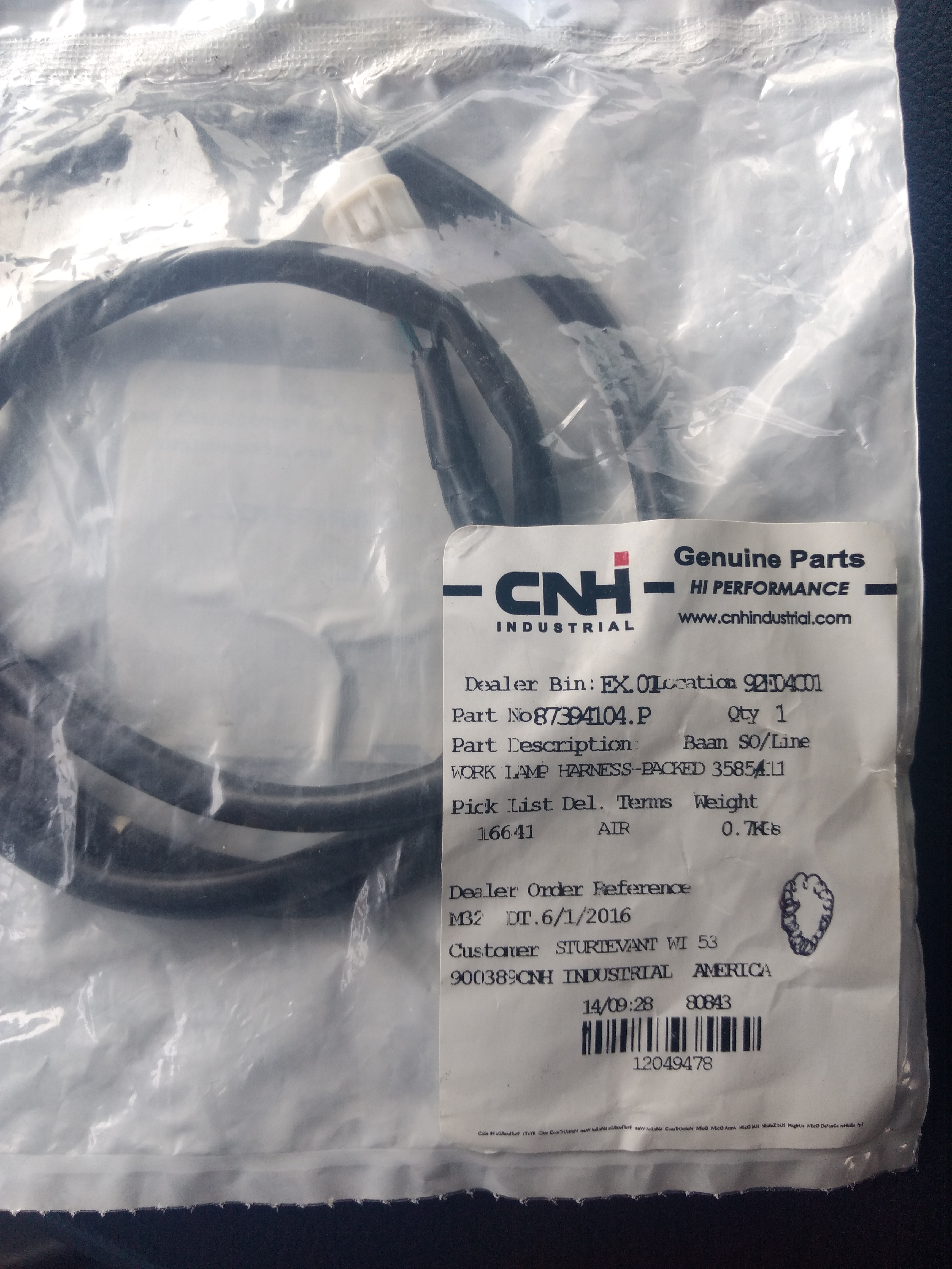

Got it, sharing incase anyone else needs it.
