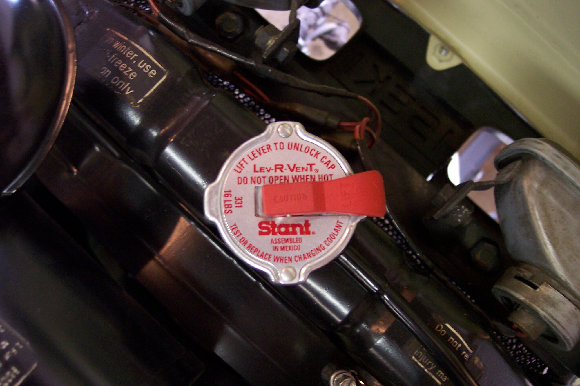

I replaced my radiator cap about a year ago with a NAPA/Stant cap, it is 7 pounds pressure, but starting leaking not long after getting it, but it has done the job. Anyone know the factory cap's pressure?
Or where I can get a Bolen's cap? My parts guy no longer does Iseki's

I have a 16 lb cap on my G154. It has been on there since I rebuilt
the tractor. I have not had any issues with over heating or
leaks or coolant loss. It is a stant part number 331.

Here is a picture.

I just went out, uncovered, started and let run my G194. I remembered this post and checked my radiator cap. It's the original Japanese cap and is 16 lbs.

Thanks, I bought a 14 pound before even getting back to check this post. And it seems to hold fine, previously the cap was only a 7 pound.
