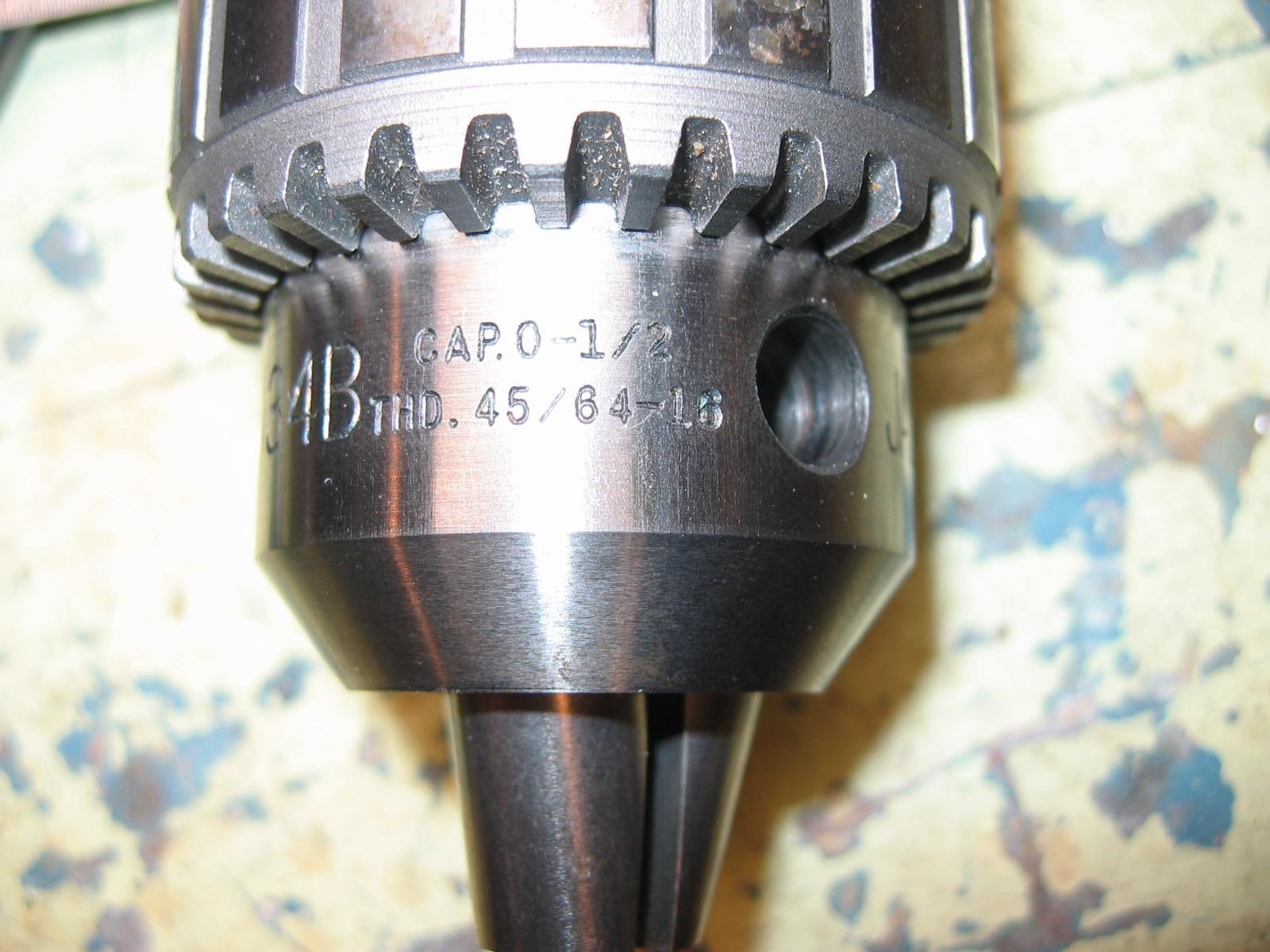

The thread size of this Jacobs style chuck is listed at 45/64"-16 as shown. I'm wondering if anyone know where this odd size originated.

The Jacobs chuck invention:

Do you have the chuck?
How close is it to fitting a 3/4 - 16 bolt?

I don't have the chuck but I don't think it would be close to fitting correctly as it would be almost 0.050" smaller than 3/4"-16. Others have speculated that the 45/64"-16 thread was requested by a machine manufacturer to fit their spindle.
Just trying to figure out where this odd thread size originated.

I suspect it is to limit its use to what it is intended for. They didn't want someone threading it onto a bolt and using the chuck to hold a chisel or punch.

I thought the thread might have been an old thread spec so I looked in my 1918 edition of Machinery's Handbook. It was not there. I suspect Jacobs used that thread so that the chuck would only thread onto what Jacobs wanted it to. In my 45 plus years machining I have seen very many special threads designed such that the threaded part would only fit what the manufacturer wanted it to fit, so no surprise at your chuck.
