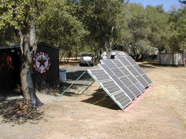

I don't read anything that contradicts what my plans have been. I added $6800 in solar panels & controller, qualifying me for the $2000 credit this year. I've received the CA tax credit in previous years for previous additions but that is no longer offered.
I'm watching our power system closely on stormy days. The goal was to eliminate generator usage to make power (I still must run it for an hour every 4th day for water). Since installing the newest panels last May, I have had to run the generator to augment power about 2 hours total ... pretty darn good. But that's been over the sunny summer. Last day off was cloudy and while doing those normal things on a day off including watching TV, I was "losing" 7 amps per hour.
If I had one more bank identical to what I installed last May, I'd have been "making" 3 amps net per hour on that cloudy day off, despite the things we were using electricity for. Not a huge amount but more than we'd be using so the battery bank would be going slowly "up" instead of slowly "down".
But no credit on taxes unless I wait until after Jan 1 to buy the next set. By then I'll know for sure whether another $6800 investment will totally supply our energy needs, or just "jump halfway toward the wall" again.
It was an easy computation: I read the measurements in and out on the stormy day, then took the reading from the newest set and added it in again.
The attached photo is of our solar panels now. The six farthest from the camera are the newest, and I'll likely be adding six more like that again. It's been a system that has evolved over the years as budget and technology have allowed.
