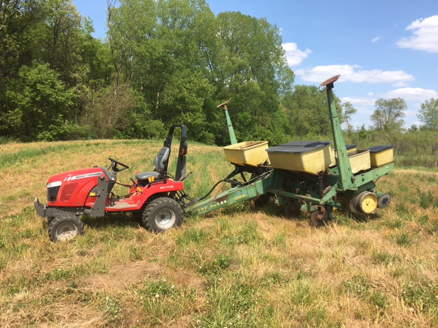

I hooked up a corn planter with a hydraulic ram to my GC1715. I didn't install rear remotes, just bought 5 feet of hydraulic lines and used the hook ups for the Front End Loader. Worked great.
Pretty cool, my problem is I need my loader hooked up at the same time as I need to operate a piston on my 3pt blade.
   / Anyone install rear remotes on there GC1705? #5
I bought and down loaded the parts manual and service manual from AGCO. It does not show a valve kit; however, this thing is almost a Kubota on the underside, and they have one for the BX tractors. The GC1700s have the lever slot on the right side. :thumbsup:
