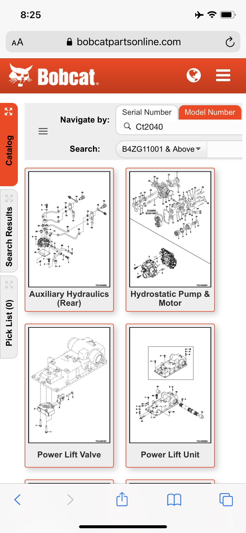

I would like to install rear hydraulic remotes on my CT2040. Is the kit that Bobcat provides complete with everything needed? I tried to get an installation manual in advance of buying the kit but Bobcat will not provide it.

You can search the remotes in the online parts shopping tool Bobcat has, it shows an exploded view and looks pretty complete to me. I just installed the backhoe on my CT2025 and the hydraulics where straight forward with the parts provided and instructions. I did have to improvise because the instructions didn’t include installing together with rear remotes which I have, but it was just one connection I needed to change

Thanks Snowlan! I haven't been able to locate the exploded view yet. Where did you find it?
   / Anyone install rear hydraulic remotes on a CT2035 or CT2040? #4
Not sure if I copied this link correctly, but I will also include a screenshot.

It's complete but it's also very expensive.
   / Anyone install rear hydraulic remotes on a CT2035 or CT2040? #7
I can’t comment on the price, my CT2025 was quoted with the rear remotes included and the total price was still less than the equivalent Kioti, but I don’t know the item price.
The on line build and price tool puts dealer installed remotes at about $1000 CAD. By the time you eliminate install fee I can’t see saving a lot of money going third party.
I can say that other options I did have priced included a substantial install fee, so there was good savings if you can install yourself.
The factory rear remotes are very nice. It’s all hard tubing, brackets nice and solid, and control levers coming through slots in right fender. Hard not to like it.
