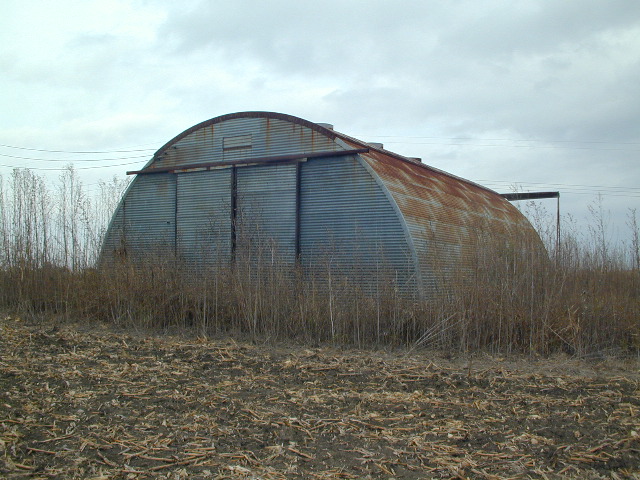

I have a 1950 vintage quonset type building on my property that has sat unused for quite a few years. Many of the panels have rusted.
The roof panels in particular look to be in an advanced rusty state on the outside but show no corrosion on the inside. The dirt on the floor looks undisturbed and dry after a rainstorm so the building seems to be reasonably water tight.
I was looking at some of the rust inhibitor paints on the internet and they are sold as converting the active rust to an inert form and adding a few mils of metal to the painted surface. Has anyone had any luck with this type of product?
From searching around it looks like it would cost almost the same price to replace the panels the as it would to put a new metal building or pole barn on the existing slab.

the rust converters work if you want to go that route. From what you've said I gather your options are: 1. least $$ is to repair with a rust converter then paint .... 2. replace panels at more $$ ... 3. build new at a bit more $$
so - how much ya wanna spend on it? Personally if it isn't leaking - I'd go with the rust converter then paint with mobile home roofing over that.

Painting over galvanizing can be tricky.You need a coatings that will adhere to the galvanizing.
Here is what I recomend:
1) Wirebrush or sand all loose rusty areas.
2) Pressure wash the whole building to remove all dirt, mold, etc.
3) Prime those rusted areas with Direct to Metal acrylic primer.
4) Apply 2 coats by spray waterborne acrylic dry fall.
The wire brushing doesn't have to be down to the base metal, just go over it a bit to knock off the loose stuff. After looking at the picture, a light sand blasting off the whole building will work also. Again, not removing all rust, just knocking rthe loose stuff off. You don't need to blast the galvanizing.
Please check to make sure the coating you select in 4) can be applied direct to galvanizing. Sherwin Williams has a product called Spraylastic that will work well. It says it's semigloss, but is not real shiny.

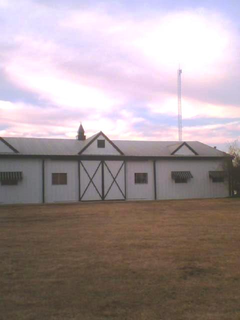

Good evening, Warhammer --
I just painted one several months ago. It was built around 1978 and, because it is a horse stable, it had some rusty holes along the bottom from the stalls.
I researched it quite a bit on-line and off before beginning painting it and here's what I did:
1. Prior to committing to the below process, I "test-painted" a small section with the final Direct-to-Metal paint, to satisfy my curiousity. I found it very, very hard to scratch the paint to remove it. This gave me confidence that this process would work.
2. The old paint was oxidized and very thin and a 4000 psi pressure washer removed virtually all of it. [The paint that did not come off wasn't going to come off.]
3. Using Rustoleum Rusty Metal Primer, I spot primed all rusty areas next.
4. Using Valspar Direct-to-Metal paint, I then painted the entire building with an airless sprayer.
Enclosed is a picture of the finished building.
I stumbled across the Valspar Direct-to-Metal paint at my local TSC. It comes in one gallons in store and 5 gallons by special order. When I read the label, I was excited to know that there was a paint for steel buildings that did not require a full primer coat (just the spot priming for rust).
Obviously, I have not seen the effects of a central Texas summer on it, but I feel very confident that I ended up with a very good result. I can tell you that it made an old building's outer surfaces look almost new again.
