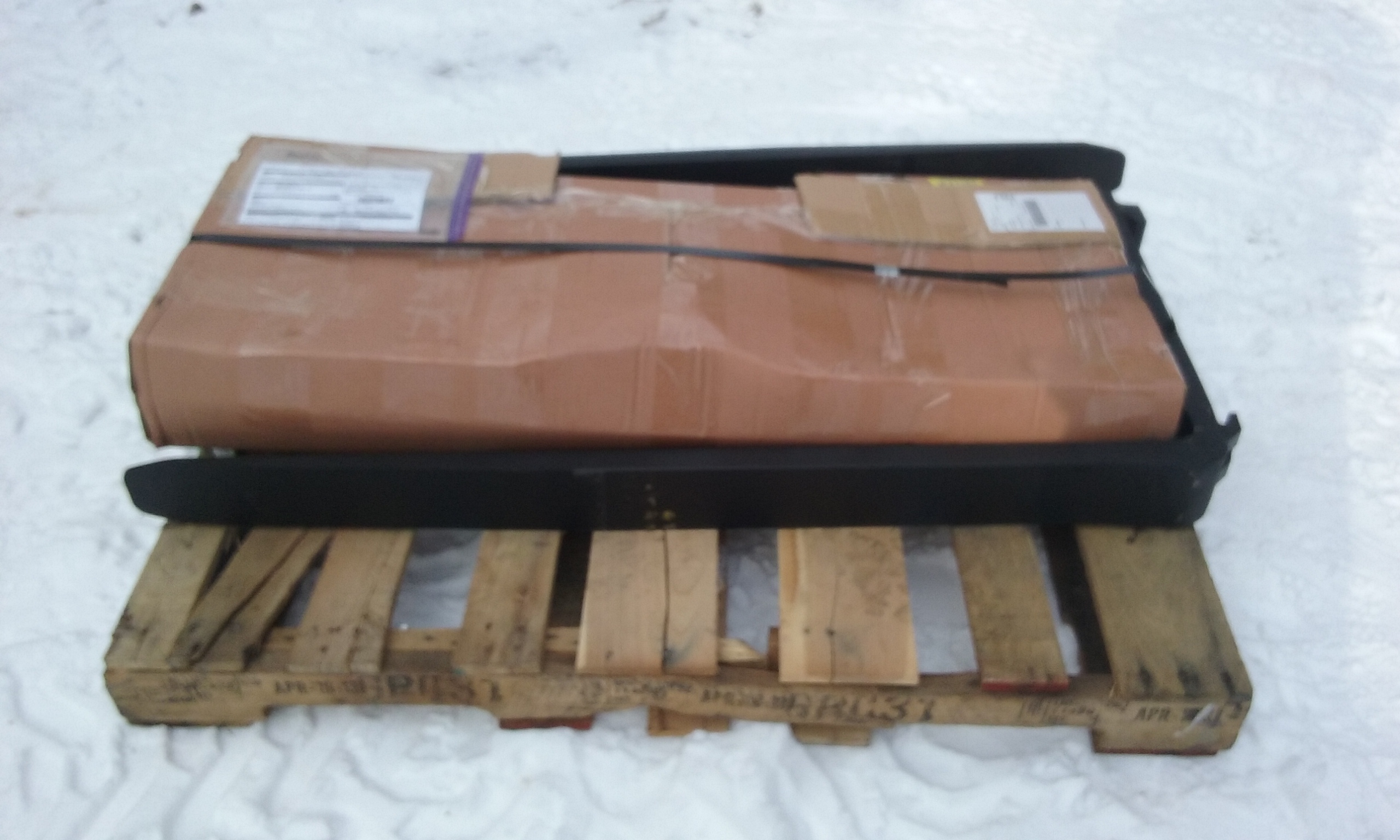

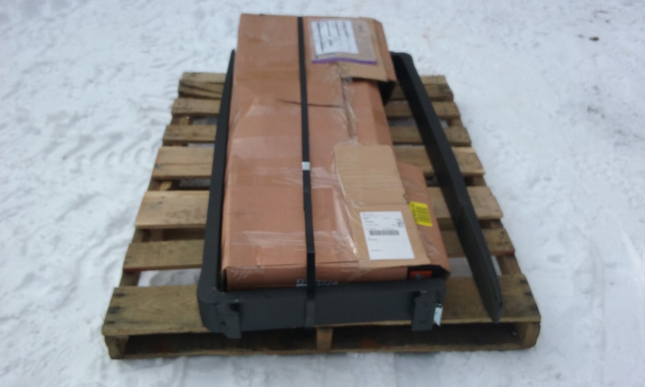

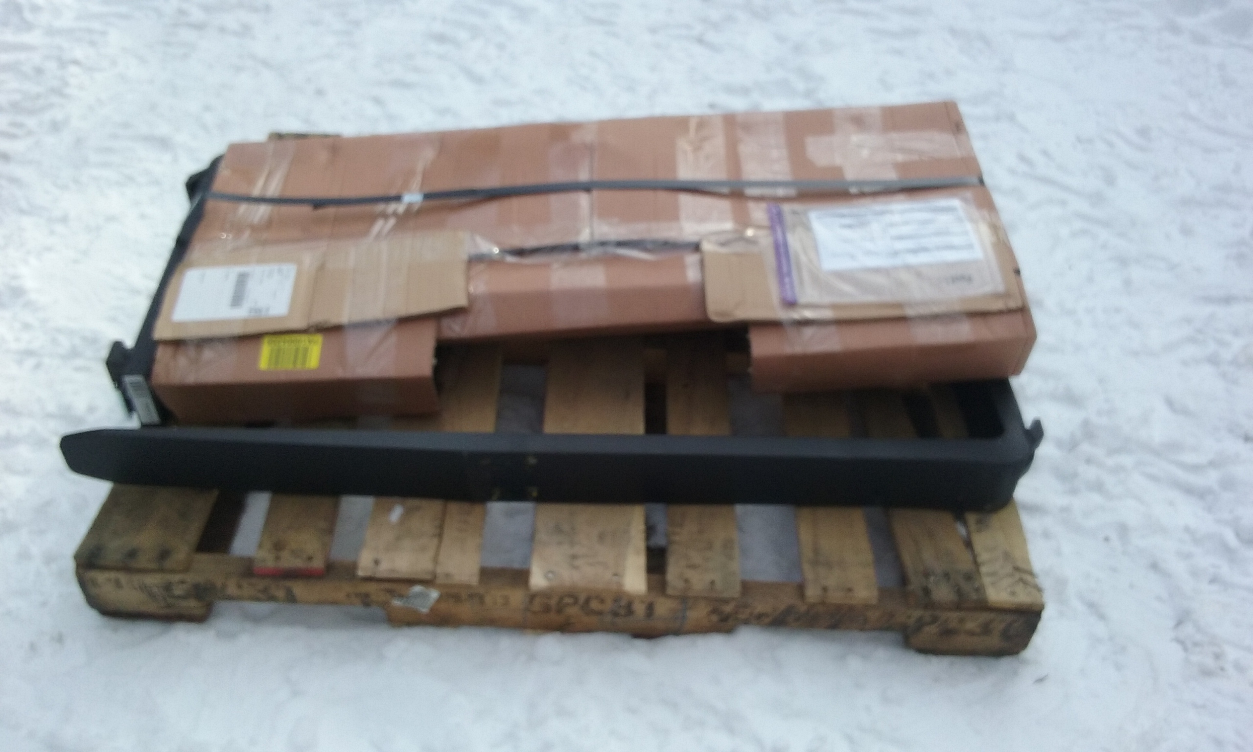

Received the 48" pallet fork attachment today and it looks great. FedEx delivery guy was outstanding in every way (called me when he came down our neighborhood road so I could meet him at the end of our driveway). Titan did a good job of packing onto the pallet. Attachment frame weighs 105 lb, forks weigh 196 lb, pallet is 25 lb. Forks and frame are undamaged. Removing those from the pallet and hefting them around was a workout, but I now appreciate the hefty steel that goes into making these. So far I give FedEx an A for delivery service and careful shipping, and Titan an A for good packaging and initial quality impression. Once I have the chance to try them out I'll give my report.
