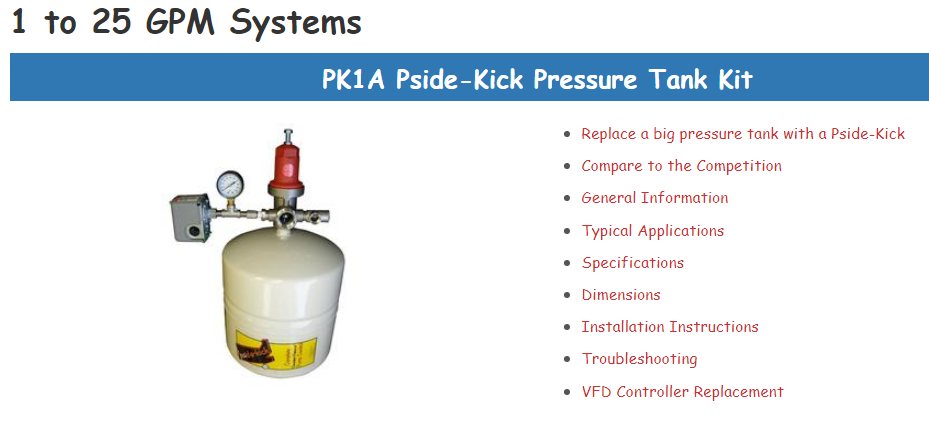

Don't understand why you would put in a bigger pressure tank? The Cycle Stop Valve will minimize cycling.
This is what I am using, a 4.5 gallon bladder tank: Products – Cycle Stop Valves, Inc
