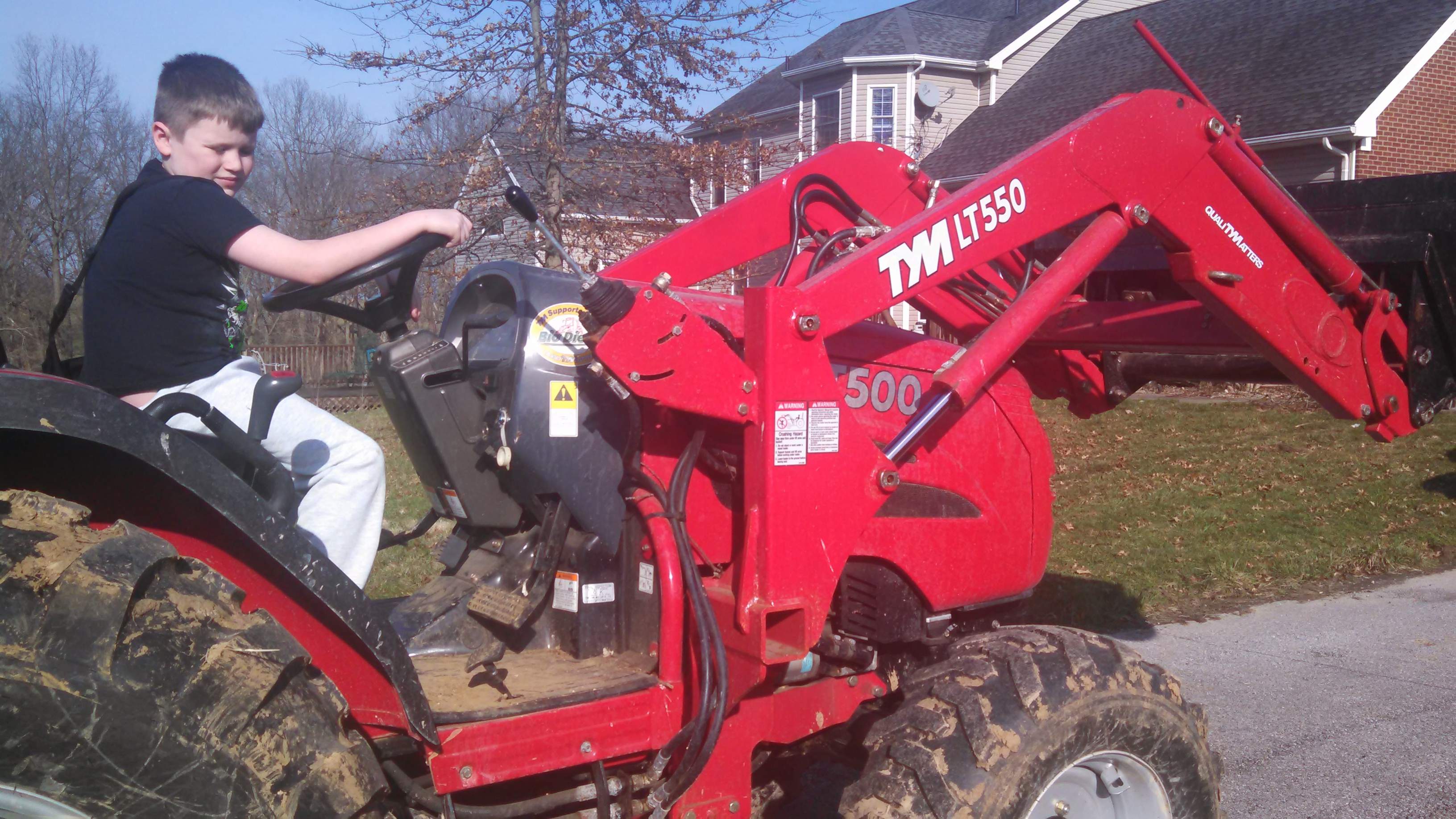

Here it is.

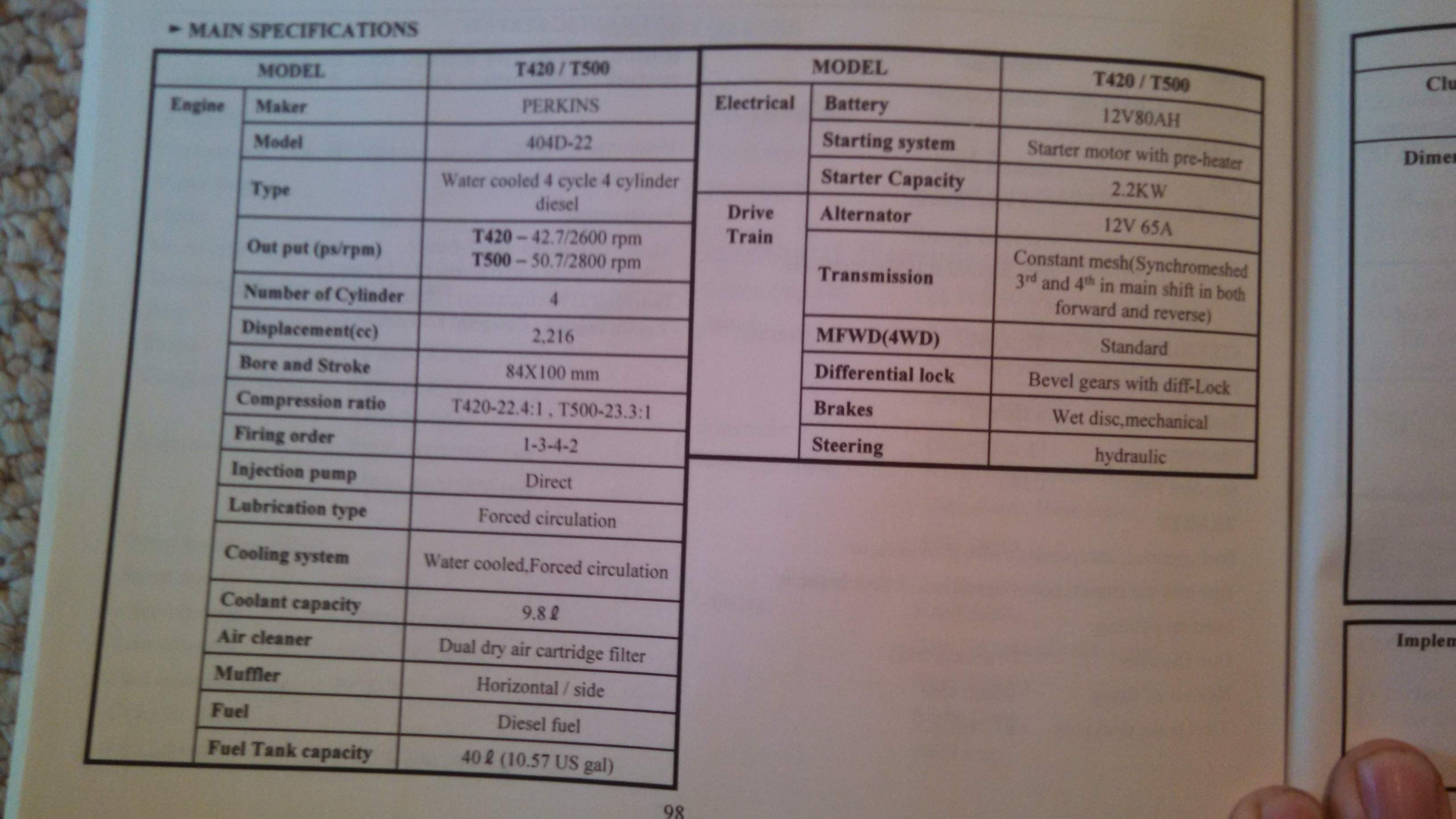

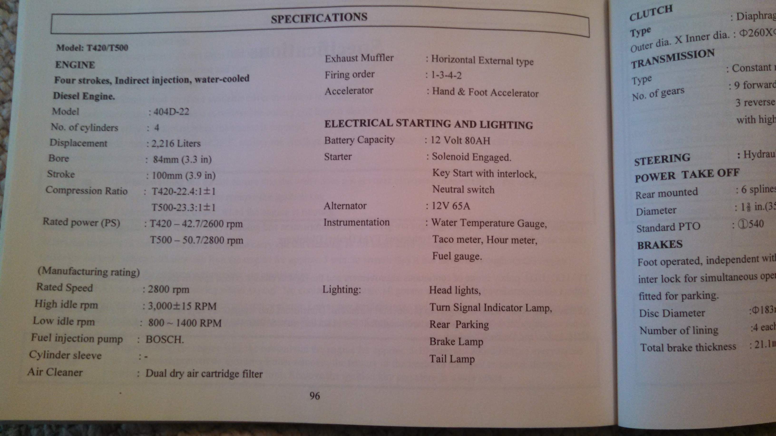

Ok i'll share what I have pictures of the manuals. Maybe it will help someone.
   / Anyone have manuals data etc for t500
