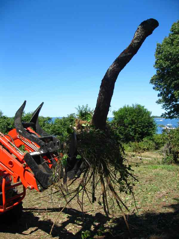

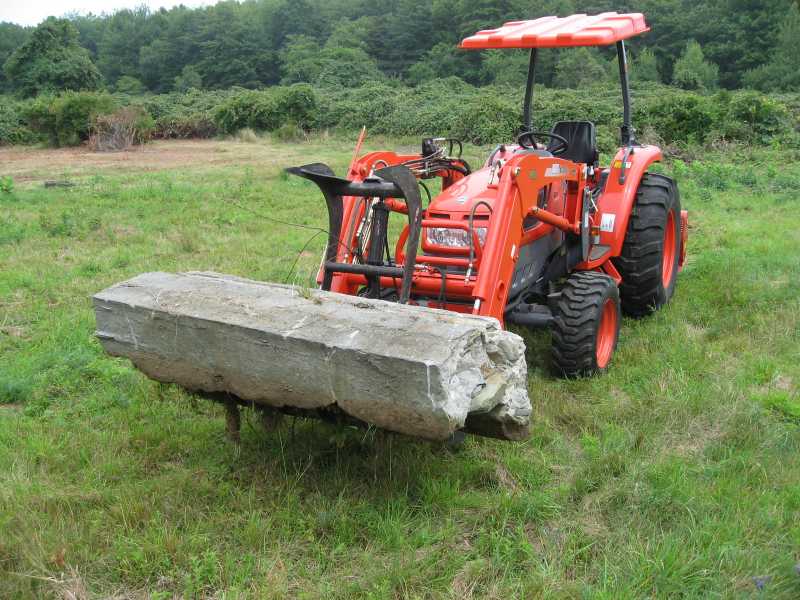

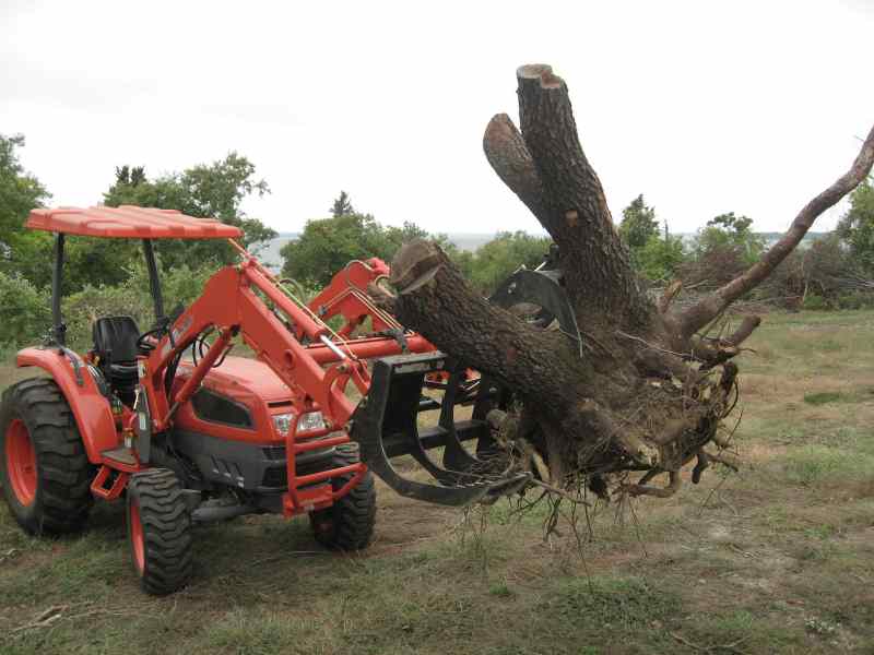

I've posted frequently about the Millonzi 48 inch "light duty" grapple. It weighs 280lbs, leaves you that much more lift capacity and seems to be indestructible. My loader is rated to lift 2700lbs and I can pop the relief valve while digging up roots without damaging the grapple at all. It is also a lot cheaper than the massive grapples.

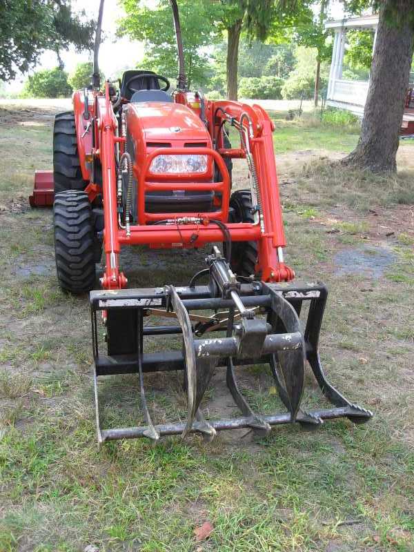

I'm in the process of buying their 'standard duty grapple'. They seem like nice folks w/alotof dirt on their shovel. The unit I'm buying is almost 200# heavier for the same size and price, I'm thinking that it's stronger...

Buying a grapple that is 200lbs heavier made of 1/2 inch steel for the same price sounds nice initially but what are you going to gain besides lost lift capacity? 3/8 inch steel is pretty much indestructible if you use it properly (limit loading to forward raking and lifting up rather than sideways or asymmetrical loads). I doubt a tractor FEL could handle any loads that would bend 3/8 inch steel on a grapple. I can lift my tractor rear off the ground easily using my grapple without any damage. What would I gain from a heavier one?

I'm probably not going to hook the monsterous grapple onto my loader arms untill the spring. I think I need to eliminate alot of weight from it first, or maybe sell it, more first..., but I'm wondering if I took off every other tang and cut away some grapple steel maybe the thing would be close to a match for a Kioti 25hst... It seems that if only the outer skeleton was there plus the front teeth, some 3/4 re-rod would hold the branches and stuff.. jake

If the grapple is really too heavy I'd think you'd be better off selling it...lots of skidsteer guys want grapples...and buying a lighter duty grapple. WRLong, Millonzi, ATI and I'm sure others sell grapples that weigh less than 300-350lbs.
