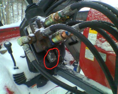

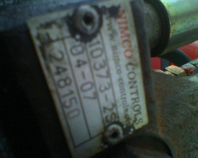

Hi all! Wondering if anyone had a Nimco FEL joystick valve that doesn't work or has some problem and would be willing to part with it?
Mine has some mechanical issues and I thought if I could find one that had hydraulic issues (leaks, bad spools, etc), perhaps I could use some of the mechanical parts to fix mine.
Here are some pics of what I have. "Similar" may also work, so if you have something close, please drop me a line. Part number 10373-2s
Thanks!

What is wrong with your valve?
   / Anyone have broken Nimco FEL Joystick valve?
Worn fixed pivot ball (bottom right) and worn "block" (the part with all three sockets that the handle screws into).
Here is the thread where I was having the troubles:
Nimco FEL joystick valve diagram and relief valve? And rear remotes? - Page 2 - TractorByNet.com
I thought the valve was a problem, but it's just mechanical. I'm not particular on looks, as long as the dimensions are correct :)
Thanks!
- JC
Edit: I believe the one part is actually called "pivot post" Mine appears to be mild steel.

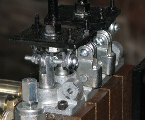

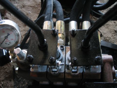

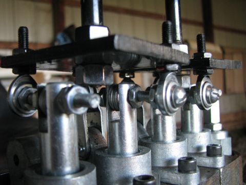

One of the guys on here made up a joystick control for his valves. Here are the pictures. Perhaps you can get some ideas from them.
Thanks, Kenny.
If I end up replacing it, I may go with this one:
https://www.surpluscenter.com/item.asp?UID=2324022216264872&item=9-7761&catname=hydraulic
That should allow an extra set of ports up front if I wanted to add a grapple, or to control a set of rears if wanted.
I just wonder about the Nimcos- non adjustable relief valves. Can you replace the relief valve with an adjustable one?
Maybe I should ask that on a separate thread...
- JC
   / Anyone have broken Nimco FEL Joystick valve? #9
You would have to contact Nimco about the PRV...You should also consider the Prince "stack" valves, they will be more money-but you can "build" exactly what you want.
