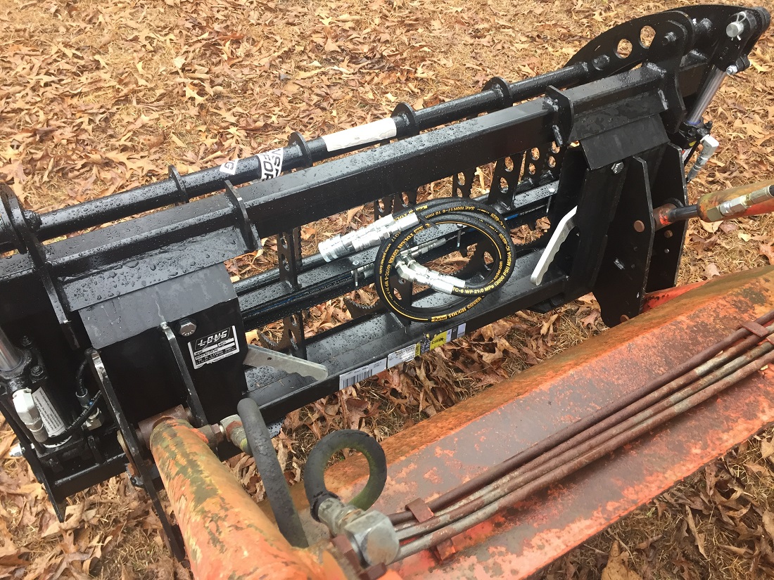

No dealings with those, but we've sold the custom QA Adapter by WR Long for YEARS!! It looks more like a more traditional, OEM design, which is found on most newer machines.
Check out the details, videos and 55 customer reviews on the website here: WR Long Pin on to Universal Quick Attach Adapter
Free shipping via UPS to your home within 1,000 miles of Conover, NC.
Travis
   / Anyone have any experience with hayspear ssqa adapters? #3

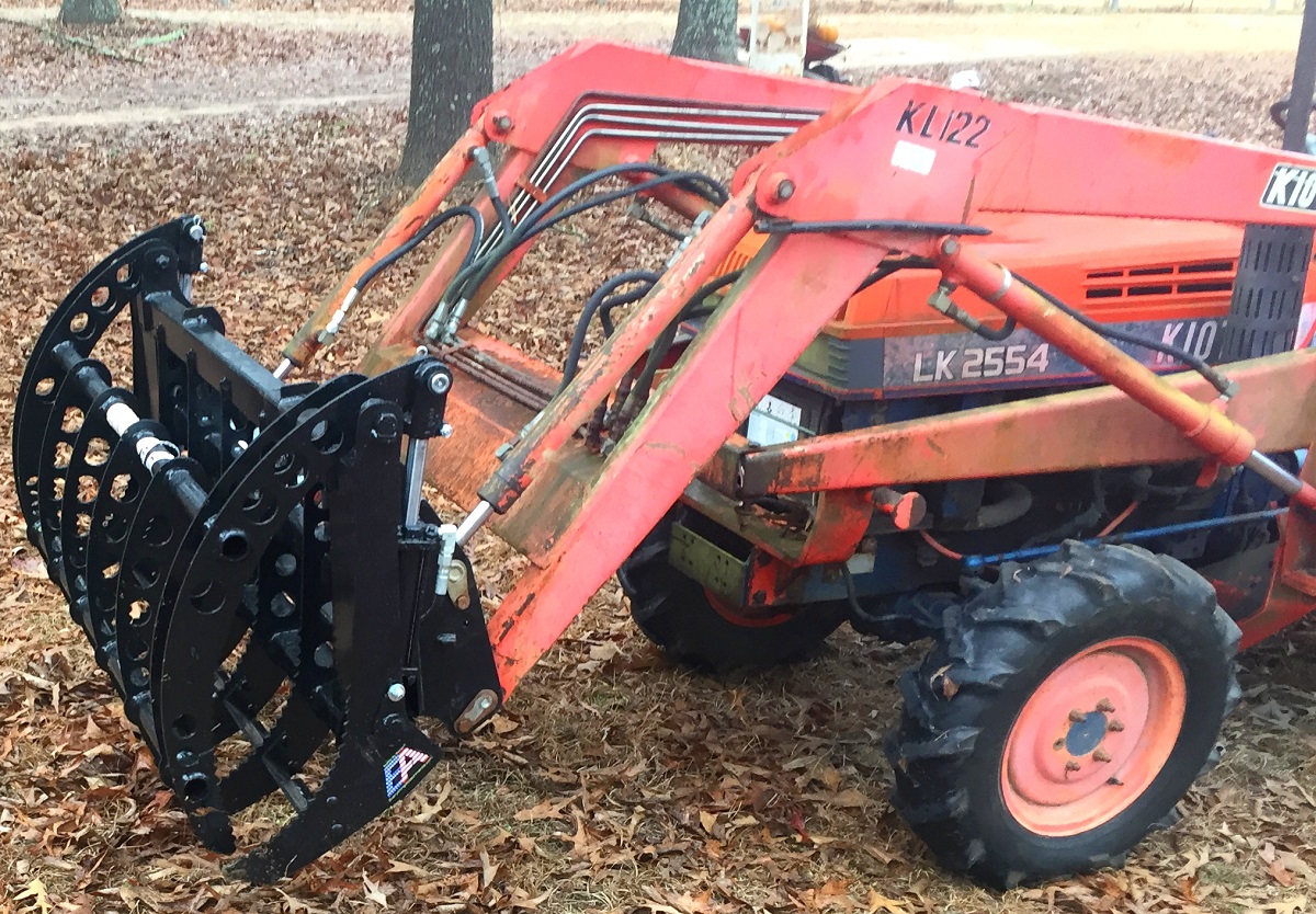

That sure is a nice looking grapple on a ugly loader!! The owner of that tractor should be ashamed! :laughing:
The adapter works great though! Takes about 15 minutes or less to install and well worth every penny!
Hey, as long as it gets the job done, right?
I love helping guys outfit older technology with new technology!! :D
Travis
   / Anyone have any experience with hayspear ssqa adapters? #8
Travis
I had to laugh when I saw that picture. That has been one of the best upgrades I did to that tractor! Looks aside, that has been and still is a great little tractor! I have the forks on it now and the grapple on the Branson. Still haven't used the new bucket but it is there when I need it.
The interesting thing is I used that Kioti to move the bucket for the Branson and the adapter is too wide and will not latch. I guess Branson's hitch is just a little narrower than standard. Fits all other attachments just fine. The Branson tractor can hook to all the other attachments as well. Strange.
Yeah, that is odd. We've found that the "standard" for universal quick attach isn't always precisely standard.
There are variances among our four Kubota "universal" quick attach mounts.
