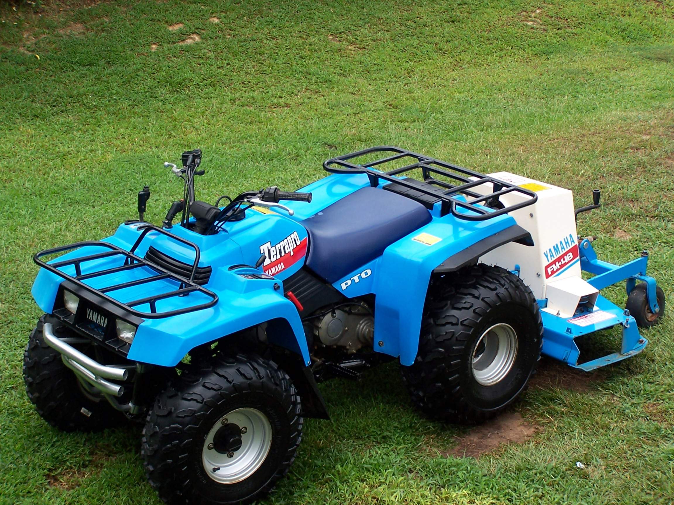

I love mine, worked great today, the drag link broke on my john deere mower, so I just used the terrapro to finish mowing. Here is a attached pic, I have taken good care of it.

That's a clean machine. Glad to see it still works 25 yrs old.
