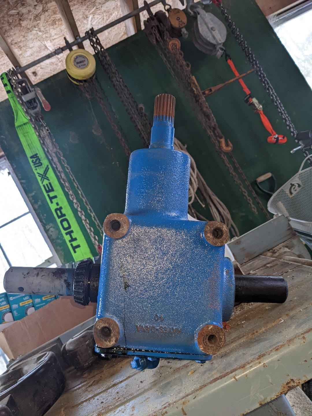

Hope I get lucky and one of the members here has one. I am trying to replace the gearbox on my new idea snow blower, and it is no longer available but I have a strong suspicion that the ih-70 and 80 gearbox is the same thing and that does appear to be available. Hoping someone can get me a few measurements on theirs so I can confirm it's the same. Thanks!

Oh yeah that would be great! I know its kinda hard to see in there with the gearbox mounted and all, but here is a picture. The first line in post #4 gives the shaft and bolt pattern dimensions, and its about 6 1/8 wide, where it bolts into the frame. I really appreciate it.

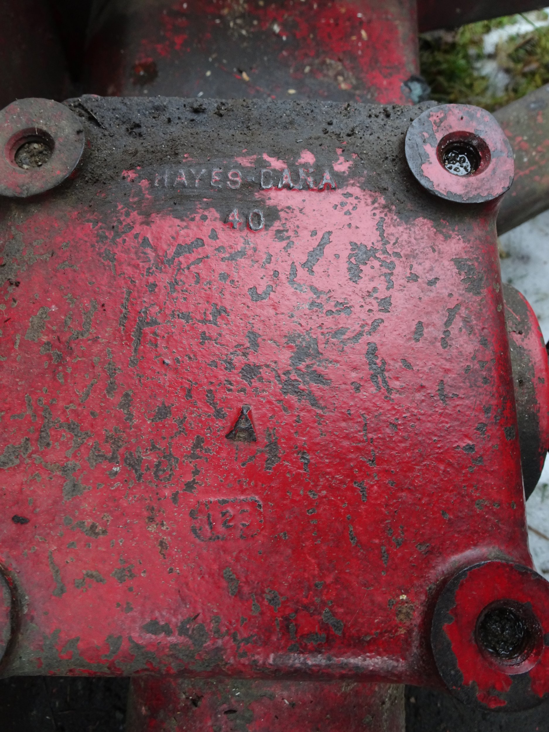

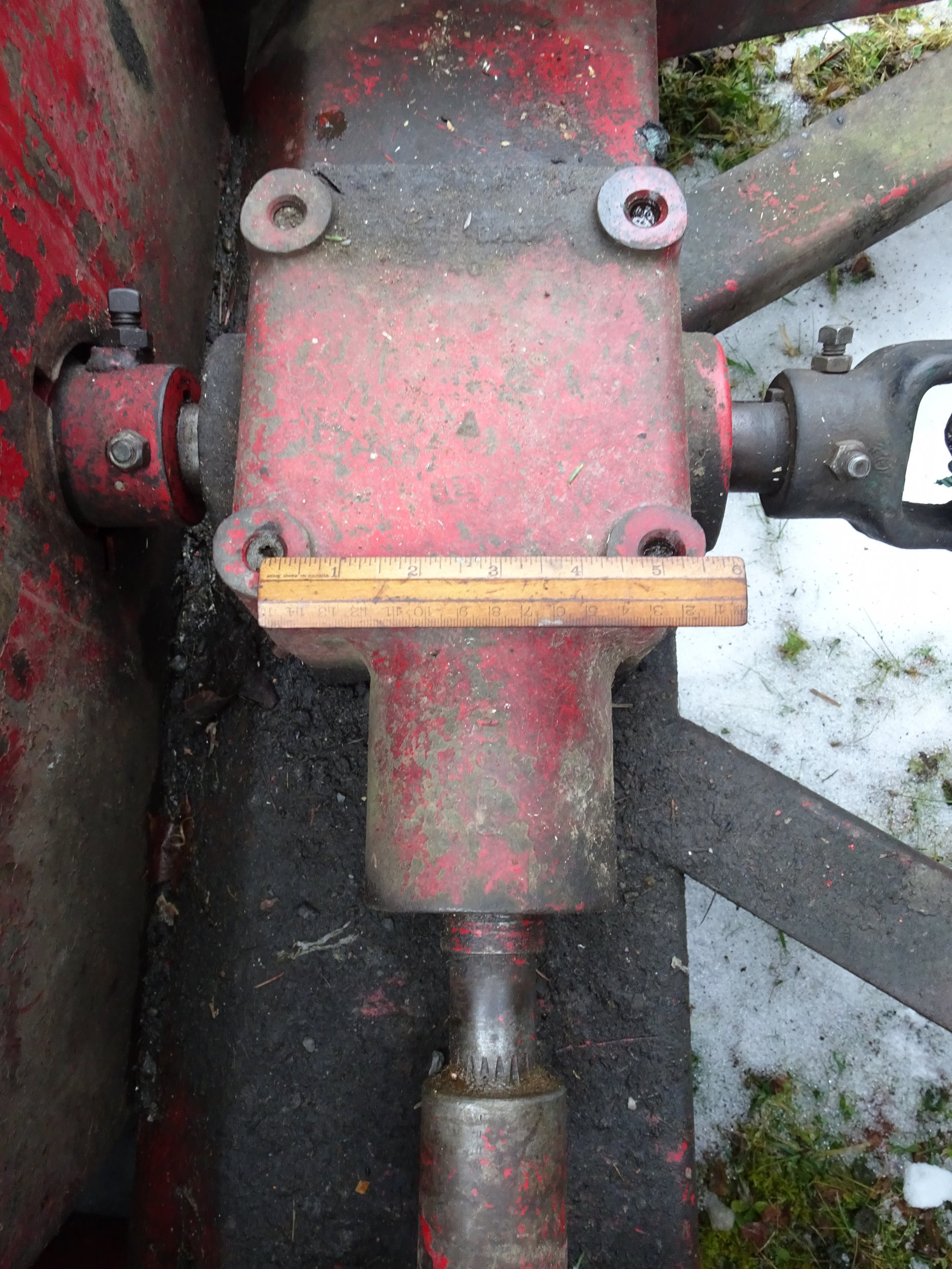

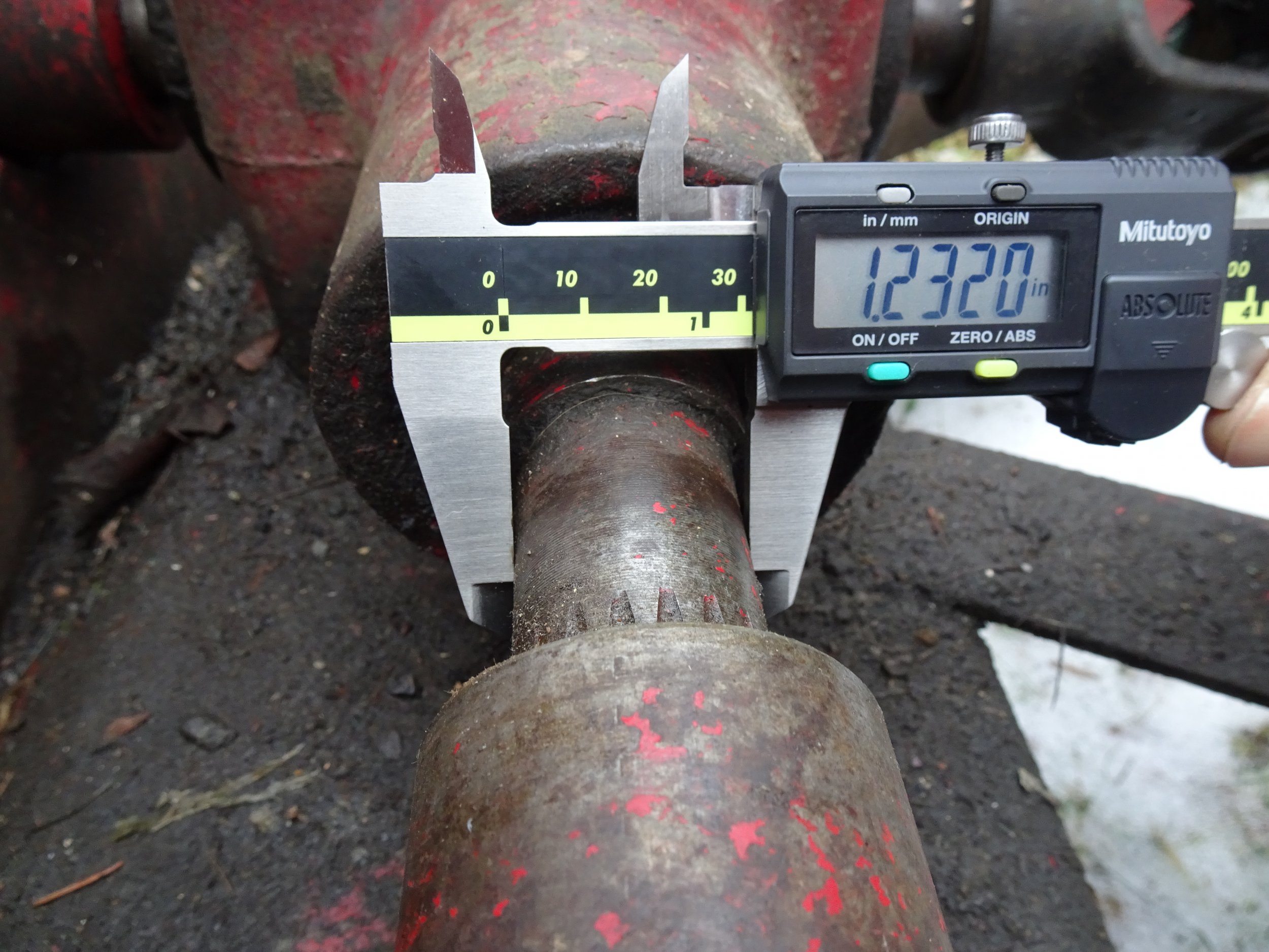

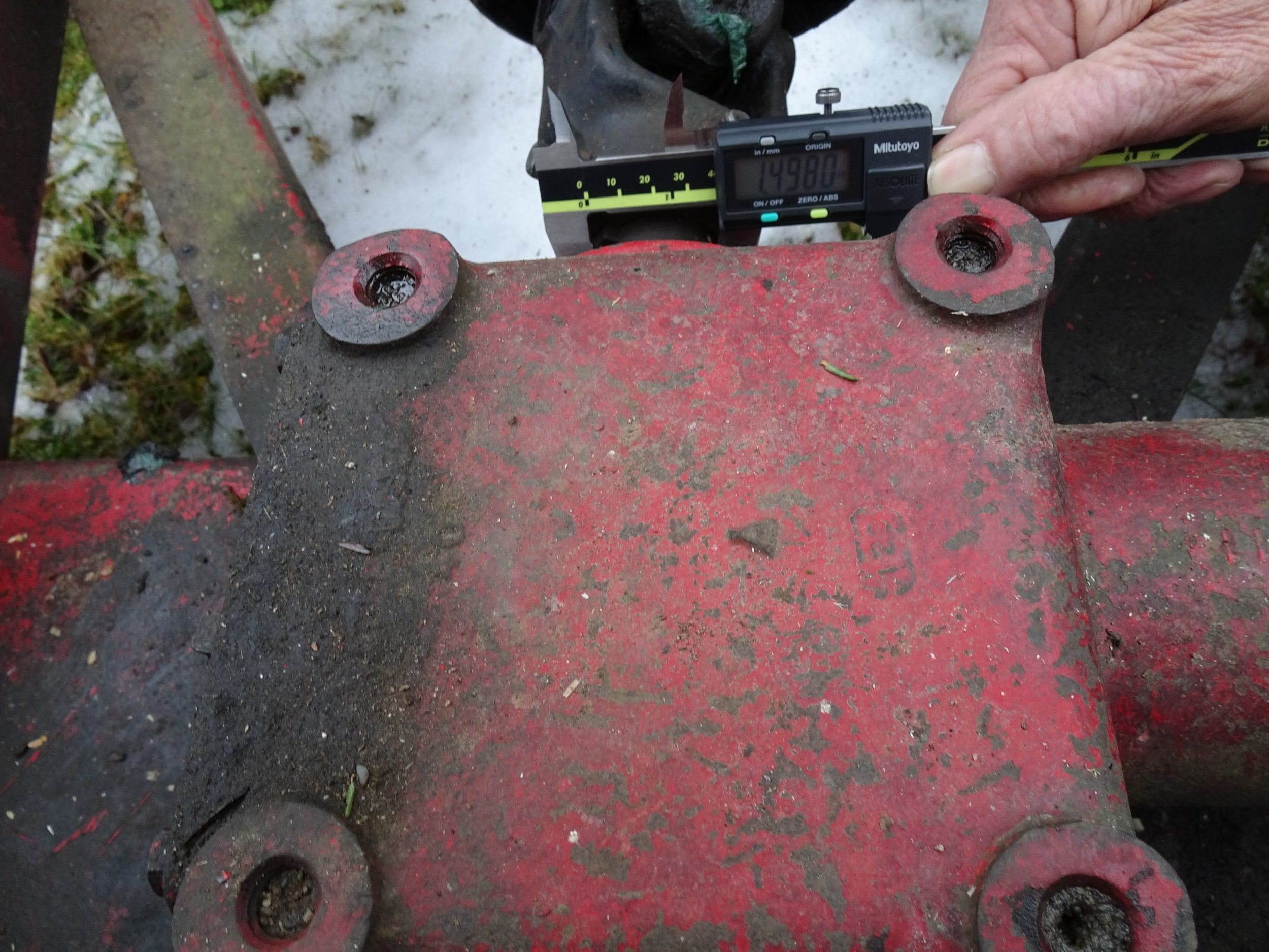

My IH 70 blower has 003840 as a serial number which seems to make it an early one. The dimensions match the box you have: Auger shaft 1.23", through shaft 1.5", square 5" bolt pattern and 19 splines on the auger shaft. It was difficult to measure accurately the height of the auger shaft above the bottom of the box but it is roughly 3 1/8". The box also has the Hayes Dana 40 cast in.

Awesome, thanks so much! Best I can tell it's the same thing. I guess I'll go ahead and order one. The $870 sure hurts though.
What happened was I decided to have it sandblasted and painted. Turns out this place powder coated it gearbox and everything, cooked the seals of course. Great, now I have to rebuild the gearbox. Had such a hard time getting the impeller off the gearbox shaft ended up cracking the gearbox housing in the process.
