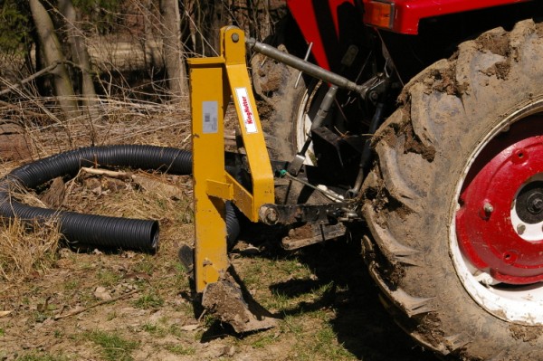

/ Anyone have a Howse Middle Buster? #7
I dug some ditches last week with mine..

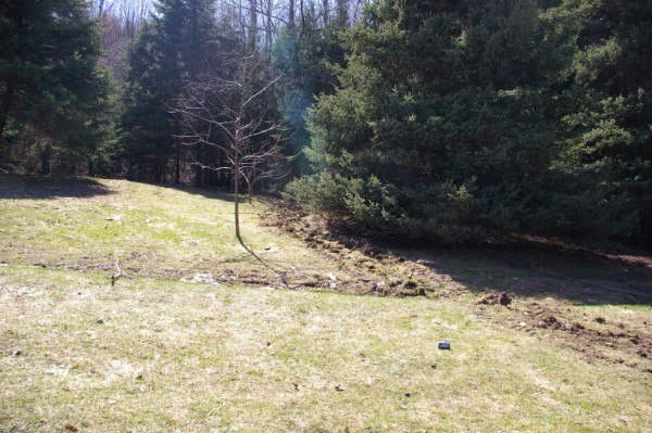

/ Anyone have a Howse Middle Buster? #8
Another
/ Anyone have a Howse Middle Buster? #9
Last year I put in 4" corrugated drain and it dug deep enough to give me a slight pitch. I go slow on the first pass then I go over the same ditch at about twice the speed to really clear the dirt to the sides of the blade. I'm happy with it.
/ Anyone have a Howse Middle Buster? #10
Depends on depth and type of soil. I can get to a depth of about 12", but need to go over the trench 2-3 times in my soil to get most (but not all - takes shovel work also) of the dirt out - softer dirt, and sandy soil, tends to fall back into the trench. As to width - the plow is pointed, but by angling the tip forward, you can get a flatter bottom to the trench - say 6" (I have NOT measured such, but have laid 2" pipe with lots of room to spare).
