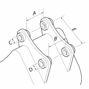

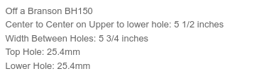

My backhoe is an older Branson/Kukje 7620 made byAmeriquip. Here are some measurements for your BH150.
Thanks for that - I'll go measure my BH76 bucket after work today.

I've verified the 1" pins (C&D) and 5 3/4" between holes (between wings) on the upper connection (A).
I'll have to hook up hydraulics as my backhoe isn't on the tractor and the back of my bucket is solidly in gravel so I can't measure (B) and (E); (E) is very likely also 5 3/4" as the wings are parallel.
My guess is that that's a match but will determine more later.
