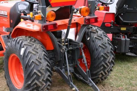

I have seen those bar-turf and they are a super flotation tire and think they are meant for wet lawns and such. They seemed pretty lightweight and fragile in that you could tear them up with ag work, rocks or in the woods. Check that aspect out first but then stay with R1's. Especially in the woods.
They do make an eight-ply version. As I finish with the gross work of forming my four acre homestead, I'll likely need to switch to something somewhat less damaging.

What is a bar turf to you? Bar-turf is not a standard, understandable tire term.
Why do you wish to replace your R1/ag tires, sometimes termed 'bar' tires?
Here is a link to kubota option video of bar/turfs op is referring....when narrator goes to B series the bar/turf is shown. A friends old Kubota B1550 has them that I have used. I did see them a couple times in past Kubota whole goods lists as a seldom seen 4th tire option on some models.
Kubota Tire Choices: Why it Matters - YouTube
If link doesn't work, just google Kubota bar turf and see the Messick's YouTube video on Kubota tire choices.

I'd get them in a heart beat. Main reason is that if you need more traction, just slap on a set of chains. The logging outfit I once worked for had 3 skidders. One of them had ags so worn, they stuck up about a half an inch. Here , chains were the great equalizer. That skidder pulled hard with chains on a set of well worn tires.

The more I info. I 'dig' up and/ or see, [pun intended] the more I think a new set of R1s for that particular tractor is best. The xtra-tracs sure look cool though. Perhaps I will try a set on one of my other more multi-use tractors in the future.
If I was doing lawn-duty only (and maybe nothing more demanding than top-dressing an already built and leveled driveway), then I'd be considering those Goodyear Xtracs.
W/O even talking woods work, I've seen to much "stuff" go on in just wet fields to want anything but R1s.
I like chains; they can help a lot, but not if they are in storage.
