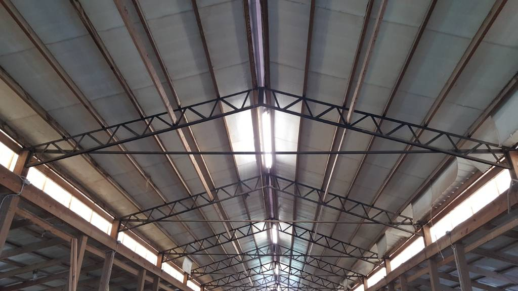

Here' a pic of our 48x108 horse barn. Center aisle is 24' wide. 16' wide will likely not have the full width tension member. Truss design has evolved. Latest designs have a 2x depth drop at center and just bolt together. This barn is 22 yrs old.
