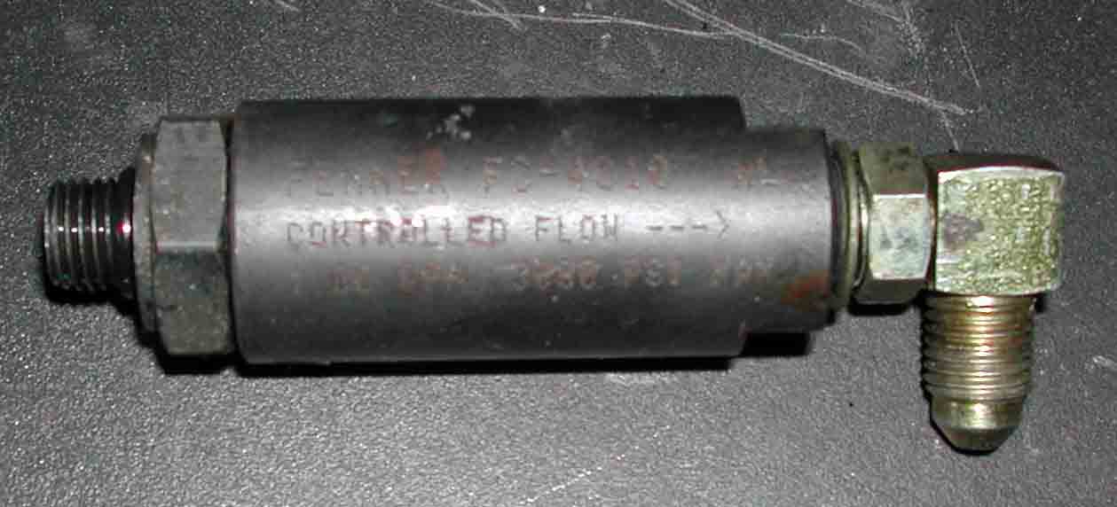

...is there any way to speed up the lowering speed? It is slow as all getout.
Look to see if there is a flow-limiter in the return path. On my Genie
Lift, there is a 1GPM piston-type flow limiter. Also look for a flow
restrictor that uses a small orifice, which can be enlarged.
I also have a TommyLift power-pack, but it is all mechanical, while the
Genie's uses solenoid valves. Both units are made by Fenner.

It makes sense that if you have adjustable flow restrictors, they are on
the valve body. I did not see any for my TommyLift power pack. On my
Genie, it was a separate valve attached to one of the ports on the cylinder.
On JD loaders I have had, they are fittings attached between the loader
cylinder and one of their hoses. Assembled, you could not tell what they
were. Here is my Genie restrictor.
