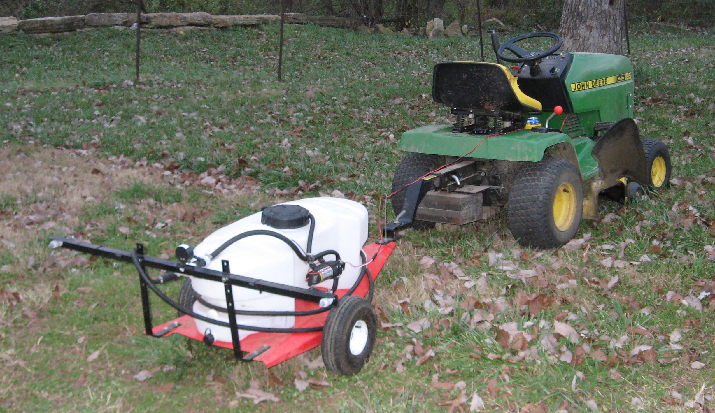

Also, if you leave it outside over the winter (or in an unheated space) DON'T forget to run some RV antifreeze through the entire system, including the wand and the sprayer nozzles.
If you don't, they will freeze and break and you'll be buying new ones. I ran it through the sprayer nozzles, but forgot to run it through the wand and had to buy one this year (not a big deal, $14 or so, but still....).
Also, on the one I have (which is not exactly like that one, but similar) the power wire was not long enough and kept getting caught under the trailer tire when I turned corners. So, I bought a 1 foot extension from Autozone that plugged right in, and made up a standoff for the wire. Problem solved.
Mine is a Fimco, the County Line models may not have the same issues, but you will still need to winterize it.
