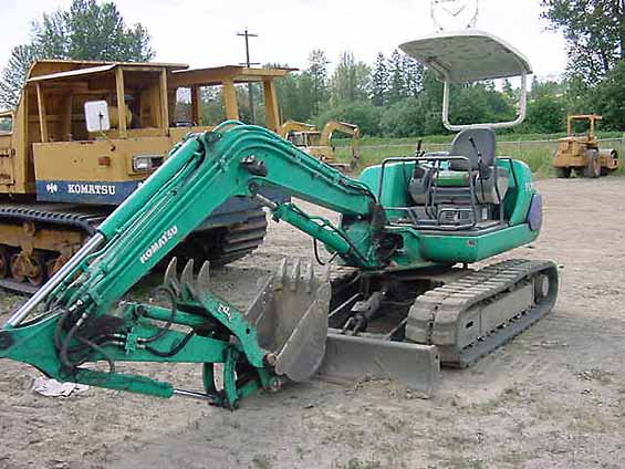

I've recently figured out what a "pc 40-7" is, it's komatsu's min excavator. I found this nice looking machine on the net. Has anyone ever used one of these guys? It looks like a nice machine, the right type of thumb and everything.

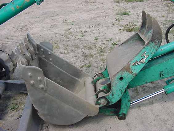

Close up of the thumb.

I used a Kumatsu mini around that size for a few hours one time. But the one I ran had a full cab. I don't remember the model #.
Very nice little machine. The model I used was similar in size weight and controls of a 101 Kubota.
   / anyone ever used this guy? #4
A local guy has one. I dunno much about it really. Seems to be a nice size. Not too big, not too small. Komatsu has a good reputation for reliablity.

Blake that Komatsu is a good little machine, before the economy went down the toilet here i was about to buy one. I had my heart set on a PC50UU that weighed in at 11000 pounds. It had straight linked controls and a zero tail swing to. Then i looks at a PC40-6 it had a large tail swing and looked more like a 1small PC60. the PC40-7 you have in the picture has pilot contraols with lowpressure hydraulic valve actuators. I use one a freind of mine owns when he wants me to run a job. I dont like the thumbes that stay on the machine all the time because they take away from the weigt we can hang over the side plus there a certain percentage of inefficiency gained with it. They are nice though. ish bucket has and extra pin hole in it to take a thum that follws the bucket takes 4 minutes to install the thumb. I used his 40 this morning to dig a grave at the cemetary and clean out there ditches.
Im using a 27Deere on a job for my uncle putting in a retaining wall on the lake, and i have to dig a road out on a bluff then go put an adapter i made to put a Bobcat auger on the bucket so i can reach where the post holes need to be. THis summer im trying to save the pennies up to get a mini excavator and a little dozer. THe guy at the trental store said the little loader had more uses and was better at the auger but the hoe can reach nearly 12 feet and 5 can reachway up on a bank.

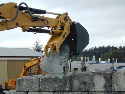

Anyway.... attached is a picture of the companies thumb on a cat 302.5, this machine is also in the same city, I've been to this place a couple of times, called Alpine Rockeries.
