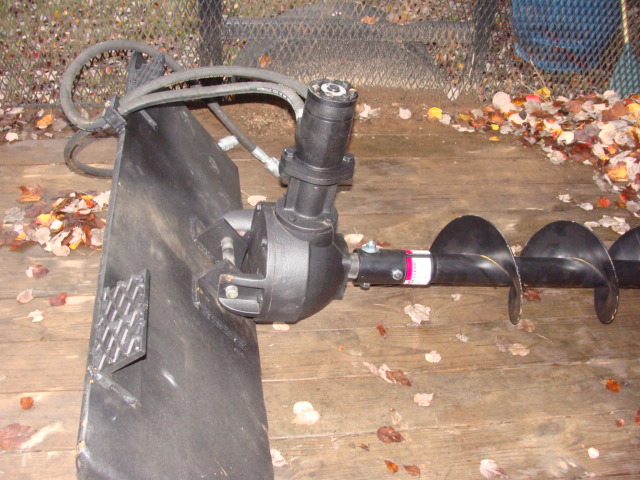

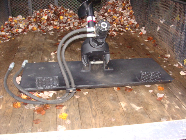

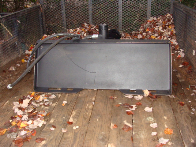

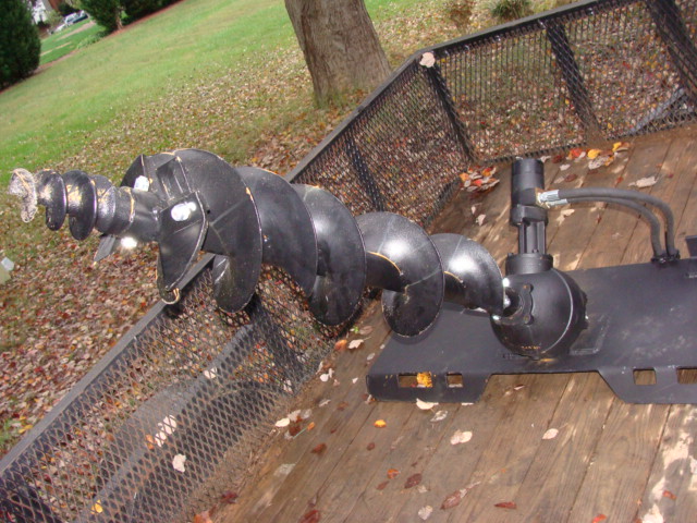

   / Anyone ever build an auger? #10
I didn't build the actual auger, but I did gather/build/install the rest of the assembly for a skid steer mounted auger. The auger itself is 9" with replaceable knives and spiral tip. It cost less than $150, which I think is a good deal. I wouldn't attempt to build one. The gearbox is a 58 horsepower, 3.14 ratio Omni brand with a Chief Hyd. motor with max. torque of 3026 in/lbs and up to 20gpm with a max. 2400psi. The final rpms at max. pressure/flow will be around 117 which, in retrospect may be too much; or maybe it will bore really fast! I sold my skid steer before I finished it so it has yet to be tested. Anyone want to try it out? :)
