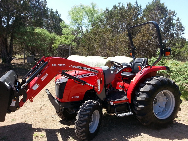

You were right TSO, everything did work out ok. First off, the o-ring thing could have happened to any make of tractor. My dealer, Dietz Tractor Co. in Seguin Texas is a pretty **** good dealer. They got back with me within a day when they got information about the error codes from the engineers at the factory. The first error code 002041 that wasn't listed in the manual was caused by a glitch in the kill switch for when the operator leaves the seat when the tractor is in gear. Apparently when I hit the bump it caused me to leave the seat for a split second and killed the engine. The engineers are working on a fix for the hydro models so that doesn't happen. The other error code 003936 is compliments of our tier 4 switchover. It has to do with the engine being new and not enough build up in the filter yet. I was told the code should go away in another 10 hours. The phone call from the mechanic on Friday afternoon made me feel a whole **** of a lot better. I gave it a good workout all weekend and enjoyed every minute of it.
   / Anyone Else Own a 2014 1736? #4
Glad it worked it out! That's a fine-looking tractor. You're right, the issues are minor and could happen with any brand of tractor.
